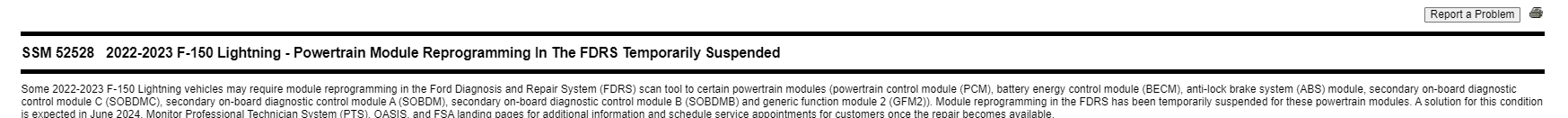

There are certain powertain module updates that are currently on hold and should be avoided. They seem to have been pulled from FDRS, but if by chance you show an update pending for any of the modules listed below, do not do it.
Ford F-150 Lightning Lightning Software Updates using FDRS 1715956307804-z5

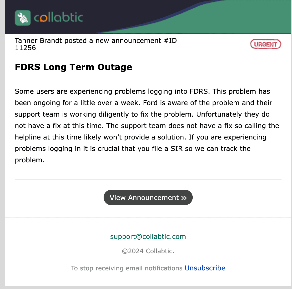

@rugedraw @jlcreasy As an FYI, this message from NASTF community just posted. It appears the NASTF login prompt in FDRS when BCM update is rung remains an issue as of today, Friday at 12 PM EST.
The way this is worded, it seems like it is a general login problem to FDRS and does not refer to the BCM issue in particular. As far as the BCM issue goes, I think dealer logins to FDRS may be able to do the BCM update because with a dealer login, you have access to PATS and are able to program key fobs, so no separate password is needed, but it is just a theory.

Hi just wondering if there was any update on this issue with FDRS. I Looked and didn't find if any updates had been made so was just checking. Thanks.
Yeah it's been up and running without issues for about two weeks now. Still using 40.4.5
The issue was on the server backend, not the software. And it was only for Independents, not Ford employee logins.

With all the word of the FDRS outage is that something I should wait on or if there is an outage will my access money just be wasted.? I would hate to pay and not get access for my updates. Any recommendations before I proceed..?
I do not have personal evidence that the issue is resolved. Although the post I found on the NASTF forum has been updated to indicate that the issue was resolved by Ford.
Nevertheless, in my experience, it was only the BCM update that prompted for NASTF login process that was failing. I was able to update a handful of other modules during that same period.
Seems others are experiencing success.
