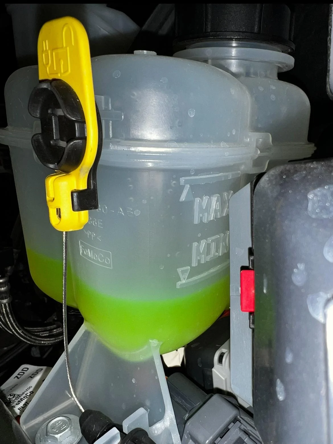

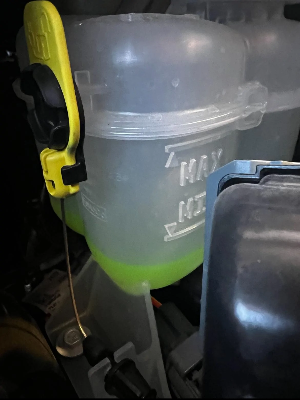

The coolant level on the truck has dropped over the first 400 miles. It was below the Min level on day 2, now 400 miles level it is far lower. Truck is parked inside on a clean floor, no signs of a leak.
I’ll call my dealer tomorrow. Any thoughts on what the dealer would do and risk of taking it down the road over Christmas for a long journey?

Assuming brand new truck with ~400 miles, it might just be trapped air in the system the factory didn't purge during assembly. Hopefully it stops, you might want the dealer to top it up and document, then observe / carry some spare coolant.

Happened to me after my battery module got replaced. Had to top it off after each trip a handful of times before it stabilized. I assumed there was air in the system after the module replacement.

A hair above the MIN when cold is best and how all our trucks arrived from the factory.
Sticking this thread for easy observation along with an older one, most folks will notice a slight drop, mine too, after topping it up, mine hasn't changed.

Thanks for the feedback! I will make sure the level is a bit above the Min line before I take off on this road trip.

I had the same issue when my truck was new. It stabilized after being refilled twice. Dealer suspected an air pocket from the factory sine they could find no leaks.

I suggest checking the coolant level frequently after an HV battery module replacement. The dealer EV Tech said he purged mine 4 times before all air was "removed". I checked the coolant level a week or so after receiving my truck back from the two module replacements, and the coolant level was at the bottom of the expansion / fill tank. I have topped it off twice since then.

Seriously I experienced the same low coolant level when I got my truck. Topped off at the dealer about 2k miles ago (no charge). No change in level now. I agree that system bubbles can require multiple top offs.

Large cooling loops, air in the system and temperature changes.
Keep it at low when stone cold.

Had it going to the dealership anyway so they looked at it and topped it up all the way to the max level! Guess I’m good if there’s more air in the system!

The dealer should do a pressure test on the cooling system and check for an acceptable drop in pressure and/or a leak. Mine was that same way, no coolant in the recovery reservoir.
