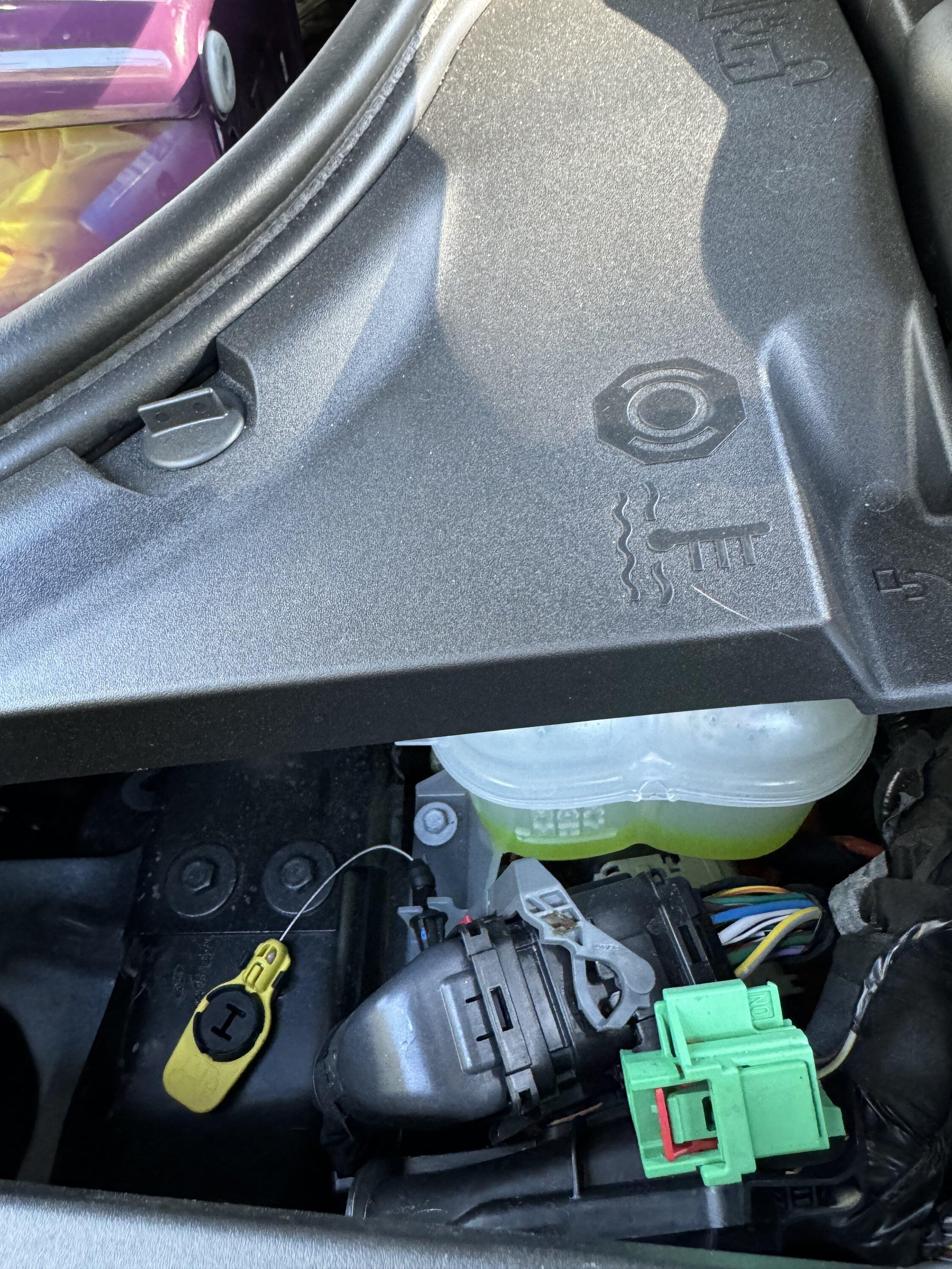

There is, however, one big trap that bit me last week and I'm glad that I read this forum to know about the solution. Not charging is one thing, holding my car hostage is a while different kettle of fish. The Electrify America charger in Eugene, OR 'hung' when it was attempting to authorize my truck. The rings turned red and I tried to cancel, but no matter what button I hit the charger stayed locked to the truck! (EA is terrible, this scenario should be impossible.) Of course I did it on the first ride I had taken my 90-year-old Mother on with the truck (my wife thought it was a good idea to show her how easy it was to charge an EV!)
Fortunately I had read the forum and knew that in the frunk was a charge release cable. It is in the front trunk, on the right side near the coolent overflow bottle. There is a nice lable with a lock to give you a hint.
Here it is:
Ford F-150 Lightning Most important Lightning secret: how to release a stuck charger cable IMG_4330
Simply gently pull the yellow tab that is attached to the cable.
This should release the lock so you can remove the charging cable. It might help to ritually curse Electrify America first. It worked quite easily, it took no force.
The one thing that I don't know is how to re-attach the yellow tab to whatever it was attached to.
Anyway, I hope that this helps

Here are a couple of pics with the release cable attached to the coolant bottle.
@Newton
Ford F-150 Lightning Most important Lightning secret: how to release a stuck charger cable IMG_2571
Ford F-150 Lightning Most important Lightning secret: how to release a stuck charger cable IMG_2570
In my case, it just snapped back onto the clip when I used it. Reattaching was pretty straightforward. It took a bit of a wiggle.
I also was glad I read a post on this forum on this before I needed it. ;)

Ah, that is where it goes. Thanks! I was a little stressed when I pulled it out.

Thanks for posting this thread...I read it day or two after it started and it was front of mind as I had a bit of an issue Sunday with a magic dock Tesla Charger at the new Buckees in Colorado. Would not let go so I used the release, moved to a new stall and then charged.

I had this happen, and then a few days later I saw a CSP was attached to my truck regarding reprogramming "Charge cord stuck reprogram" Campaign# 23B50. I'll be having my dealer look into it when i take it in for the 10k service.
