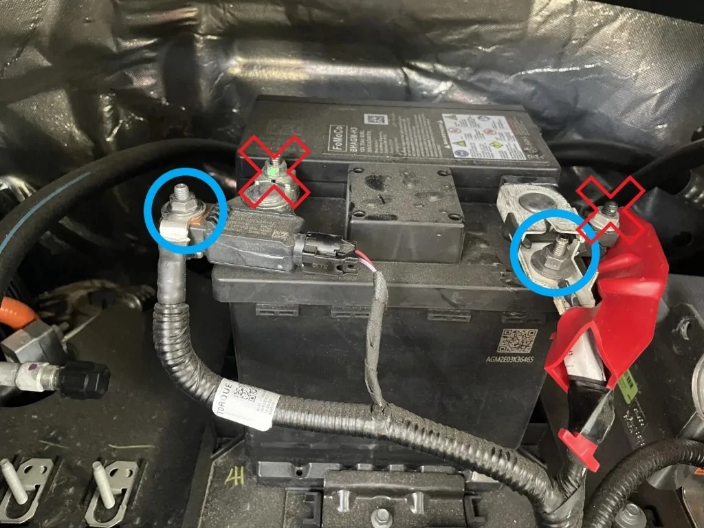

I have just skimmed this thread. Is the discussion for a BMS for the HVB? The BMS for the 12V LVB is part of the negative terminal cable and is located just before the attachment point to the negative terminal of the LVB.
The 12V BMS is to the right of the blue circle on the left in the picture below from @bmwhitetx's great post: https://www.f150lightningforum.com/forum/threads/charging-12v-battery.16979/#post-342220

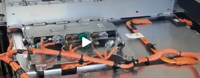

According to Google Search, the BMS for the HVB is located at the front of the HVB battery pack:
The Battery Management System (BMS) for the high-voltage battery (HVB) in the 2022 Ford F-150 Lightning is located at the front of the battery pack housing. This unit is integrated into the pack, which is situated underneath the truck between the wheels. [1, 2]
See starting about 2'48" into Munro video (link#1 in quote just above): . Earlier in the video, the connector seals at the front end of the pack are discussed as suboptimal, which may be relevant to your problem, @Nomoregas.
Only the connector port is at the front exterior, while the actual BMS modules is inside.
