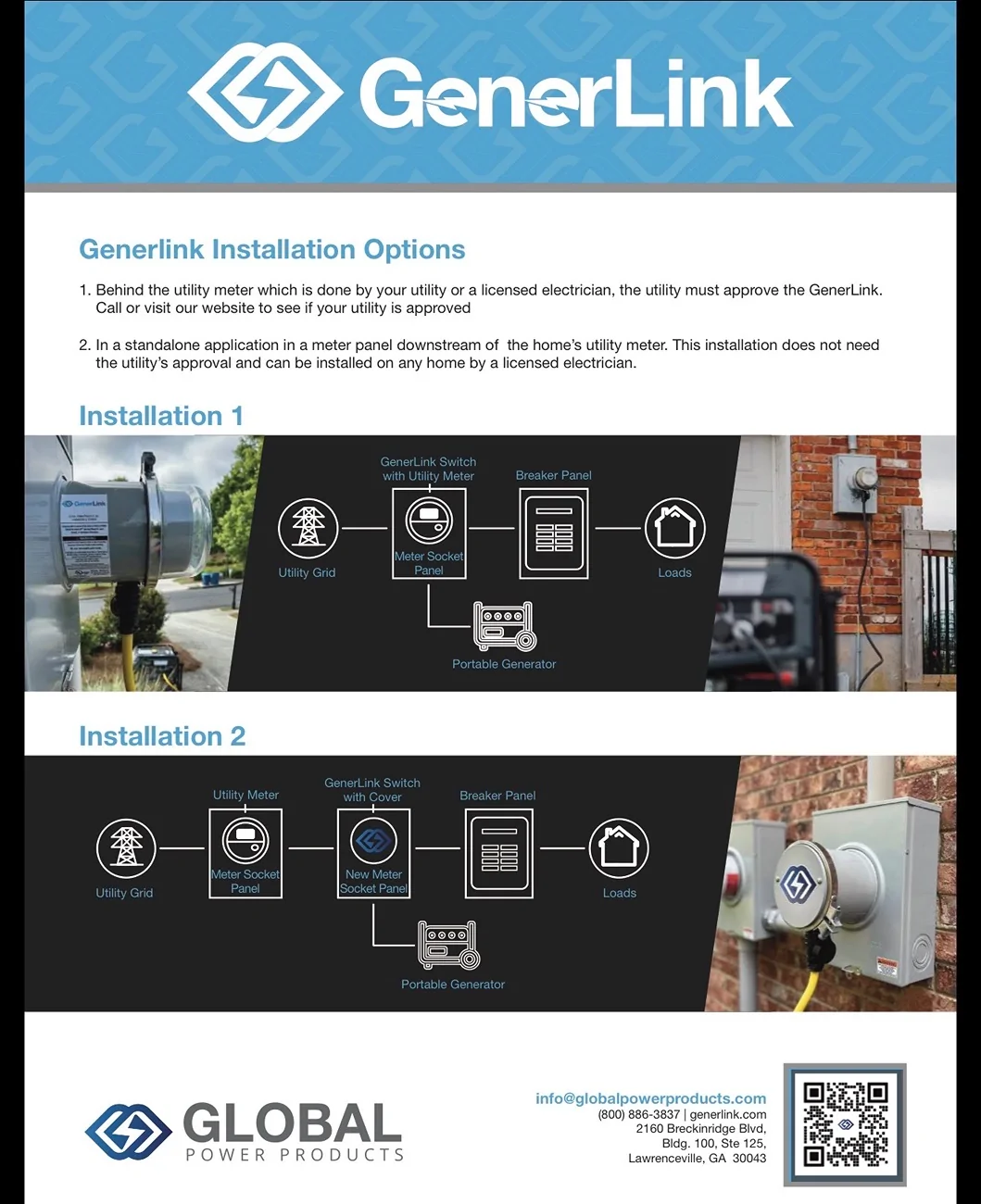

The hardware bundle is $1,100. If your utility company approves the transfer switch installation right on your meter, then anticipated installation ranges between $250-$450. For those that have a utility that does not approve of on-meter installation, there is a next to meter solution, where the installation costs are increased with anticipated ranges between $1,000 to $1,500.

@Ford Motor Company, thanks for the update.
I request that Ford and Global Power Products work with the electric utilities to address and resolve any concerns they have to allow the on-meter installation.
Cobb EMC, my utility in Georgia, does not approve the on-meter installation. They can't provide me with a reason other than a concern for reliability and maintenance. The next-to-meter installation almost doubles the total cost over the on-meter installation. Adoption and use of the product will obviously increase significantly with approval of the on-meter installation.

Don’t feel bad. Duke energy of course don’t even offer it. Sorry bastards I’m in NC
