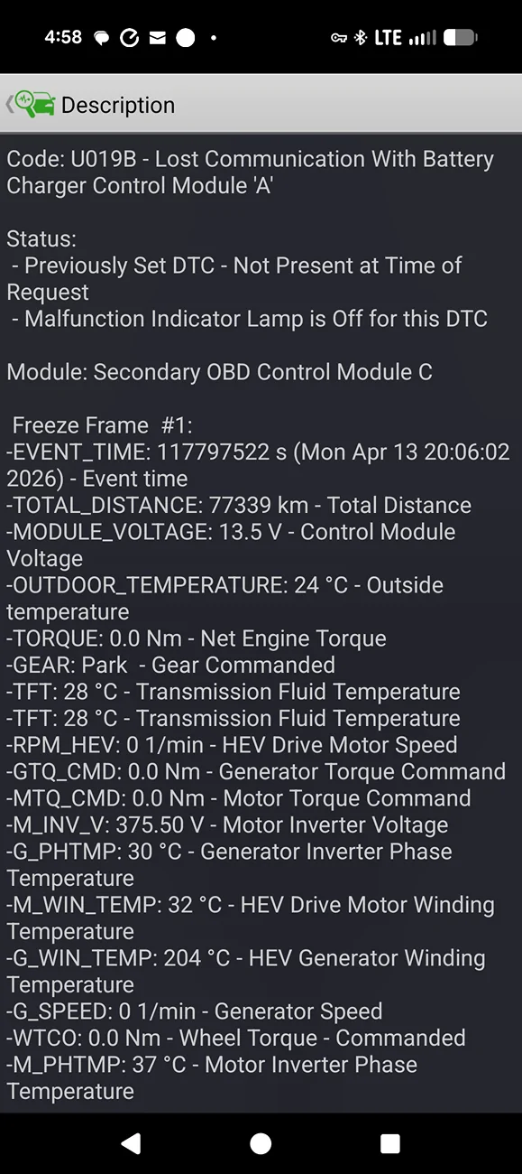

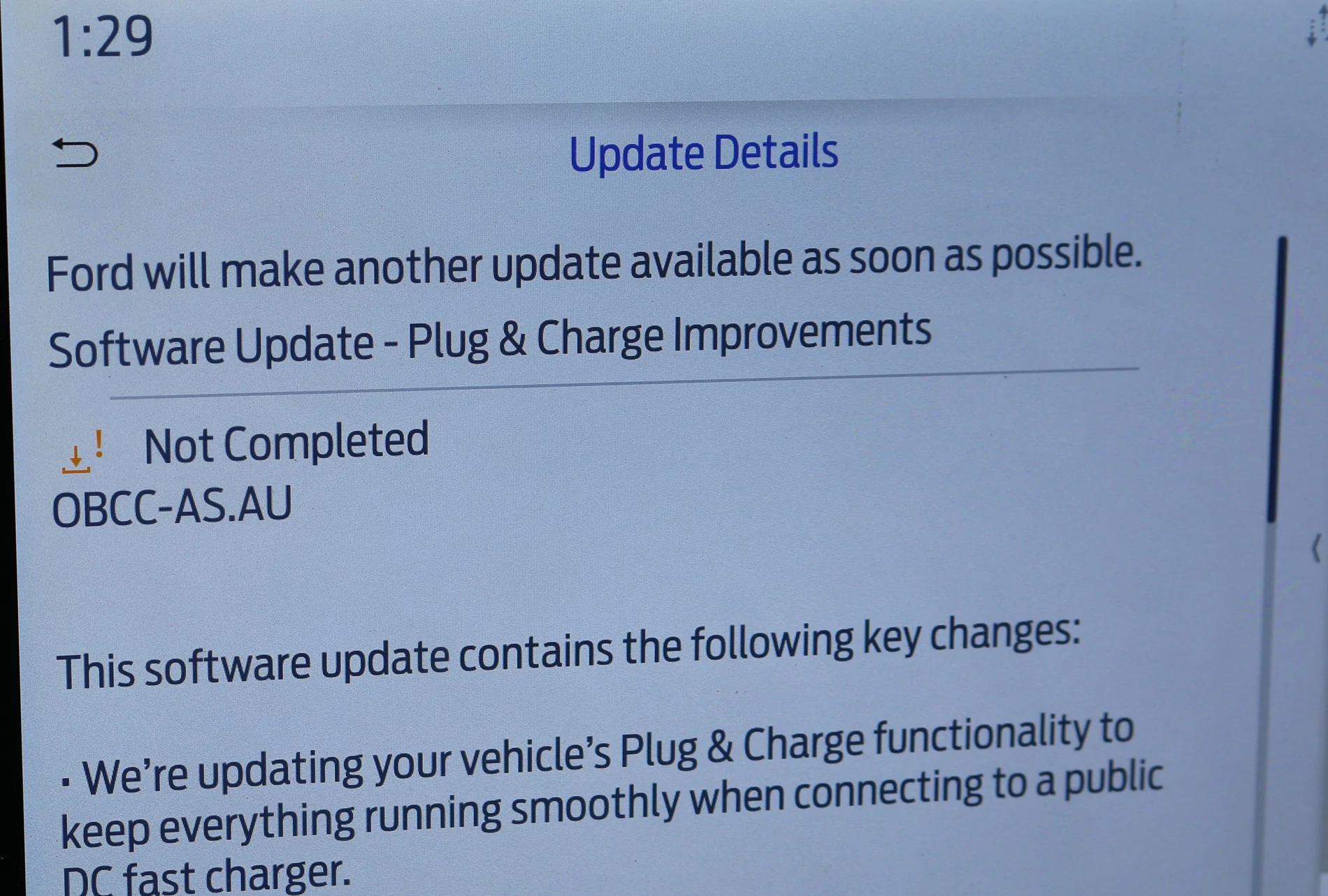

I got this one on Monday night. No apparent issues but when I was checking my codes I pulled up a U019B:00 code that occured at 20:06 which would have been 6 min after the update started.
Ford F-150 Lightning OBCC-AS.AU OTA 1000003669
