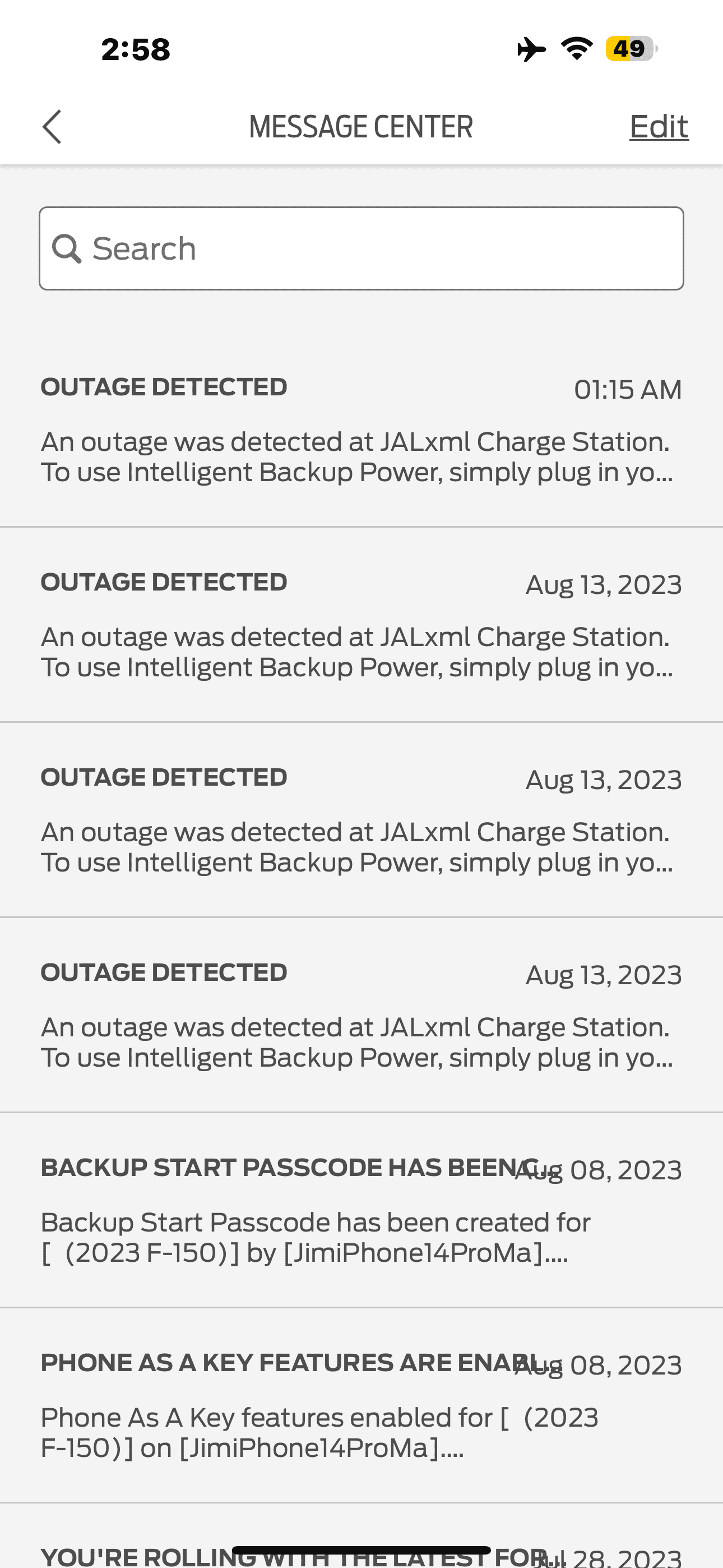

After trying to cure the FordPass CONNECTION LOST by powering down and rebooting my FCSP and HIS backup system, I have started to receive multiple alerts via the FordPass app of an "Outage Detected." The only problem is that there has been no power outage at the times around each of these alerts judging by no notice from our utility, no loss of time on our microwaves, no flickering of lights or crashing of computer, etc.
Ford F-150 Lightning Outage Detected - Backup Power Unavailable IMG_0628.PNG
Each of the above alerts was for a separate time of day, at which time no outage occurred.

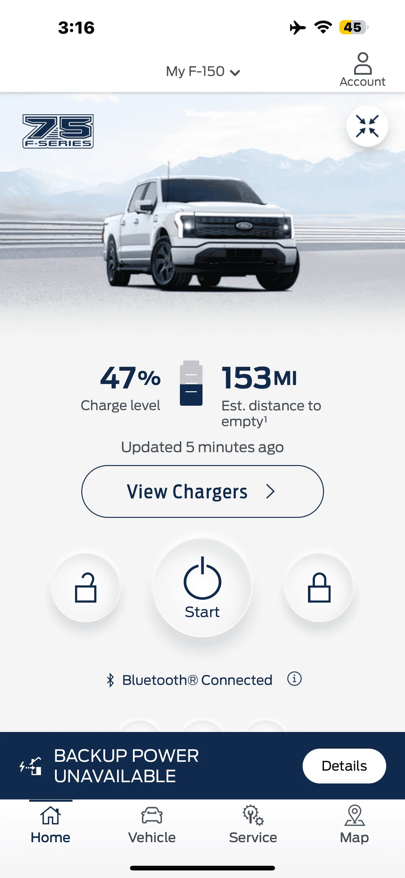

Worse than the annoying outage alerts, the main load screen of the FordPass app shows a BACKUP POWER UNAVAILABLE message and will no longer show anything about a scheduled charging, a charging in progress, or the completion of charging (charging still occurs, according to my schedule and limits, it shows as a changing SOC percentage in the app, and I get an alert in the Message Center when it's complete).

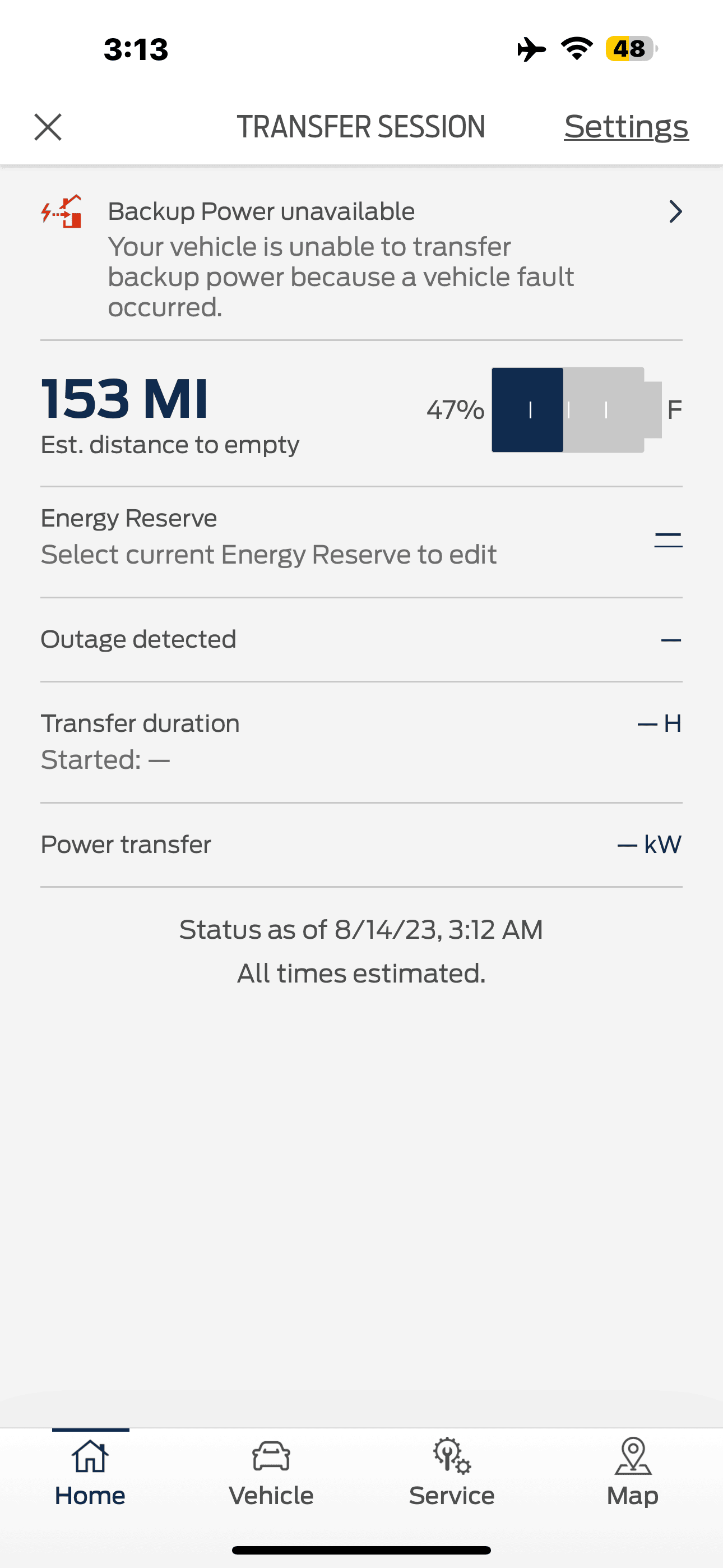

When one clicks on the DETAILS button in the Backup Power Unavailable notice, one gets the following screen. Another weird screen, the backup Transfer Log says I've never initiated a transfer, which is not true as I had two successful transfers back in mid-June! So somewhere in either updating the FordPass app or rebooting my FCSP and HIS unit, any info about prior transfers was lost (or never recorded to begin with).

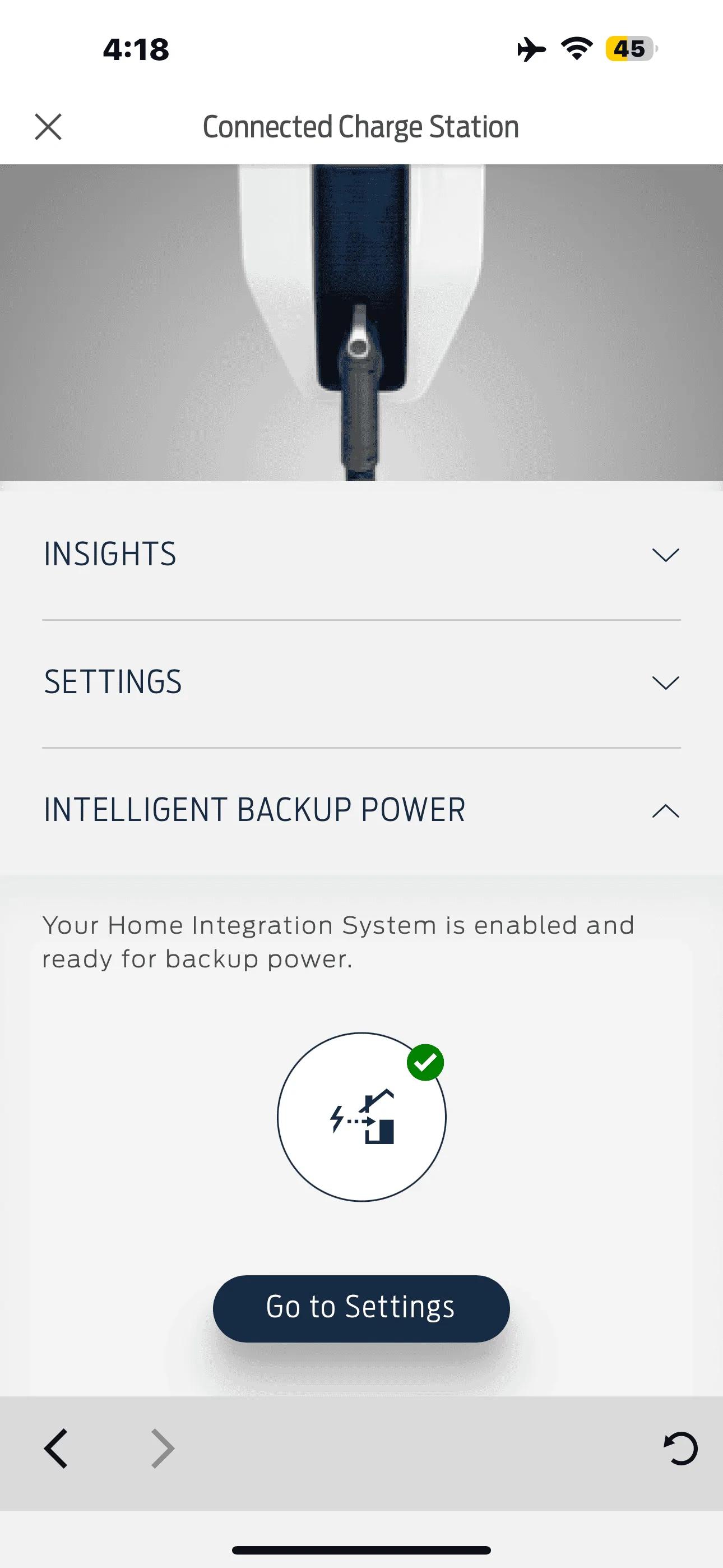

The final truly weird thing is if I go to Account, Charge Station, Intelligent Backup Power in the FordPass app, I get the following screen announcing Intelligent Backup is set up and working for my truck. I no longer find the circled steps 1, 2, 3 with 1 and 3 checked and filled with green and 2 unchecked and filled with blue anywhere in the FordPass app.

Initially, after getting the Backup Power Unavailable alert, the FordPass app was pretty unresponsive. I had a lot of trouble accessing my Preferred Charge Settings. Now the app is a bit more responsive, but as noted above, the Backup Power Unavailable notice dominates the Home screen and prevents any notices about the charging schedule or progress from appearing. The Charging Station screen still reports my vehicle is charging even when it's not and even when it's not plugged into my FCSP.

Could it be, that the HIS system is fine, but there is an issue on the truck?
This snapshot leads me to think the truck is the issue "....a vehicle fault occurred"

Update on OUTAGE DETECTED - BACKUP POWER UNAVAILABLE: Last night all the OUTAGE DETECTED alerts but no other alert messages disappeared from my FordPass app, i.e., the ones depicted in the first image of my OP post in this thread (reproduced below):
Ford F-150 Lightning Outage Detected - Backup Power Unavailable 1692151643091
The outage messages were generated via a Ford server. My interpretation now is that the messages were bogus, and someone at Ford realized the system malfunctioned and deleted the false alerts (I certainly didn't delete the alerts, and we had no outages at home).
