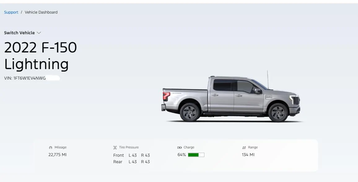

The tire pressure can drop several PSI with the cold season, all four dropping is a sign of environmental change.
Yes, they and the owner can see it from the vehicle online profile.
https://www.ford.com/support/vehicle-dashboard/
Ford F-150 Lightning Parking brake fail? Wet, not icy surface 1740083451787-3s
Yes, we had snow early Sunday to midday when the temps were upper 30s (38, 39) and rain turned to light rain at the time of the incident. No tire lights were on for the short trip I made Sunday afternoon. Probably never really know what happened and just replacing everything that could have contributed.
