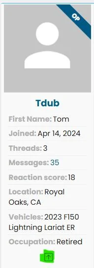

General reminder to folks, useful information can be found by clicking the little arrow under the users handle
