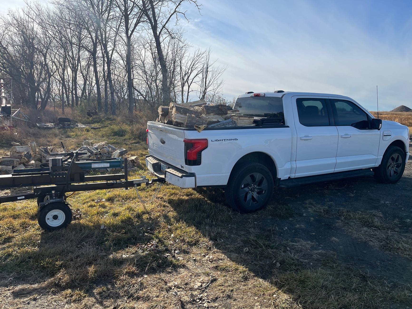

Pic - getting ready for ND winter. And park brake annoyance

Nice looking truck and photo! Seems like a good one for the "Doing Truck Things" thread. Did you weigh that load?

Is there a doing truck things thread? I guess I haven’t noticed one yet. No idea on the weight but my old F150 would’ve been squatted to the rubber stops. I’m in agreement with you on the parking brake. Somethings are best left mechanical instead of electric.
