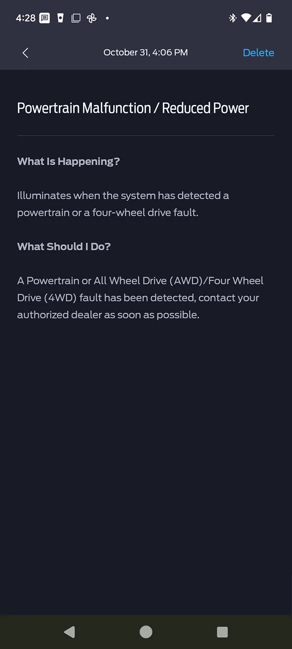

Dropped our 2023 XLT off @ dealership this morning for P0B24 that appeared on 10/24.
- Charge fault error message when it got to 65% (target 80%)
- 57% battery available on instrument cluster
- Service vehicle soon / wrench warning light on instrument cluster
- Solid red ring next to charging port when connected to CSP level 2 charger
- Powertrain Malfunction / Reduced Power message

Looks like I have a similar issue. 2023 XLT, yesterday got a charge fault error while plugged into my juicebox. After a whole bunch of experimentation:
- I can't charge above 66%, otherwise I can drive around fine.
- L2 charging works fine until it hits 66%
- DCFC will only charge at a max of 27KW, then will fault when it hits 66%
- Tesla V3 charged at 27KW, then started to drop
- EA 350kW station only charged at 20KW then started dropping
- EVGO 50kW station started at 24KW then steadily dropped until hitting 66% and faulting
- I have a Powertrain Malfucntion / Reduced power message on my App but I didn't see it flash on the display
- I have the service vehicle soon note but I thought that was because I was close to 10k miles.
Bringing it in on Monday morning, will report back.
