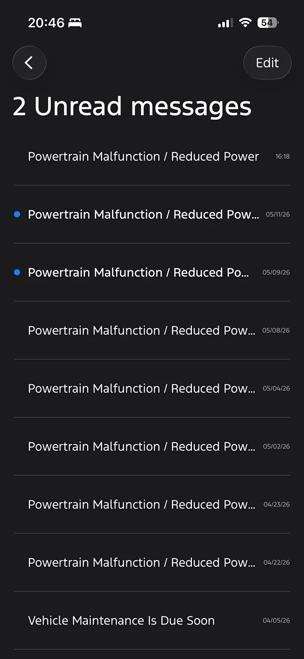

Warmer weather and started getting the error almost daily when the AC kicks on. Any tips on what to tell the dealer when I go in for service?

Just checked diagnostic codes
P0DE9 Coolant valve
C0604 Air dam system fault
Did you notice the fault when the A/C kicked on?
No, but I didn't need to use AC. Mine was the coolant valve. I have extended warranty so it was only $100
