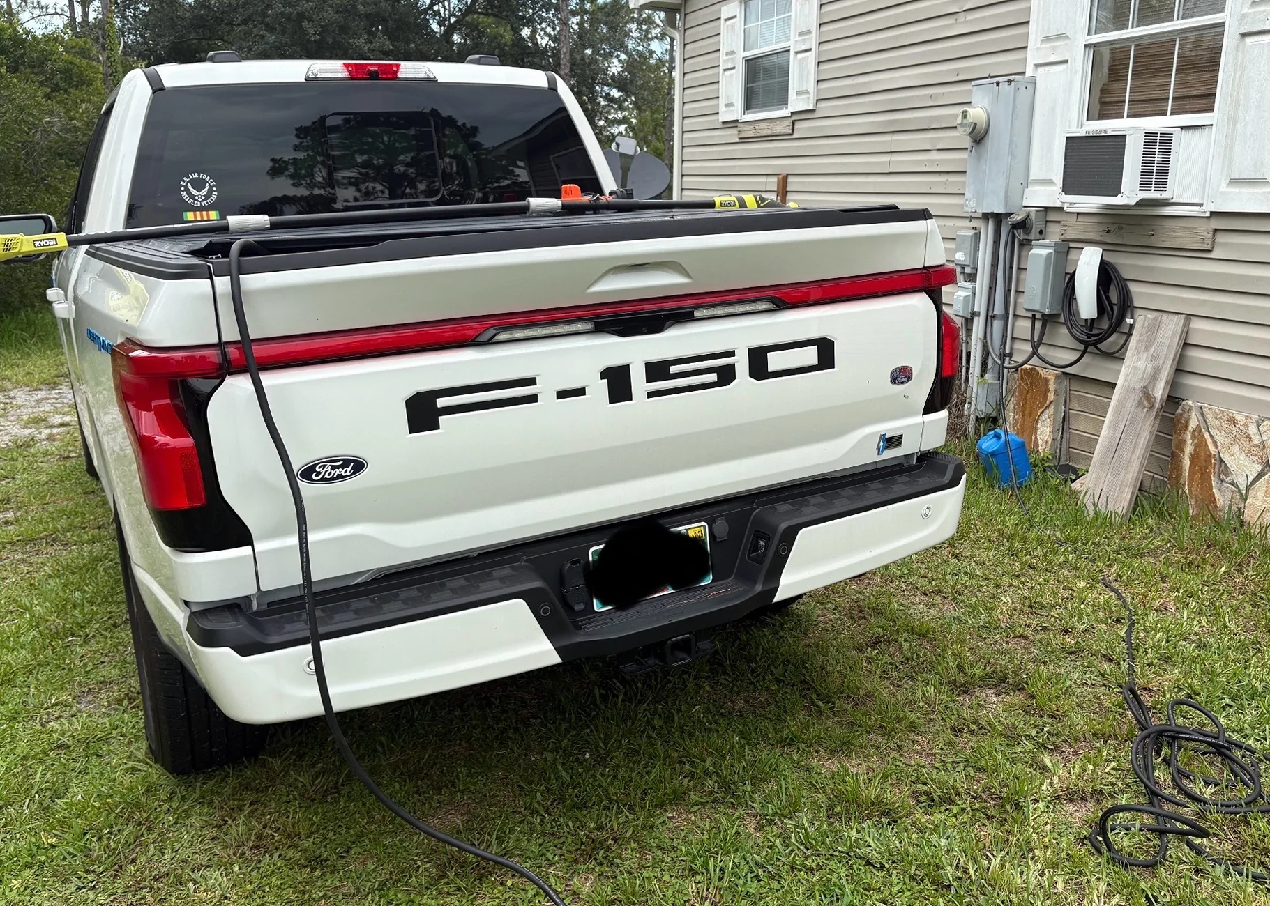

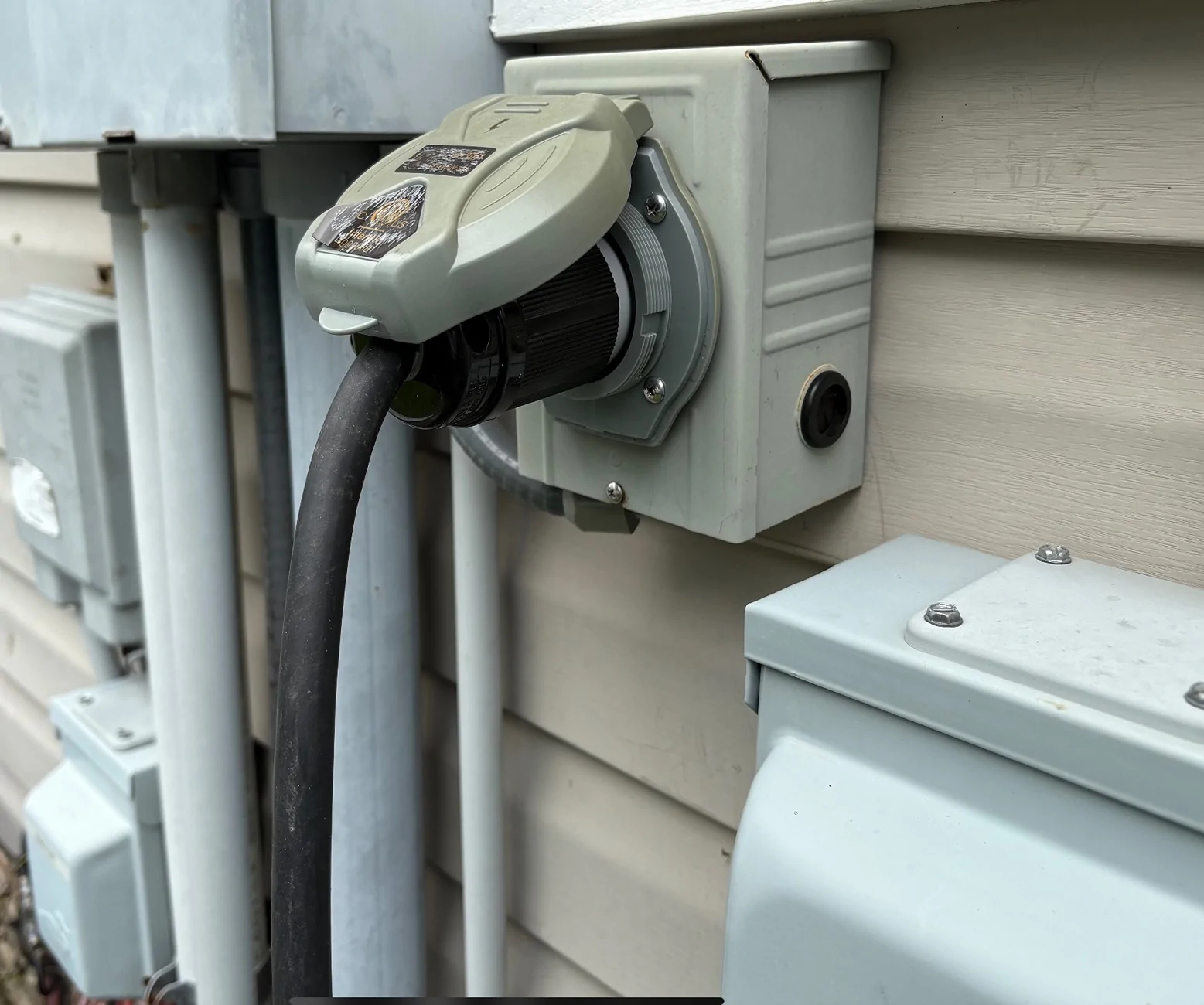

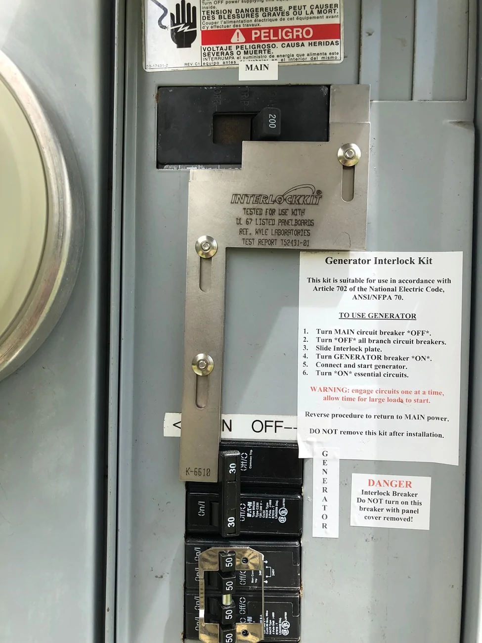

not complicated at all.
here is my truck plugged into my cabin during one of the many power outages due to downed trees taking out overhead power lines
Ford F-150 Lightning Pre-Purchase Guidance and Thinking Points IMG_0523
Ford F-150 Lightning Pre-Purchase Guidance and Thinking Points IMG_0524
Ford F-150 Lightning Pre-Purchase Guidance and Thinking Points IMG_0049

Thanks much. I’ll ask my electrician about it. The pics will help.

What the pics aren't showing is that the ground has been removed from the power inlet box or the extension cord in order to make it work. This removes the ground fault protection the truck provides.
If you want to keep the truck's ground fault protection you'll need a neutral switching sub-panel like the Generac 6852. This is a more involved install and limits back-up power to 10 circuits maximum.
There is a lot written about both options. I wouldn't worry about it until after you buy the truck.
