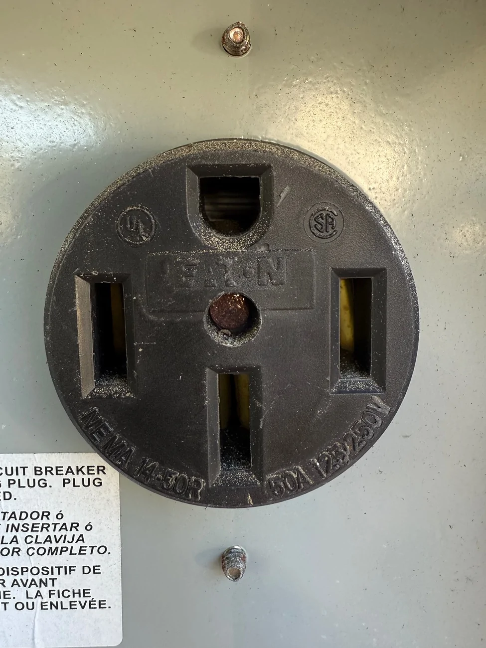

Thanks makes sense the truck has a shut off, I appreciate you confirming. One other question, do I need formal wall charger or can I just buy a Tesla portable charger like my friend had when he visited and plug it into my 14-50 NEMA 240v 50A outlet to charge the truck? I’m not sure they are built for long term use.

SOME are made for continious heavy use, others are not. Make sure you have the right one.
A hard wired charger is better if you can. You may even be able to use that exact wiring (ensuring current is set correctly).
