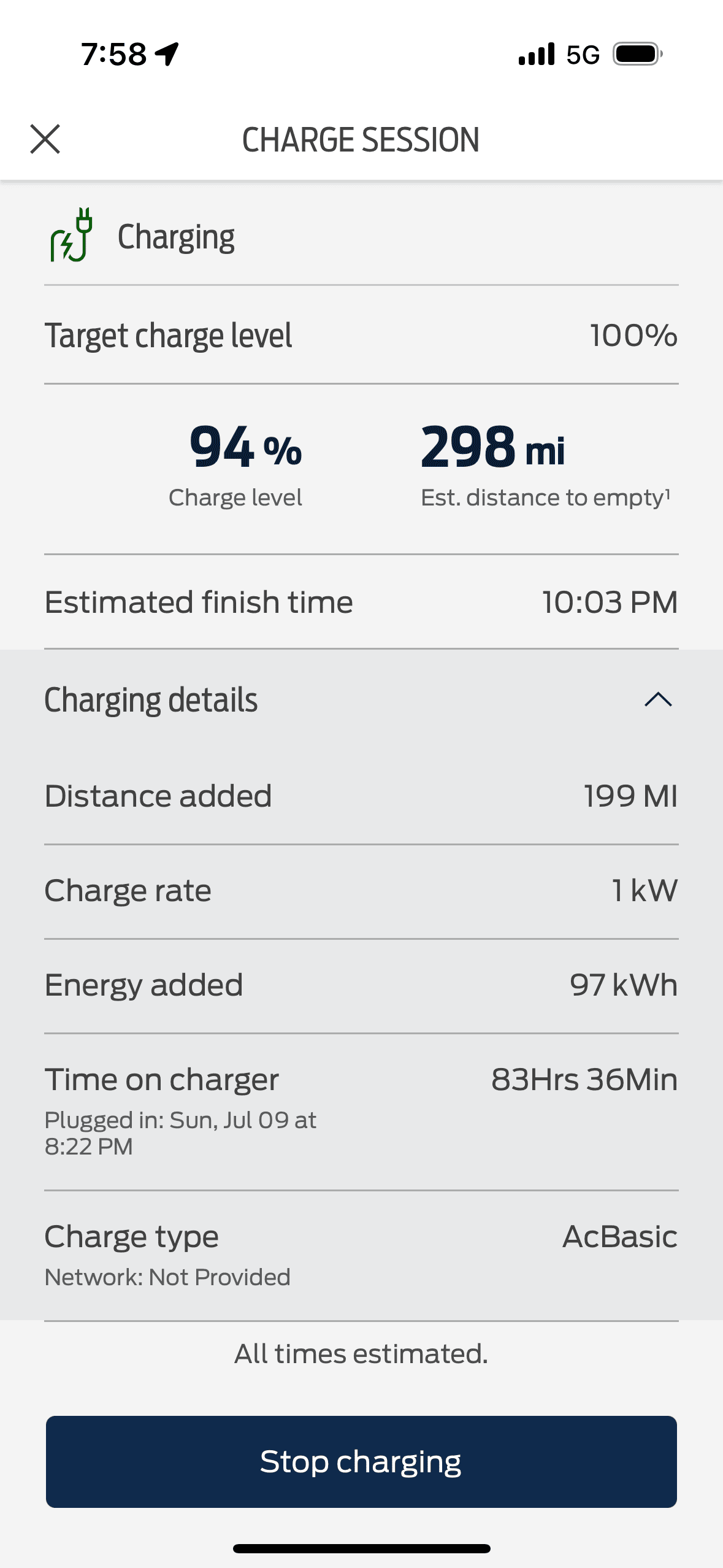

After this update my GOM dropped the milage estimate at 85% from 272 down to 261. Yes it’s really hot here in Texas so I assume its because of that too.
My truck has been plugged in charging for 83 hours straight now - charging on 120V at a rate if 1.2kW.
Ford F-150 Lightning Priority Update: 23-PU0306-BCF-DET IMG_4153
After this update, my charging target stayed the same (100%) but my charging time to hit the target decreased by 4-6 hours.
I doubt I’m pulling more juice if I’m on 120V. Which means I’m getting about 4-6kW less to max (3-4.5%)
@Jimbalf your numbers of 261/272 is 4%.
Maybe it’s a coincidence, but I’ve got a 1100 mile drive home in a couple of days and I really hope I’m not down 4% on my battery availability…

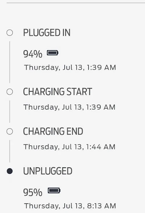

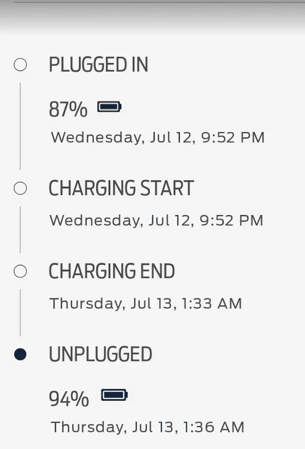

These were the charge logs from last night's activity showing what I mentioned earlier this morning.
Ford F-150 Lightning Priority Update: 23-PU0306-BCF-DET 1689254555522
Ford F-150 Lightning Priority Update: 23-PU0306-BCF-DET 1689254506428

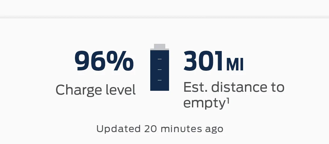

Did our morning routine breakfast run, which is admittedly short distance, but I was surprised to see the SOC increase from 95% to 96% after the 1.6 mile trip!!
Ford F-150 Lightning Priority Update: 23-PU0306-BCF-DET 1689254641182
After the return trip home, it dropped back to 95%
Temps' in the low eighties, AC running, mild mannered driving.
