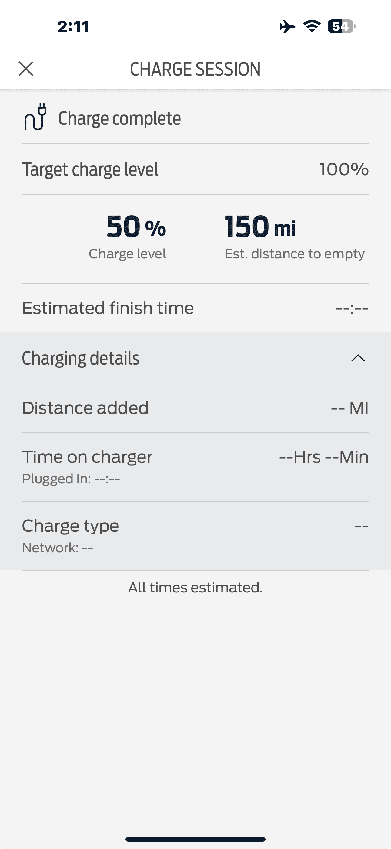

anyone having issue setting charge limit after receiving this OTA?
Same happened to me. I got the Improved DC Fast Charging update right after Power Up 6.5, so I'm not sure which update did it, but I'll go along with the Priority Update CHG3 being the culprit. The Waiting to Charge screen on the FordPass Home screen announced the charge target would be 100% SOC, but the Preferred Charging setting SOC was 50%, and that's what charging stopped at. The only thing I did before charging started to try to reset the target charge level was to change the preferred SOC charge level from 50% to 60%, then back again, and each time the FordPass app announced I'd successfully changed my settings, but the Waiting to Charge 100% SOC target never changed. Other odd things: no charging details in the charging report, and my FordPass got THREE notifications simultaneously that charging was complete! ?

So last night I shutdown the ford app and took my dog out for a walk. Came back and check the app again and to my surprised the issue resolve itself. Might be some major display delays.
It's stale cached data, when these changes occur, un plug the truck AFTER building the new profile, wait a good 5-15 minutes for the conditions in Fordpass to age out. Then plug in again, hopefully what you see is an accurate representation of what was programmed earlier.

Leave truck unplugged for 15 minutes after building a new charging profile.
I didn't keep track of when the correct % SOC target came back, but today, I did leave the truck unplugged while cold rebooting my FCSP/HIS unit, and I noticed later that the desired target % SOC (50%) is now back in FordPass without me having to delete and recreate a new charging profile. FordPass is now giving me more realistic estimates of how long it will take to reach the desired SOC, too.
