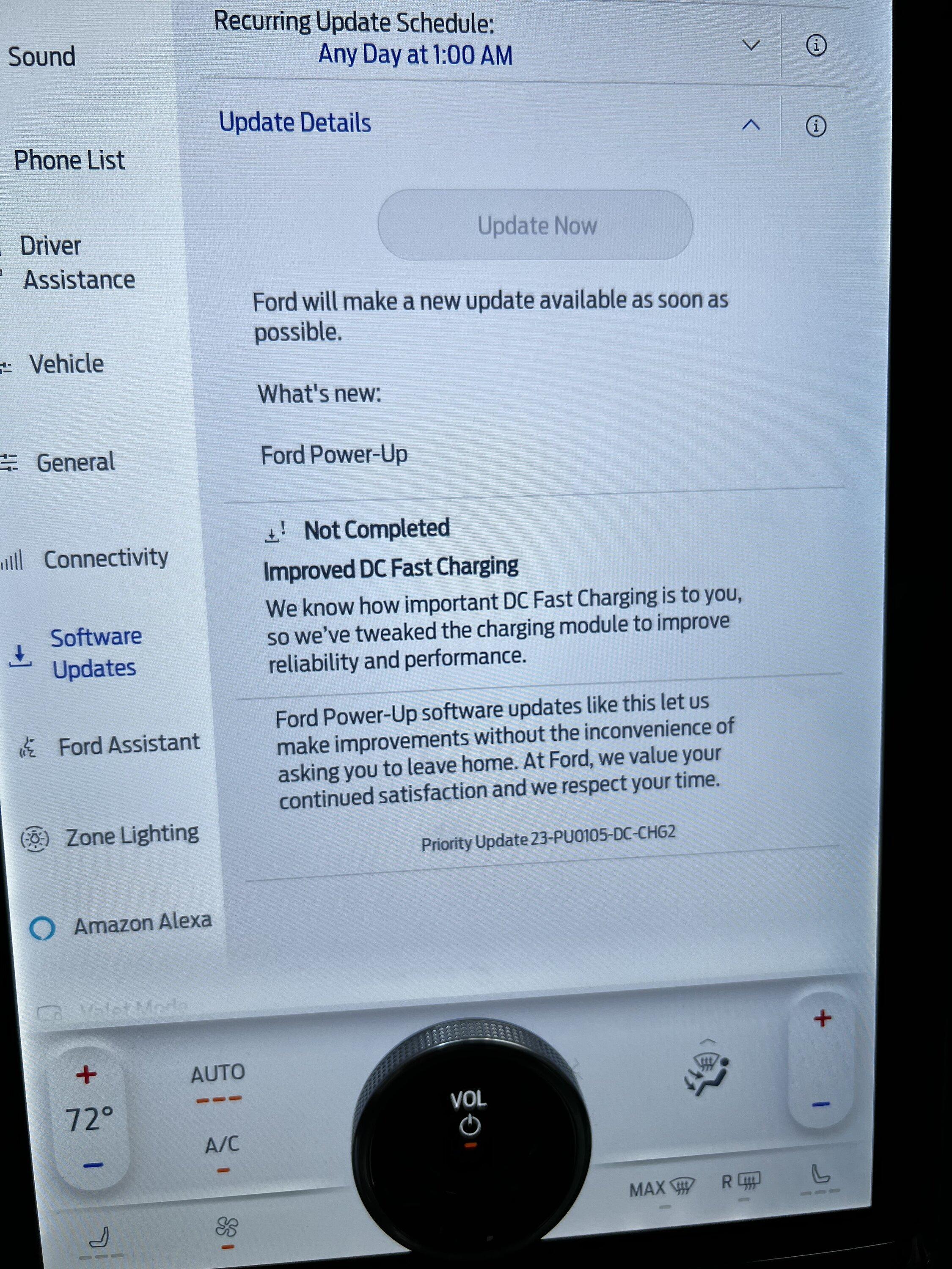

This is what I have
Ford F-150 Lightning Priority Update: 23-PU0105-DC-CHG2: Improved DC Fast Charging IMG_5019

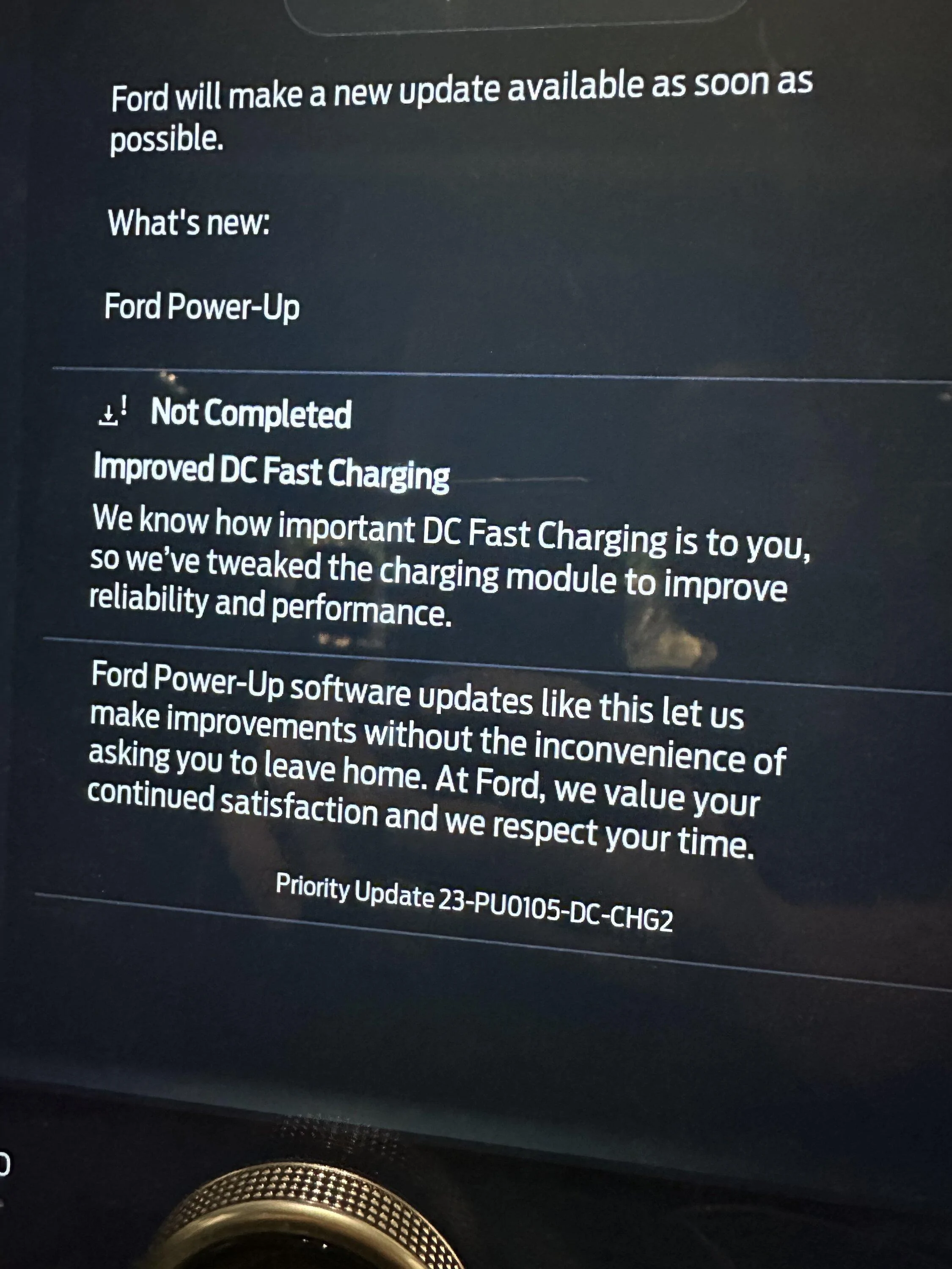

does leaving the fob in the truck make it so it won’t update? I may be weird but I just leave my fob in my truck all the time. In 25 years it’s never been stolen. My update has been stuck for months :(
Ford F-150 Lightning Priority Update: 23-PU0105-DC-CHG2: Improved DC Fast Charging IMG_1105
