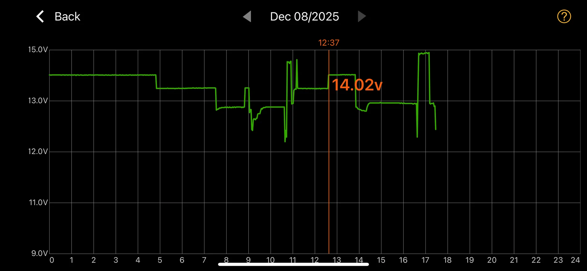

I’m a big advocate of putting Bluetooth battery monitors on all vehicles batteries. They give you the ability to check current and historical 12v SOC instantly. That provides great information for use in understanding what is happening with your battery.
