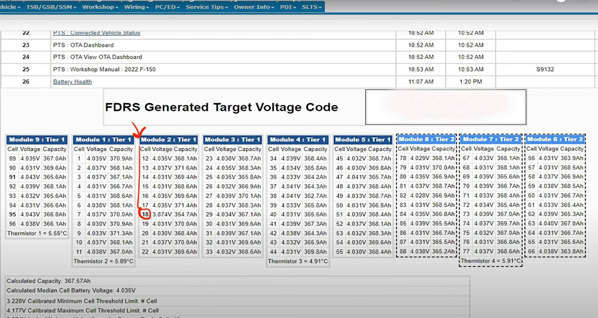

This was the best video I found that shows a Ford machine hooked up to the battery pack.
They can see individual cells on a display and identify voltage anomolies (look at module 2 cell 18)
FYI, the battery does not need to be removed for that report. It is done with FDRS through the OBD port. I did my own report back in January using FDRS and have two others that the dealer did before and after my repair..
The machine that is hooked up directly is the charger/balancer.
Is there any way to know short of having a great dealer how many modules are bad in your truck or if you are one of the lucky nine? Ford's lack of transparency and the time it has taken to address this issue is the reason I asked them to buy mine back.
Yes, do the BECM test (Battery Health test) as mentioned above. You need a Mongoose and a FDRS license. The report will identify bad cells. What we don't know is the the threshold for doing the entire battery (3 modules, 6, all 9?)
EDIT: I wonder if someone with PTS (@rugedraw) could see the specific action in that system?
