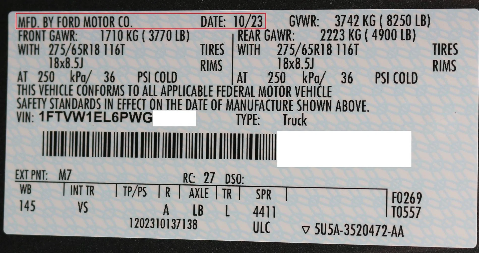

Ford F-150 Lightning Safety Program: 25S18: HV Battery Electrode Misalignment Discussion IMG_5731-mfg-2023-10-edit out vin

If they know which pouch batches are bad, they can probably relate the pouches to vehicles.
My truck was made in the first or second week of 2023s after the factory restarted for MY '23 production. So the pouches affected might be for 22s and 23s around that time period (Nov 2022).
I wonder when the trucks were made for other people here with the TSB,
My Lariat SR 22MY was made in July of 22 and is part of this recall.

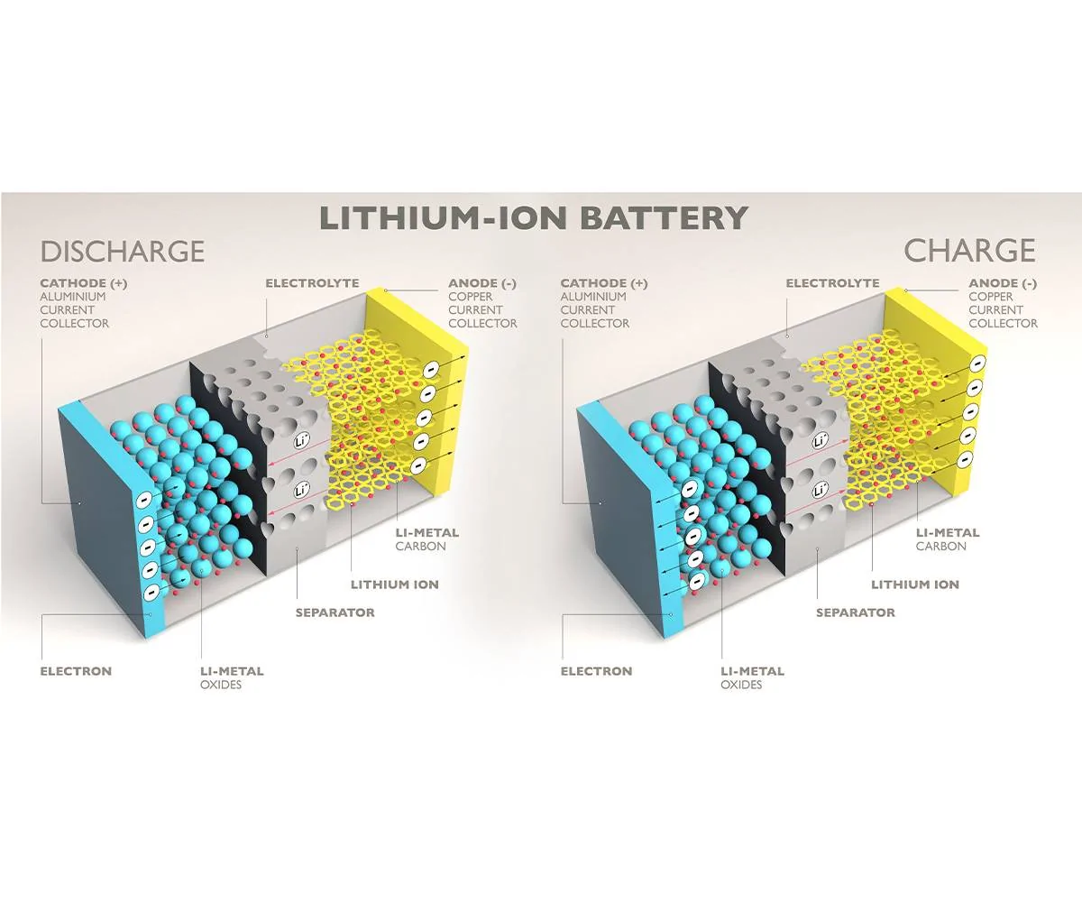

I suppose there is a problem with the cathode and/or anode shifting along the separator under stress which is why the 80% recommendation? The misalignment may be such that under stress the electrodes shift enough to make the separator ineffective resulting in a short.
"The anode and cathode are separated by a separator, which prevents direct contact and allows for the flow of ions during charging and discharging. If the separator material doesn't adequately separate the anode and cathode, or if the electrodes are misaligned, a connection could occur, causing an electrical short or fire."
https://www.gvs.com/en/catalog/battery-cell-separator-ev-and-ess
Ford F-150 Lightning Safety Program: 25S18: HV Battery Electrode Misalignment Discussion Battery-Cell-Separator-2
Just my guess at what's going on with the 80% limit recommendation.

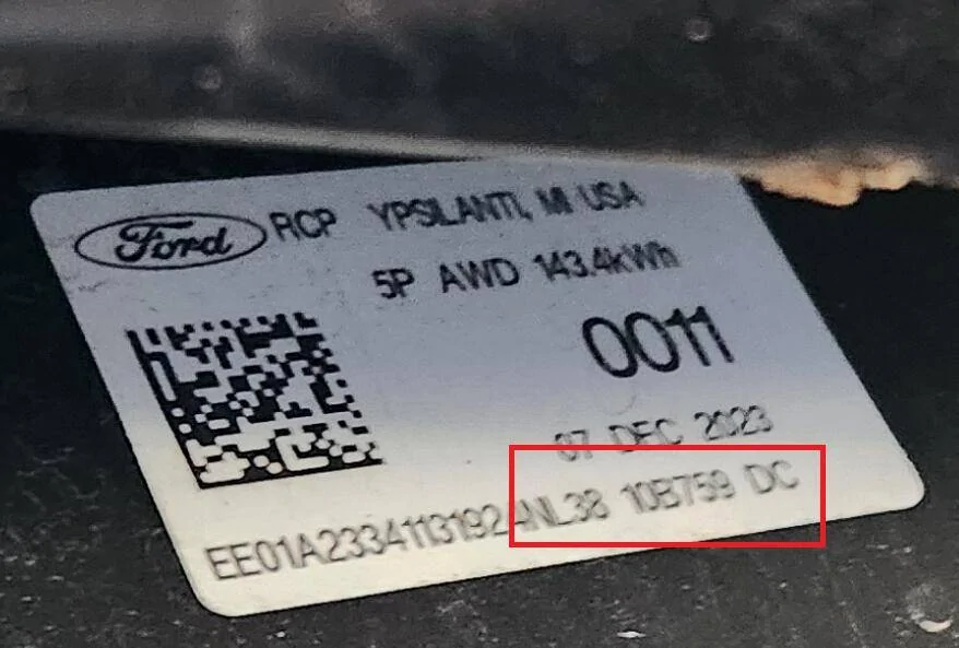

Hmm, my battery sticker shows NL38 10B759 CH and i am one of the WINNERs for the recall, so maybe the numbers shown for the recall are inside on the modules themselves?:

Possibly. Or there's more than what's listed in the article. Maybe others who have the recall can post theirs to see if any match. To find the above sticker, you can look behind the driver's front tire on the battery pack.
