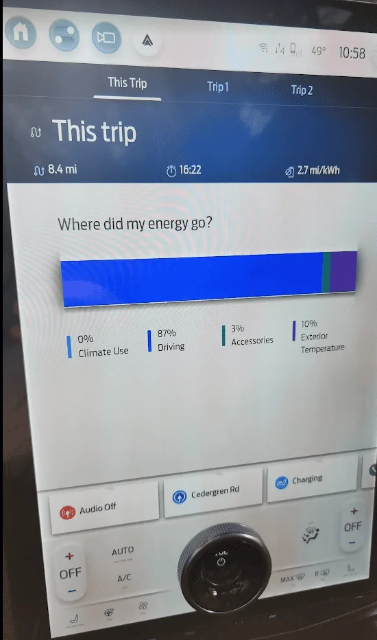

During the return trip, temps had risen into the high 40's, we had the heat off, seat heaters off, fan off, and no radio.
Ford F-150 Lightning Simple example of how temperature and heat usage affects range 1700317314318
A pretty graphic example of the impact of temperatures and heater use on range over the same drive. Something to show those who don't understand why their range drops in the cold weather.
In doing this, I did come up with a few tangential questions.
What devices are included in the Accessories category? I didn't have anything on during the return trip that I'm aware of.​
Is the External Temperature category a measurement of the energy used to keep the batteries at the right temp? I was somewhat surprised to see relatively high usage here on the return as the batteries had already been warmed up on the initial trip and temps were now almost 50.​

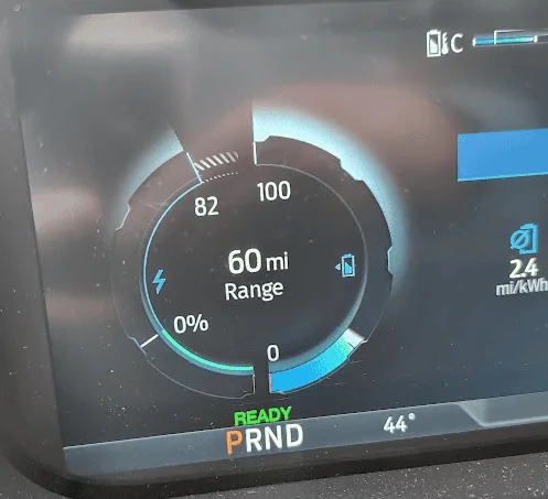

On the left side of the trip display, what is the left-hand graphic that shows 82 telling me? Is this an indication of the percentage of battery available for driving as the remaining 18 percent is reserved for the other categories?​

So the usage of heat only dropped you from 2.7 to 2.5 MPK. Not bad.
Or was the outbound uphill and the return downhill? What about wind speed/direction?

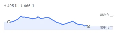

There was no wind to speak of. The ride into town is somewhat more downhill, but overall the route is hilly and I'd guess the net rise/fall is roughly equal in each direction.
Here are the elevation changes along the route going into town.

The 82% on the left hand side is the available power for output. This based on the low SOC of the battery at the time you took the shot.

This is a limit on how much power you can send to the motors, because of lower SOC and cool 44 degrees it is derated, if you bring the SOC up higher, the limiter will go away.

Accessories is everything except HVAC.
Lights, radio, heated seats, heated steering wheel, ...
As noted, you lost range coming home due to the climb. And optimum battery temp is mid 70s, not 50.
Which is why I'm still confused. None of those were on during the return trip. (Also surprised to hear that heated/cooled seats and heated wheel wouldn't be considered part of the HVAC system)
Return trip was 3%, about 90 watts. Trip there was twice that, around 214 watts... What's the huge screen powered by?
How did you generate that elevation analysis of your route? I have been looking for a way to do that...
Google Maps. Get driving directions for the route you want the graph for. Once it gives you the proposed route, select "Bike" as your mode of transportation. It will then display the elevation graph in the sidebar. It's used by cyclists to find routes with the least hills.

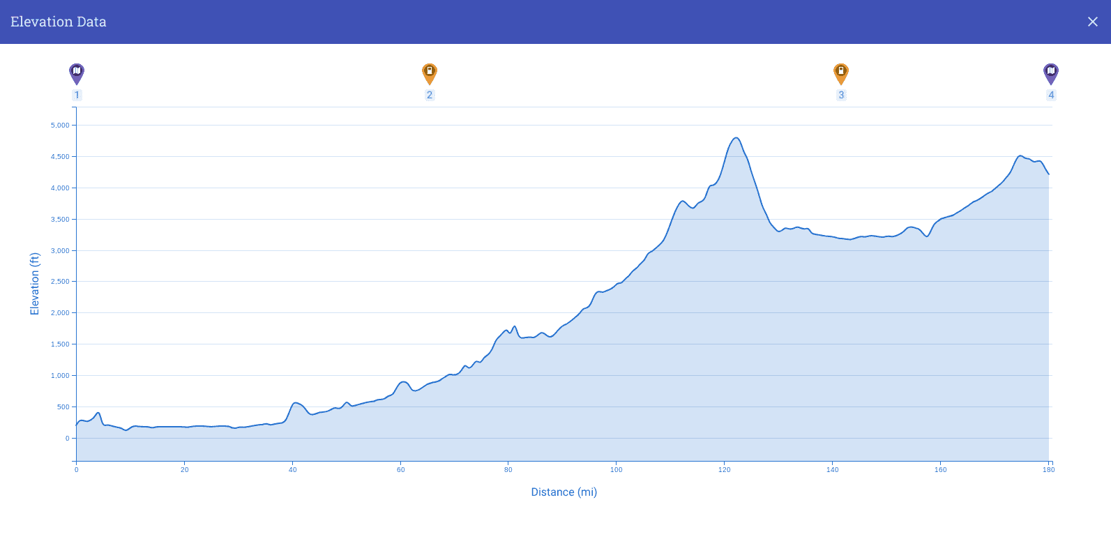

Thanks - I've done that, but often it changes the route when you switch to bike mode. However, I did find that PlugShare does a great job of this if you use their trip planner!
As you can see, elevation is going to be a big factor in this particular trip. I'm going to be carrying some gear on my roof racks too so wind drag is going to be significant as well.
