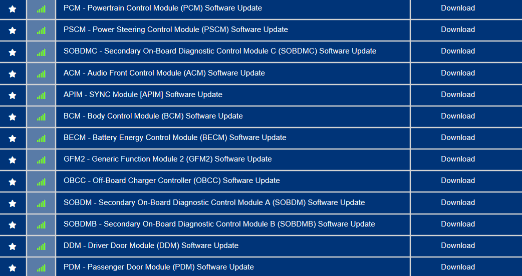

Interesting. So I had looked up my VIN in FDRS back on 10/8/23. I took a screenshot:
I assumed that all of the above meant I had pending updates for those modules. But maybe not. Like I mentioned, I was mostly curious and have never actually used FDRS to do updates.
It'd be interesting to see if you still show it. It could also be that other updates need to be installed before that one will pop up.

Updated list is below and the IPC update is gone. Now I'm really confused since @jw442 just updated 2 weeks ago and he was able to pull the update.

I can tell you this from personal experience: When I first got into FDRS and the OTA fiascos two years ago, my truck was repeatedly failing on old IPC OTA that job 1 trucks needed to activate bluecruise. At that point, I asked Jesse to look at my truck in hopes of some kind of guidance. What was strange is that the IPC update was not showing for me in FDRS. By then I had already gotten my Mongoose/FDRS, but he asked me to get FORScan also because he figured he was going to have to side-load the IPC update. However, as soon as I plugged my truck into FDRS and did the network scan, it pulled the IPC update from the servers.
I'm not saying that if you guys plug your truck into FDRS that the IPC update will miraculously pop up for you. I am just telling you about what happened to me. Right now, we have two 2022 owners here that said they got this update with FDRS; one of them as recent as two weeks ago. Reading through this thread:
https://www.f150lightningforum.com/...930-rba-chm-frunk-chime-vol-soc-digits.16050/
The update was released mid July and was rolled out for about 4 weeks before people stopped reporting it. During the roll-out, both 2022 and 2023 trucks reported getting it.
