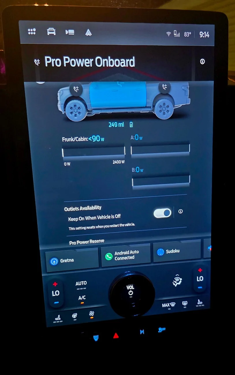

Why are we not talking about how stupid it is to allow PPO to stay on with the vehicle off, but ONLY with a constant 90 watt draw?
If I'm actively clicking a setting to keep it on, then I want it on!

Those conversations are out there lol. There's been no official word from Ford as to why, but the popular user explanations are: safety reasons; to reduce calls to tech support saying their truck is losing more range with it on; to piss us off.
Ideally, Ford would just inform the user when enabling the option. Maybe even give them a time out slider with no load too.

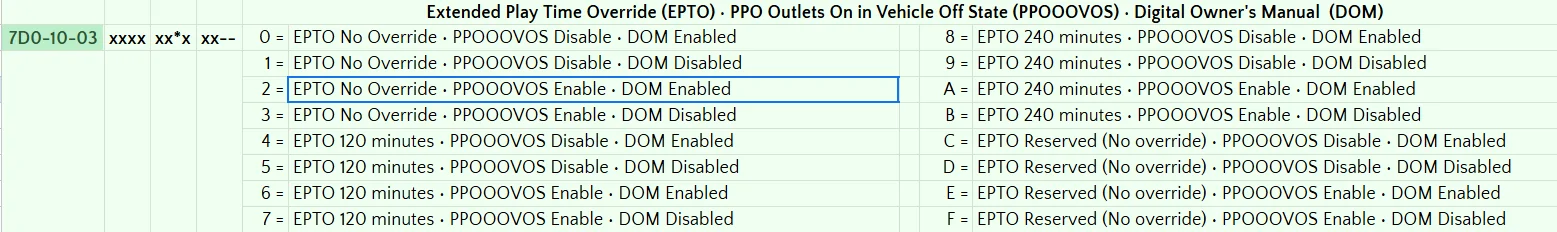

So I just reached out to Jesse about this last night and successfully enabled this on my 2022. Here's how its done. Insane that this simple modification hasn't been delivered OTA to people who have supported the Lightning program the longest. Use forscan to make these changes in the APIM.
Jesse-Infotainment said:
As long as the truck is fully updated in FDRS you should be able to do this pretty easy
Set
7D0-10-03
XXXX XX2X XXxx
7D0-10-04
XXXC XXXX XXxx
tHAT SHOULD ENABLE THE SWITH to leave outlets on. That should be all you need to do.

In which module?

90W minimum actually. I have a 110v timer plugged into one of the outlets with a small personal 200W heater plugged into it. The timer turns the heater on for 2 secs every 5 mins to keep PPO from turning off so I can use my dash cams as surveillance while the truck is parked. Heater never stays on long enough to get hot.
Works great.

As I understand it, there's a 6 min cutoff that's why I chose 5 min interval.

APIM. Can't believe it took this long to flush that one out

Careful in just putting in the circled values above. See this post for the proper values based on your actual config. Note you may also need updated modules.
