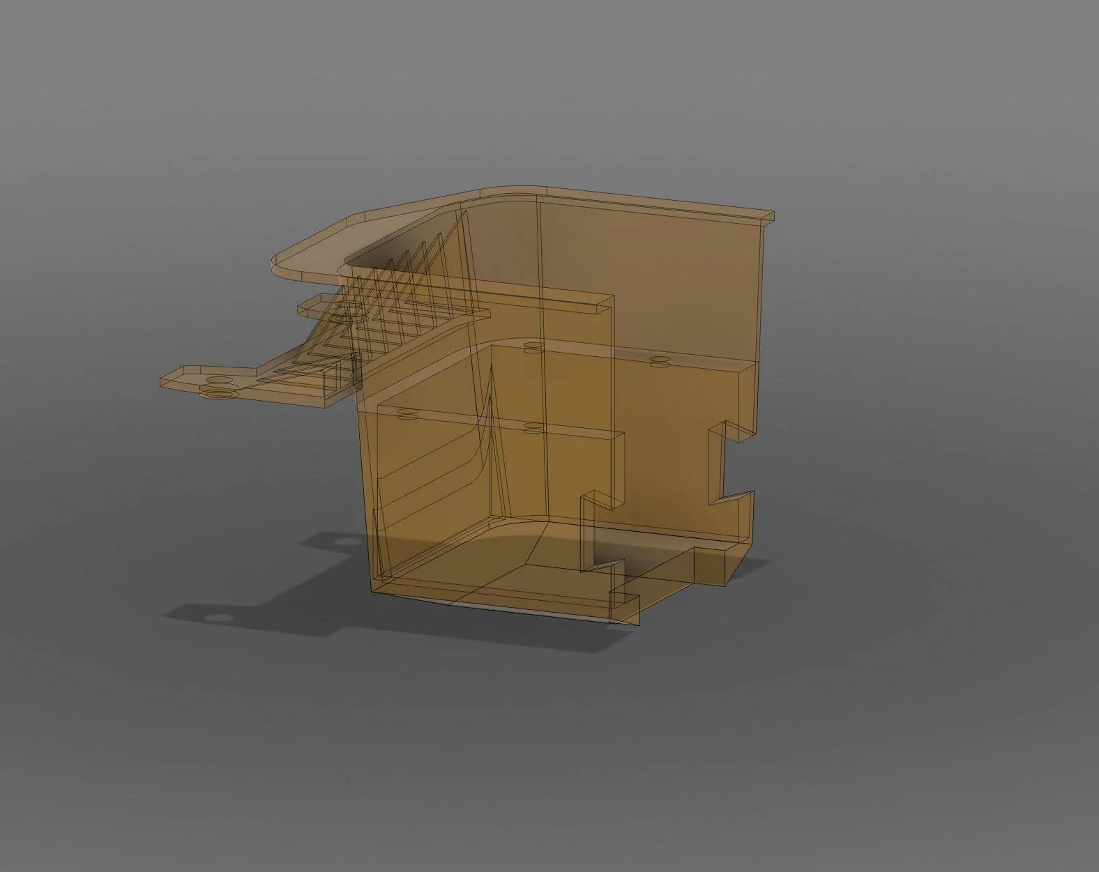

Can't open your Thingiverse .steps for some reason. But thinking about it more you could probably just dovetail split through the shift box and have enough material for the two parts to slot into one another with some modest transitional tolerance added. Would have a better mechanical connection than splitting coincident to the shift box face and needing to add tabs/hardware. For thin wall model splits it's usually recommended to use a convoluted surface to maximize surface area and add some self locating features.
I sliced the model like you suggested and I think it will work. I might do an additional dovetail at the bottom of the box. If anyone think this would be helpful for their build, let me know and I will try to post it this evening.
I'd add the 2nd dovetail for the added rigidity.

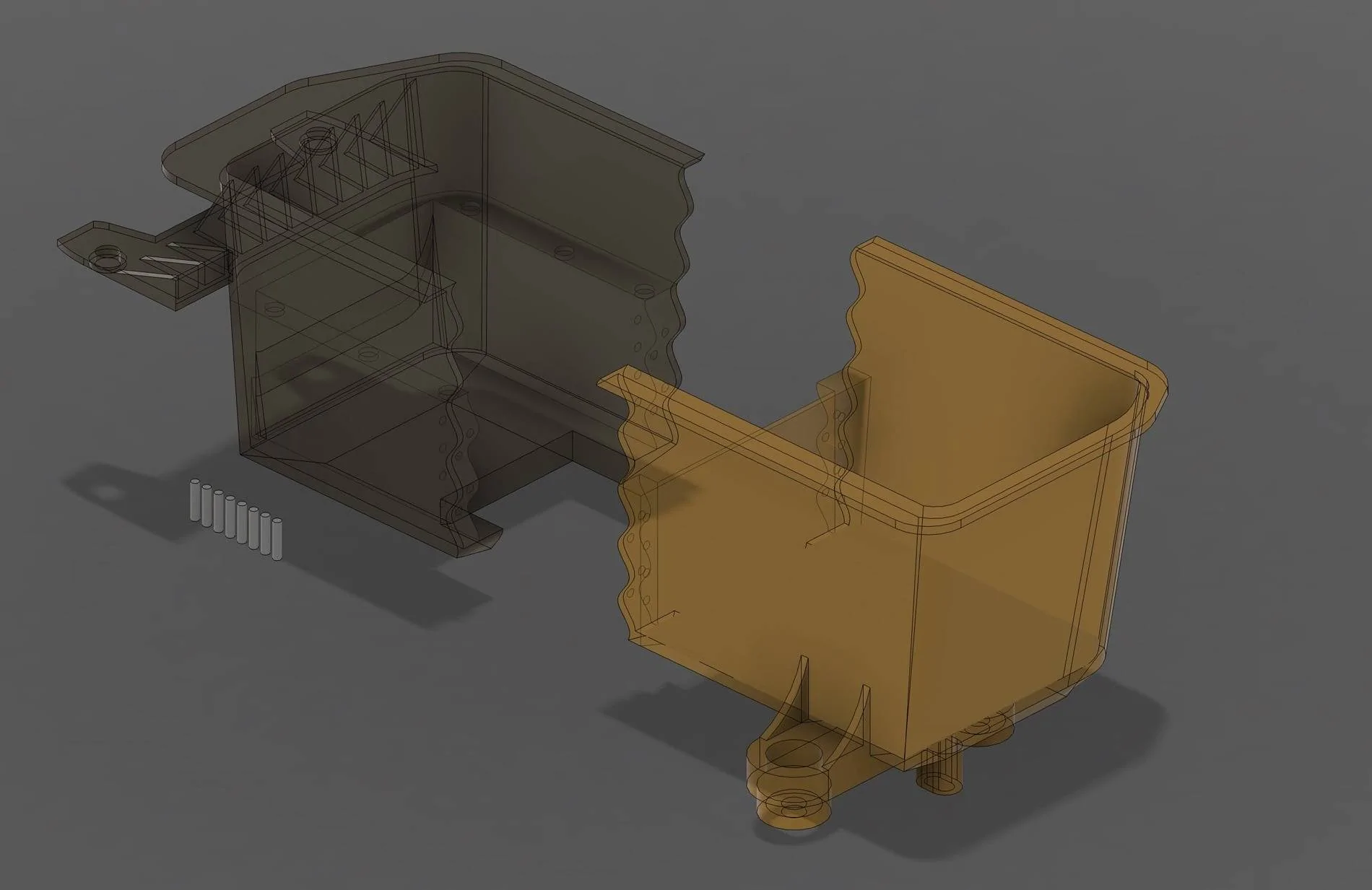

OK, that was.... way more ass pain than I anticipated, haha.
Anyway, here's what I made:
Ford F-150 Lightning Stick to Rotary Shift Knob Conversion w/ 3D Printed Rotary Shifter Holder Console split
I was all set on the dovetail idea, so I completely modeled that, but then started to worry about interference issues from support interfaces, so then I modeled a few more non-starters, threw all those away, then finally just decided to cut it with a spline and make some dowels (K.I.S.S. :headbang:).
So at this point I think this should work for everyone that's been wanting a small volume solution, but let me know since I most likely wont be printing this myself. I'm open to suggestions if I've overlooked something or something just doesn't work for whatever reason. The dowels have .1mm allowance in all direction, but the two main console bodies are straight cut due to their mating surfaces being pretty open.
Final notes: This version is plain as it gets, no features whatsoever besides the embedded shift box. I also fixed a weird issue that I just noticed where one of my bolt hole stanchions decided to attach to the internal gridfinity feature instead of the console's outside wall and then disappeared when I removed that feature. Shouldn't matter for previous models as I think its plenty strong as is (and maybe even helps to get your wrench back there). Lastly, I made another mat insert for this version as well.
Gentlemen, start your printers ?

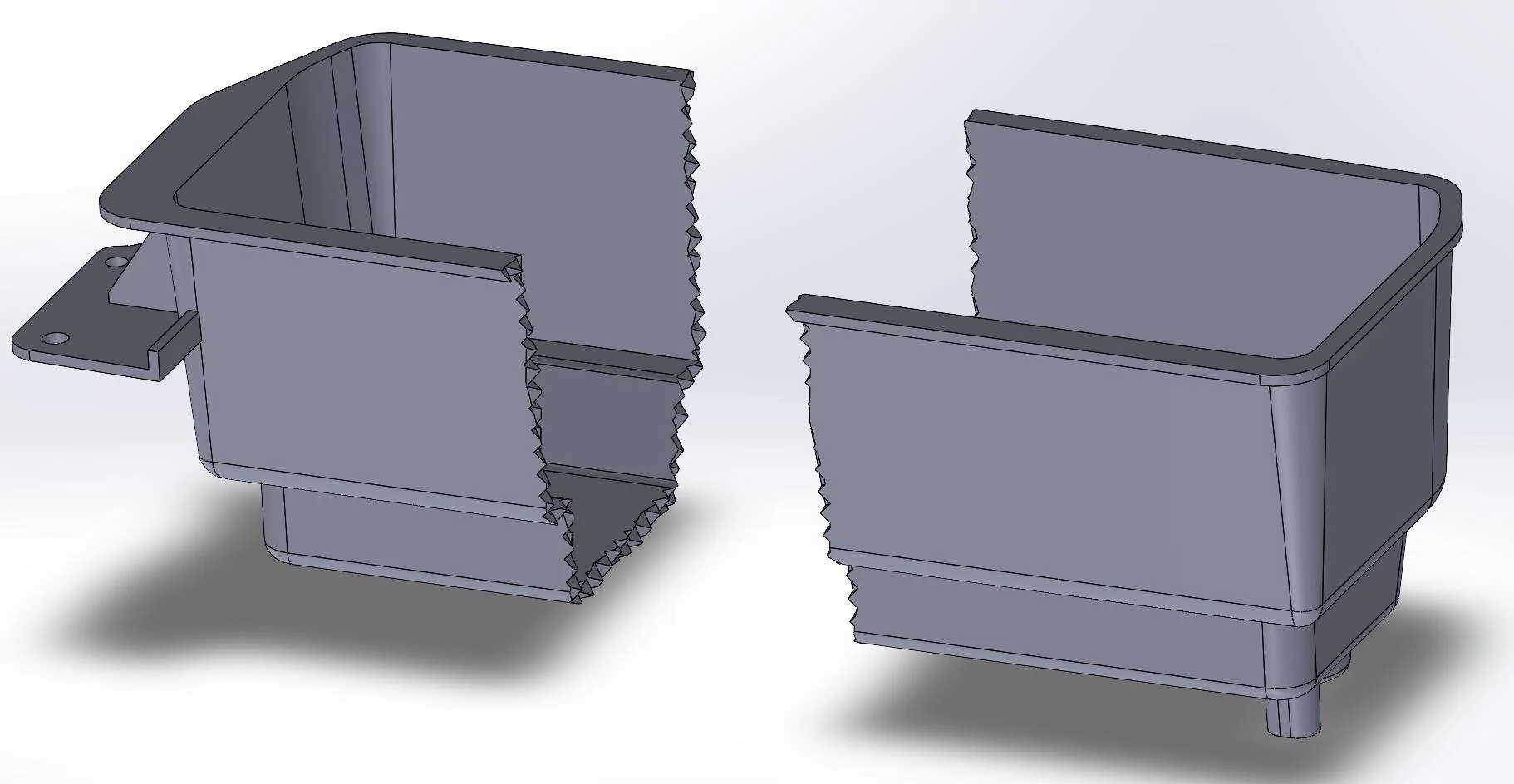

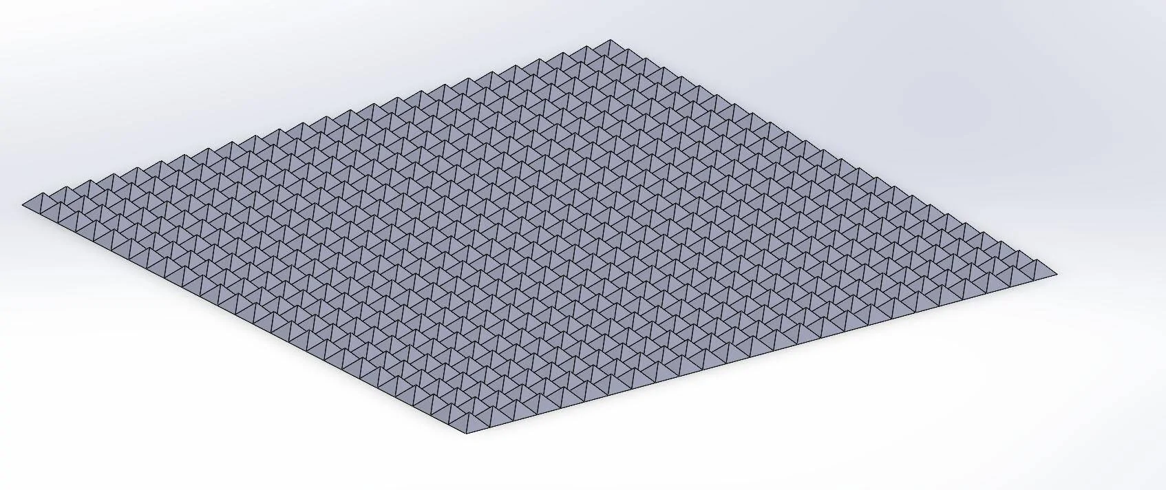

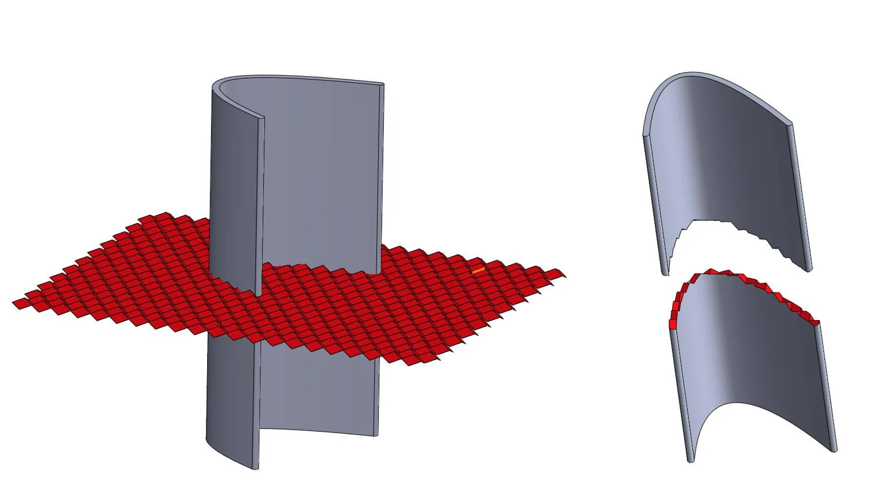

Learning CAD is my main all-weather hobby at the moment, so this is my "wild and crazy" cold Ohio Friday night fun, haha. Screaming goat videos are a close second as far as entertainment goes, so it was a natural fit for the pfp.
So, after posting, I went back and re-read what I'd skimmed through this afternoon and I see that @boggle suggested a convoluted cutting tool to separate the bodies. I.... I really wish I was proficient enough to do that now that I think of it. @boggle, if you could help me create a cutting tool like that, I bet it would greatly improve rigidity on the wall portions above the shift box. Feel free to PM me if you have any ideas/tools I can integrate.
This should work, made it 0.003" thick so there's already some tolerance built into the subtractive cut. Might have to scale and rotate the surface so you don't end up with hairline edges that aren't printable.

My printer has been acting up but I'm going to try print this with Carbon Fiber infused PETG. If I can get through the prints unscathed, I will post my results.
Thank you!
If you want to hold off a bit, I'm going to try seperating the body with the convoluted tool boggle sent me. Feel free to give it a go now of course, but I do think the sidewall will be much sturdier and locked in once I use that tool. I just haven't had time to work on it yet.
