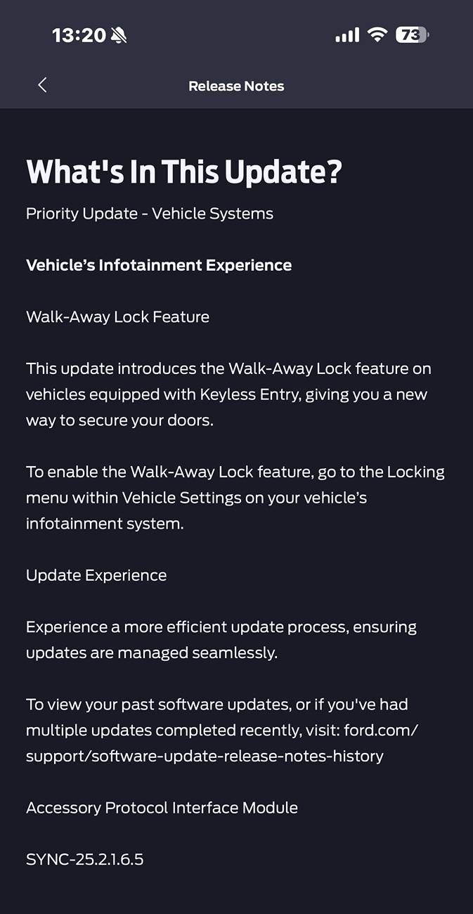

For those who have access to this kind of info. Is this APIM update available via FDRS at this point? I signed up for early access almost a year ago and don’t have any hope of them admitting any new vehicles to it.
195
14,469
15,771
What model year is your truck
Not Eric .....BUT, if you click on the arrow under our avatars, you'll be happy to see details about our rides, at least for those folks who took a moment to update the profile on the forum....
Ford F-150 Lightning SYNC-25.2.1.6.5: Walk Away Lock Clean-up {EAP} 1747740705733-8x

I received the WAL clean up today. So far it’s working great. Eap
Ford F-150 Lightning SYNC-25.2.1.6.5: Walk Away Lock Clean-up {EAP} IMG_2748
Watt2Go
Aug 13, 2021
51
68
VT
2021 Mazda CX30, 2022 Ford Lightning Lariat
Retired IT
Same here and added the menu items to disable/enable WAL and silence the audible on a 22 Lariat.

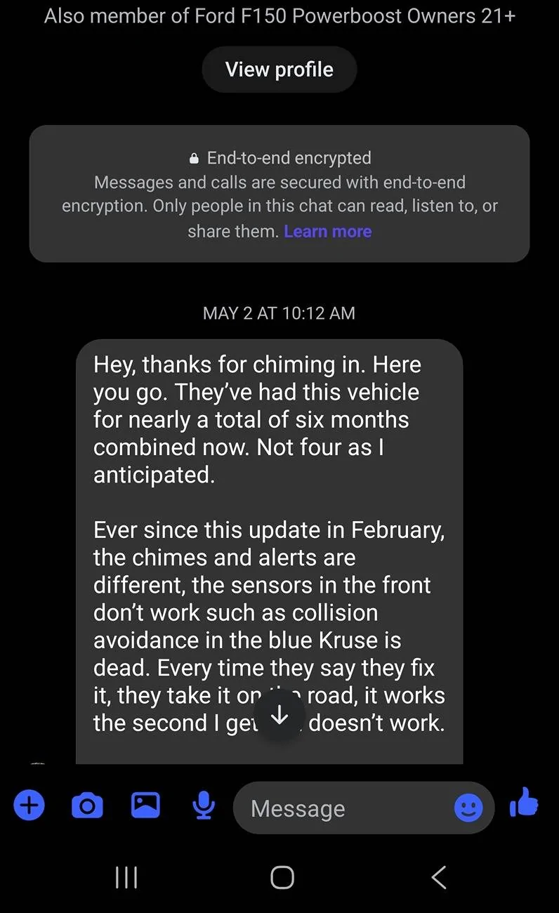

Everyone should be patient and wait a bit, FORSCAN seems to conflict with the latest update. And if you’re patient you may not have to deal with FORSCAN at all…
Patience is a virtue. Some people have and some people don't. Even the ones that have it, have a limit. Case in point: Found this guy in a Facebook group looking for help. Truck had been in an out of the dealer with (supposedly) Ford engineers involved; claims a field engineer was sent to the dealer to figure out the issue. BC stopped working after the BC 1.4 OTA installed. FORScan virgin truck. He sent me his VIN and in 15 seconds, I found the issue. The OTA added the config for lane change and all the other stuff, but turned off the config for BC and enabled traffic jam assist instead. I had him make two minor changes in the IPMA and his issue was fixed in 3 minutes; something the dealer could not figure out in months and multiple drop-offs of the vehicle.
Ford F-150 Lightning SYNC-25.2.1.6.5: Walk Away Lock Clean-up {EAP} Screenshot_20250520_143402_Messenger
This is one case out of literally hundreds of people have fixed things with the knowledge and help of a very select few people on these forums. So those of you that want to wait for Ford, y'all go ahead and continue do so.
