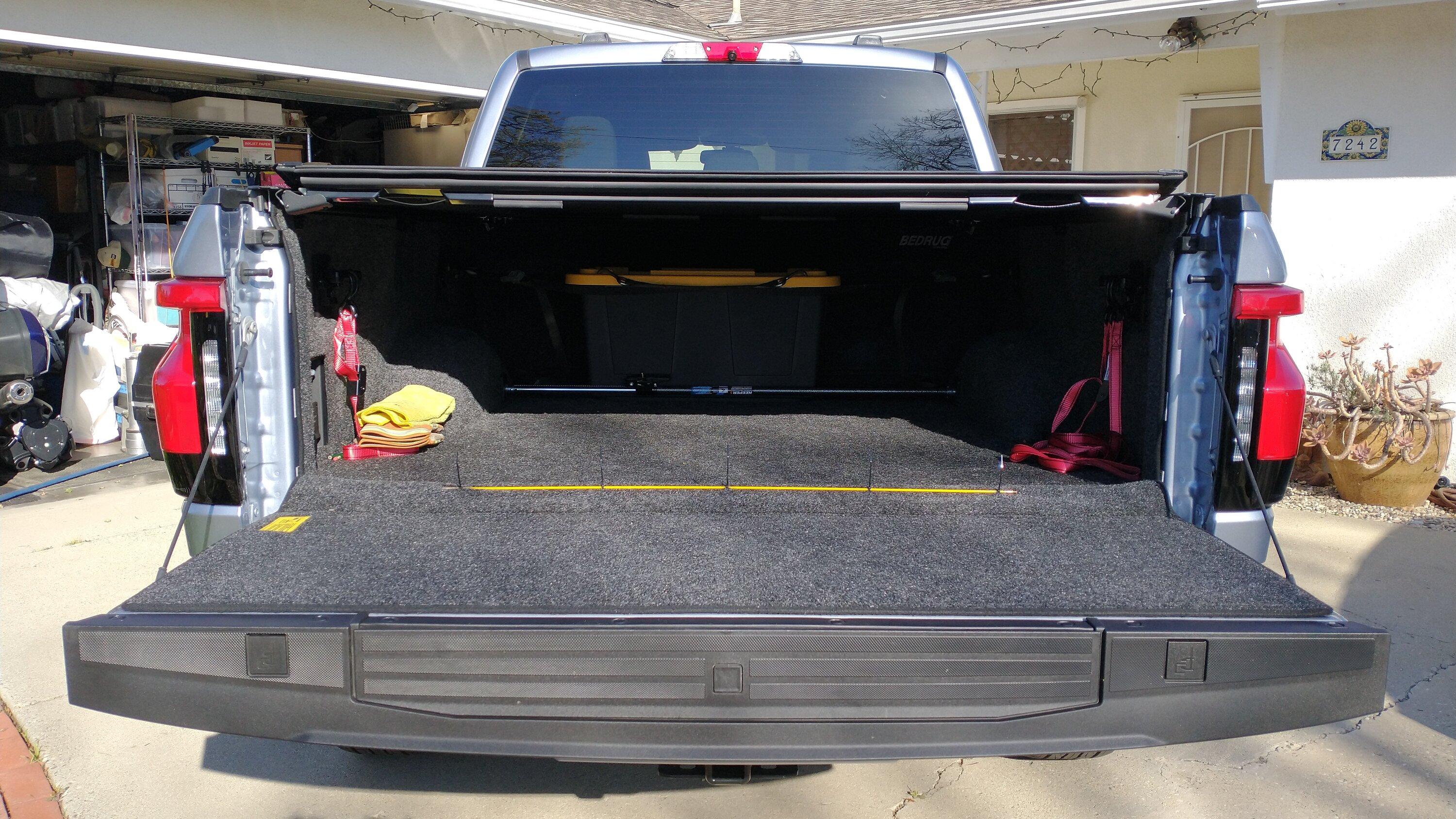

I also think a pinching of a Bedrug in the tailgate gap might be problem for some of us. So, to keep the Bedrug over and out of the gap, I added a three foot, 3/16" fiberglass stick (from an electricians wire pushing / pulling kit) with thin tyraps threaded through the bed material. This gives me a way of pulling up the rug from getting caught in the gap and somewhat trains the material to stay out. Silly system, but works for now. Probably should just cut out that rug section and maybe put in the Ford tailgate dust seal.
Ford F-150 Lightning Tailgate status glitch IMG_20230208_092709073 2022 Ford F-150 Lightning pickup bed BAK Revolver X4s cover lifted cont
edit 3-31-23: maybe a 2" cylinder of very soft foam, that can be crushed in the tailgate w/o causing a pinch problem, could fit under the rug at the gap?
