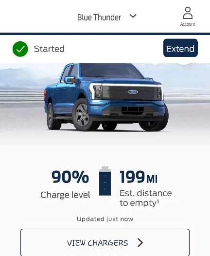

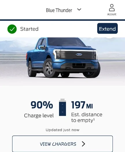

I made this post in the cold weather thread. Thought I would share it here too since it keeps the steering wheel heat on while "preconditioning" your truck:
Remote start the truck while plugged in. It will heat the cabin and draw power from your EVSE to keep you battery charged. It must also help the battery warm up because my range increased from the time I remote started to the time I left. And my heated wheel worked after I unplugged.
This is the screenshot of when I remote started while plugged in. What's interesting is it never gave me a time limit saying how long it would run, and the "extend" button didn't give the "+15" limit. I never tested how long it would run, but I'm guessing more that the standard 15 minutes.

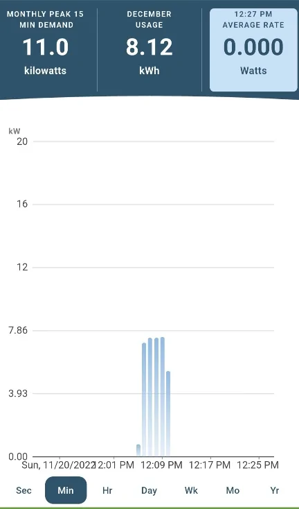

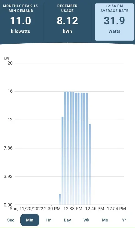

I tried it twice. Once with my FCSP set at 32 amps and 80 amps. Both kept the battery fully charged to my 90% limit.

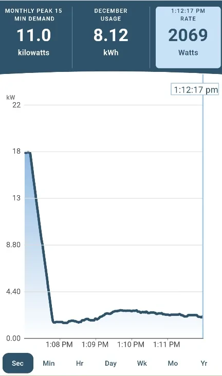

What was interesting is on the 32A limit, it pulled the full 32A until I unplugged. On the 80A limit, it pulled the full 80A to a point, then bounced at a lower setting. I can only screenshot so much data, but you can get the idea from what's displayed.
At your 80A FCSP setting, I’m wondering if your truck is initially going into a Charge State, then recognizing it’s at the set SoC, then ramping down to the level required to precondition and maintain your SoC?
I believe that is the case. I cropped them out of my screenshot, but when I first started the truck, it gave me a time on FordPass when the battery would be fully charged to my set point. It was only a minute or two after I initiated the start. When I was getting the lower kWh reading, the FordPass app stated that I was "plugged in not charging".

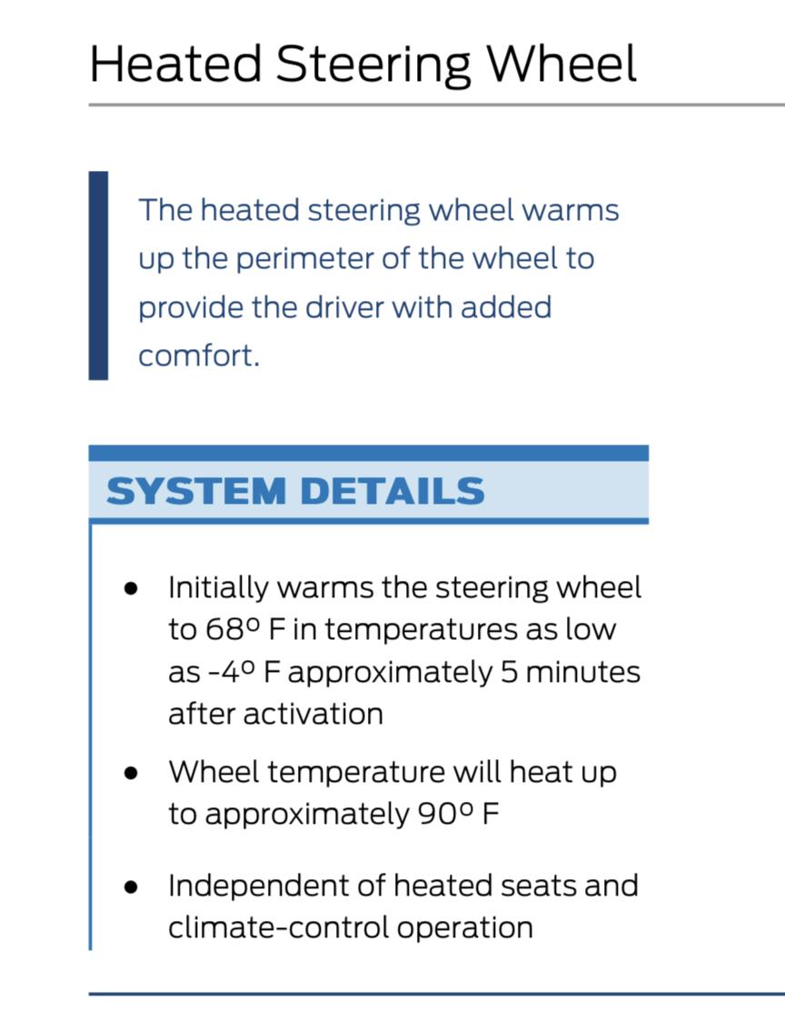

I noticed the issue as well and went looking for the official feature description in the 2022 Lightning eSourceBook, this is what it says:
Ford F-150 Lightning Cabin Departure time heated steering wheel glitch 582D1328-72A7-4962-B477-D78F800BD182
My guess is that it kicks on when preconditioning starts, reaches the max temp, and then shuts off before we get in… seems like the chill is off the wheel, but it’s not super warm. But like I said, I’ve noticed the issue, as well.
