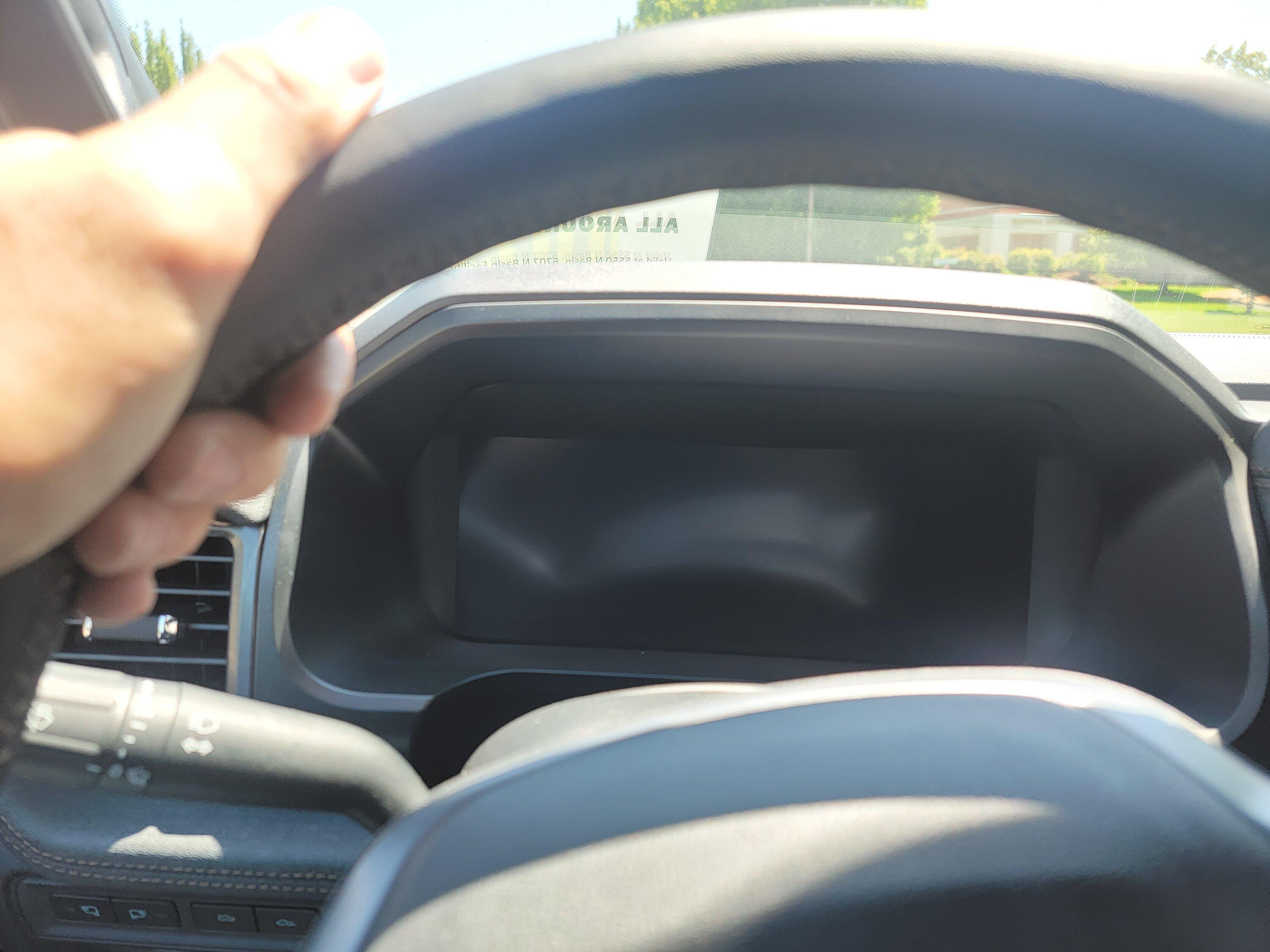

Happened while driving. Going around 70 mph on I84. Blue cruise on.
Dash screen goes instantly black; no idea how fast I am going; had to hit brake peddle (couldn't tell if Blue Cruise was on or not); no idea wtf was going on.
Took first exit; parked in a hotel lot near PDX; turned truck on and off a few times; locked-unlocked doors----nothing. Eventually, screen started working after truck was off for about 20 minutes.
Contacted Gresham Ford (dealership where purchased.) The sales guy was understanding; the service guy gave me attitude (not even joking).
I am to the point where I am going to tell the dealer (and Ford) to stick this truck square right up their arse. (*Can't make outgoing calls, now this black screen stuff . . . in less than 500 miles?!)
Ford F-150 Lightning This happened today. 20230703_124803
Pic taken while pulling into hotel.
~JH

Oh...so that's what the new "Calm" screen mode looks like. Doesn't seem to have a calming effect though..:unsure:

You're entitled to feel however you want about it but things break. Looks like a bad screen to my untrained eye. It's an obvious safety threat but 'obvious' to you and I might not be obvious to the dealership service tech.
If @Ford Motor Company hasn't contacted you already I suggest sending them a DM. They were very responsive to an issue I had. If it were me, I'd be concerned about losing the screen again. Losing speed and BlueCruse status is a safety issue and should be addressed. Probably with a new screen.

Sorry to hear you’re having issues. In my 10 months of ownership and 21k miles I’ve only had the main screen freeze up and reset twice. Never anything with the instrument panel screen. Hopefully they can fix your issue. That is a serious safety concern. If your dealership won’t take it seriously try another nearby Ford Dealer.

i had the same thing happen last Thursday. I turned the truck off a few times, no change. Then I left it off for an hour and it came back on.
