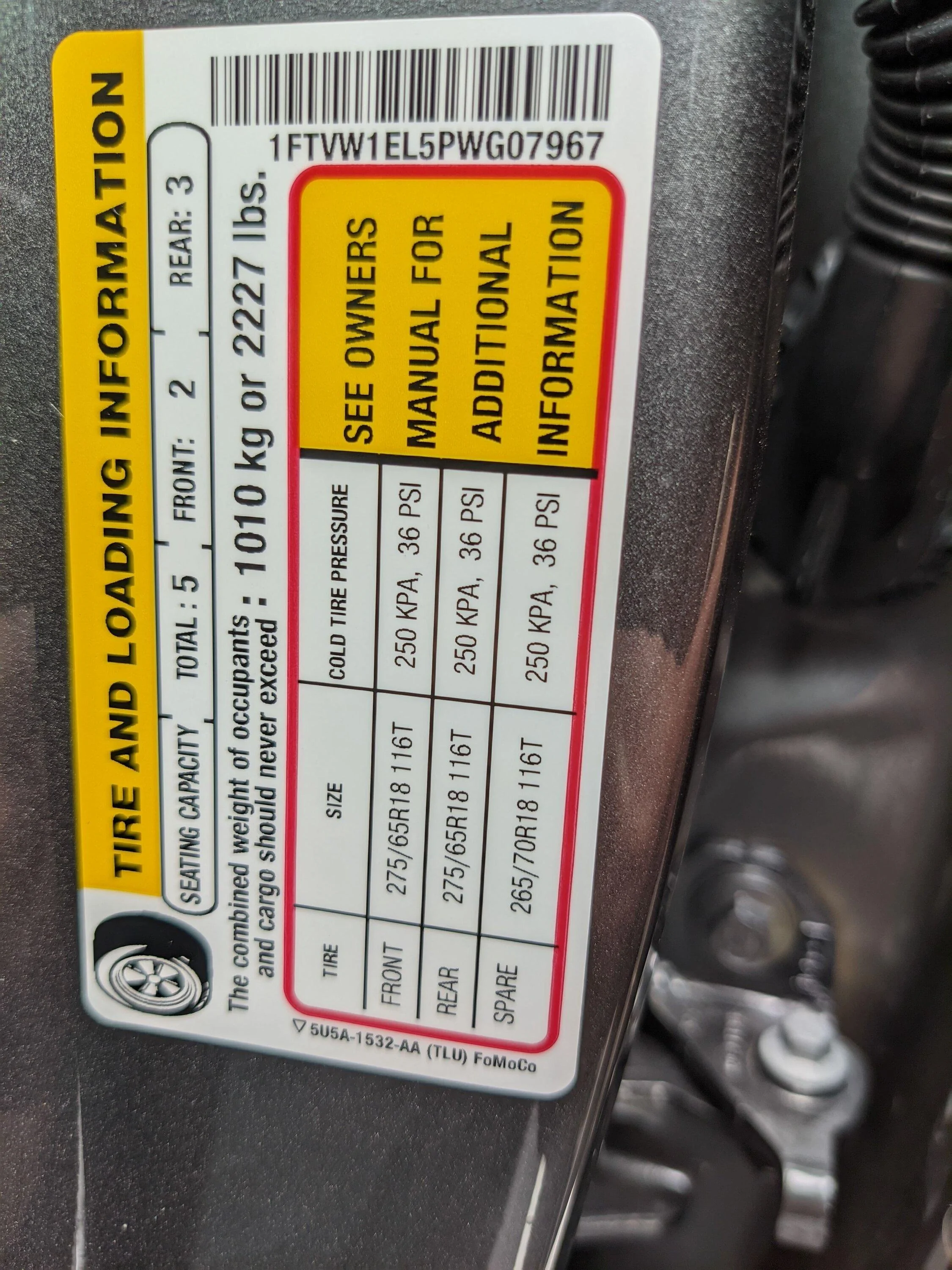

Good luck with your intermittent issues. However the tire pressure should not be increasing to 40psi it should be decreasing. The recommended pressure for the OEM tires is 42psi.

Is that the case with PRO's and AT's , not seen a tire placard for a PRO in a long time.

The manual doesn’t define a difference.
Mine is Lariat and its placard says 42.

OP is running a PRO, IIRC there are differences with trims and tire/wheel fitments.
You are correct
Ford F-150 Lightning Tire Pressure TPMS Fault and low keyfob range PXL_20230615_085727022
The PSI doesn't seem to be affecting my issue though. I completely forgot out the Govee LED interior lights I added. They seem to be causing the issue. When I turn them off, the range on the keyfob increases tremendously. No idea why, but sometimes the led lights have little to no affect on the range and sometimes they affect it to the point where I need to be right next to the car. I know that LEDs cause cause weird RF issues.
