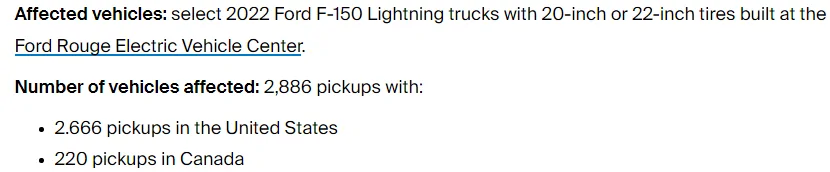

"The safety recall is specifically for vehicles with 20” or 22” all-season tires and is centered on the tire pressure monitoring system (TPMS).
The TPMS light may not illuminate properly which can lead to customers not being provided with adequate warning of a low tire pressure situation. Ford explains that the issue is because the recommended tire cold inflation pressure value in the Body Control Module (BCM) was incorrectly set to 35 psi rather than the correct inflation pressure of 42 psi. Therefore, the warning won't be issued until the tire pressure is lower than 35 psi, 7 lbs lower than the proper warning threshold." - https://insideevs.com/news/594697/ford-f150-lightning-safety-recall/
Pros and XLTs that didn't elect for 20" wheels are not affected.
