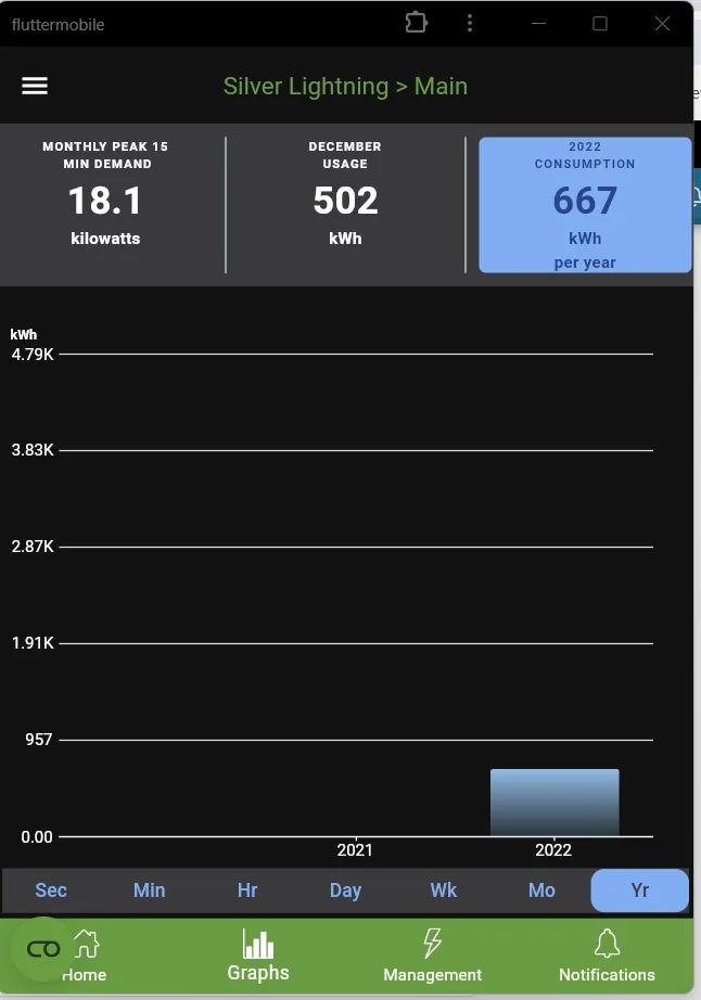

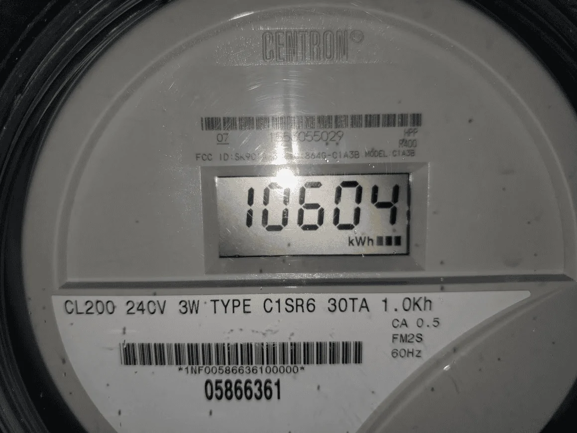

In the past 15 months that my new exclusive electric service to my garage has been active, I've hit 10.604 MWH of energy, includes heating and lights.
Ford F-150 Lightning Top battery off to 90% every day? 1703514366186
Of that, the Lightning has drawn 4.495 MWH from 12/1/2022 to 12/24/2023
