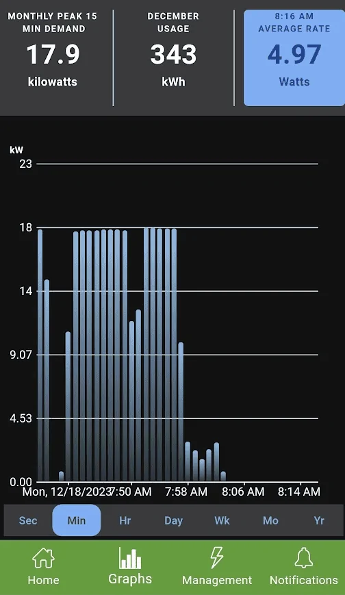

Is there a thread out here that confirms that if you remote start while plugged in the power is supplied by the FCSP, like preconditioning?
Also, what steps do you take to unplug after a preconditioning and departure warmup? 1. Remote start. 2. Stop Charging. 3. Unplug. 4. Enter vehicle and finish remote start.
While plugged in, the energy to warm the battery & cabin comes from the EVSE assuming you do not have a programmable EVSE that shuts off power feed according to a time schedule, the Ford CCS & FCSP don't do that.
This is a recent test of Departure Time, the graph shows all 7.56 KWH coming from the FCSP
Ford F-150 Lightning Top battery off to 90% every day? 1703115413758
We've talked about Departure Time ~preconditioning of the battery & cabin~ in the past, a lot of advice about when to time it, which is moot if you have received Power Up 6.5.0 which fixes a glitch with the steering wheel warmer.
As others have said, unplug, jump in, "Press to Start" if it's still "idling" within 10 minutes after the planned departure time , drive away.
If the truck went to sleep >10 minutes, then foot on brake & press to start button.
