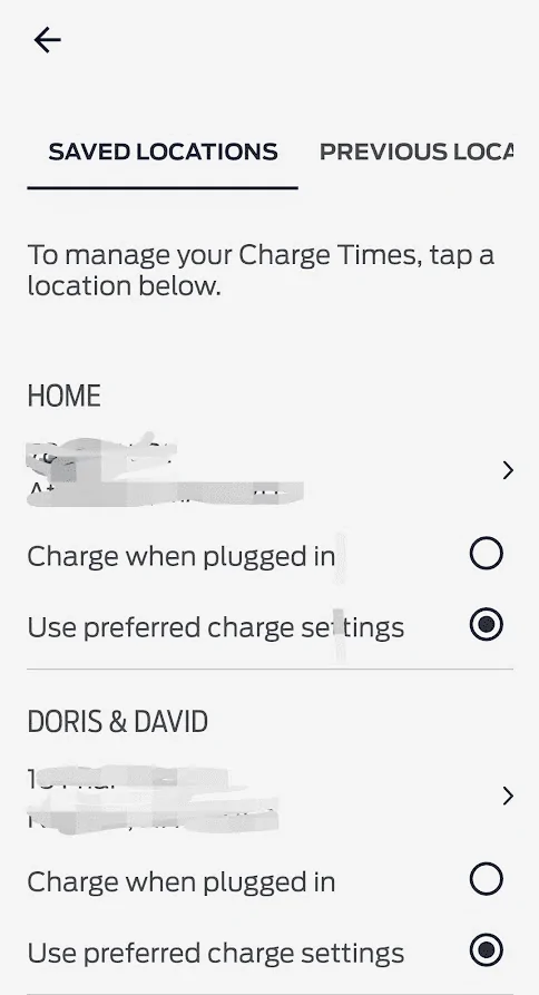

I have a saved location called Home. In the app under Saved locations there is a choice for Charge when plugged in and Use preferred charge settings. I chose preferred. Clicking on the location I can set a max charge level (mine is 90%) and for Preferred charge times I chose set my own time - then Anytime for both Weekends and Weekdays. Mine has always stopped at 90%.
I have all these settings set the same and it ignored the max charge of 90% - twice at work and now once at home.
I know how to use the equipment. It’s not doing as it’s told.
