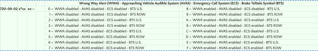

I didn't think there was a way to disable the pedestrian sound speaker via Forscan. Can you provide the module and settings to do that?
Just take out your glovebox, unplug the PACModule on the passenger kick panel then make one change in FORScan to eliminate the nag message:
Change the 2nd nibble of the IPC Block 9 Group 2 from 4 -> 0
*or whatever change is appropriate for your trim level to disable AVAS
Ford F-150 Lightning Unannounced 2025 changes (backup beep) 1745420873544-rm
