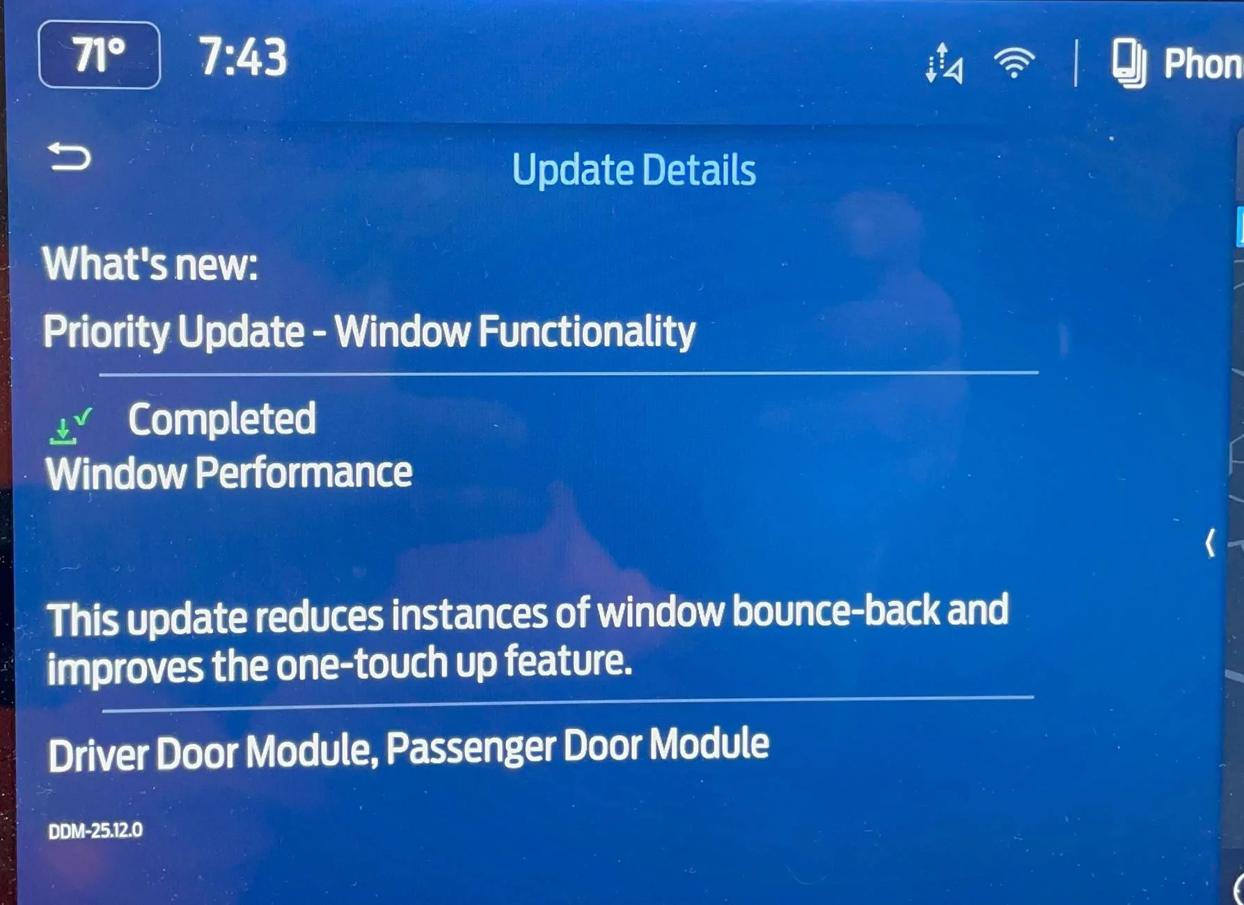

I noticed the same on my 23 XLT ER, but last update was on 04/11/2025 - Windows Functionality Update DDM-25.12.0. Today, app showed error trying to display update, but vehicle still shows DDM-25.12.0.
Might be a Ford mobile app issue:
Are you running 5.17.0, 5.17.1 or the latest 5.18.0?
I'm running 5.17.1 and I can see my last update that posted 4/9/25 as 25.12.0 Window Update.
