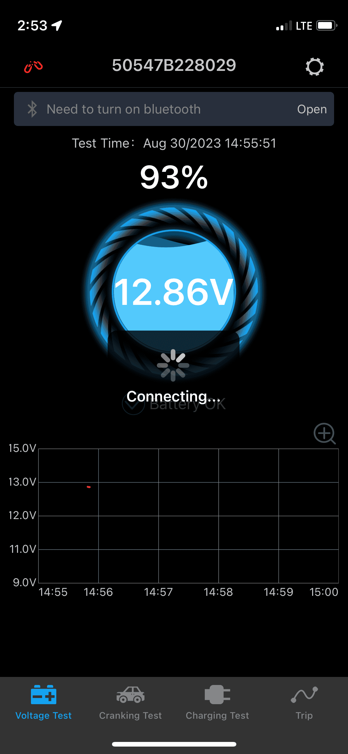

Is there a way to monitor the state of charge on the small battery?
Yes! I have found a battery monitoring system that can be accessed via your phones Bluetooth. However it does take a minuet amount of energy for the BT to operate.
I check it every couple of days if I’m not driving the truck and put a trickle charger on when the SOC drops below about 70%. Or when I know an update is loading that night.
I will look for a link to the one I’ve used, if I can find it.

QUICKLYNKS Auto Battery Monitor... https://www.amazon.com/dp/B01MT4583U?ref=ppx_pop_mob_ap_share

Thank you. I was hoping there was somthing already onboard for that. no setting in sync to see how a battery is doing in a battery powered vehicle? I understand this is not one of the batteries that provide propulsion but it sounds as if it is still an important enough part of the system for the operator to be able to see its SOC. I hear this is the main reason some don’t get their updates. I am told this small battery has to be at 80% for it to update, if that is true how do we know?
This is cool, but a $25 part to install for something the truck already knows but has no UI for is a bit aggravating.
You are correct about its roll. If and until Ford makes it available on the Sync system, this how I managed to monitor it without going the ODBII route.
