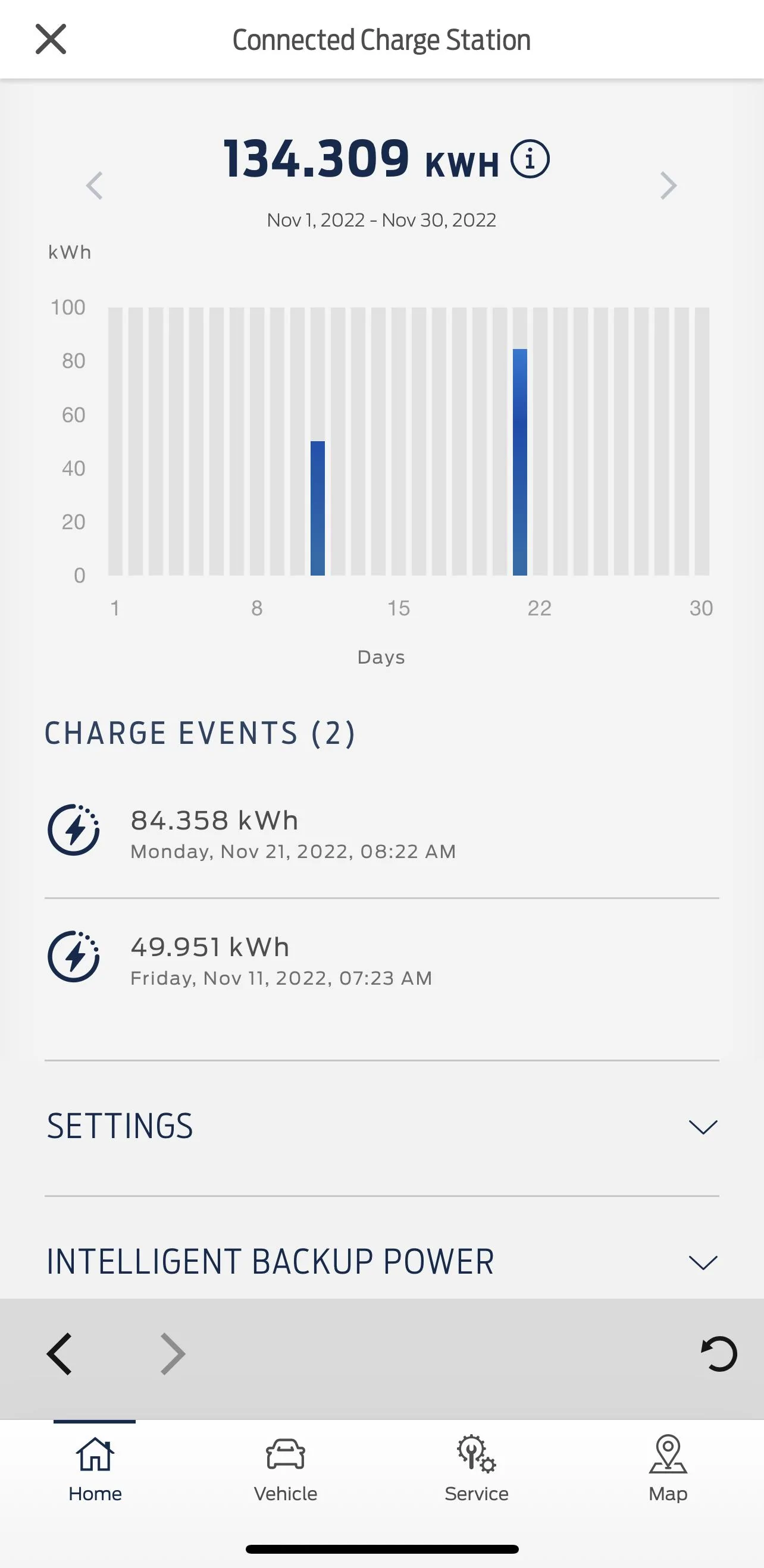

Hey everyone is anyone else having issues with the FCSP not recording Charging data (insights)? I’ve had my charger installed for a month and it only has recorded 2 charging sessions. Super annoying. I have not been able to figure out why those recorded but not every other session. I had even had difficulty connecting to the chargers Wi-Fi at first but with tech support finally emailing me the correct access code got it connected to Wi-Fi and FordPass app.
Yes this isn’t a “BIG” deal. The truck still charges fine. But I think it’s important because then we can show the na sayers or those curious just how cheap this thing is to drive vs ice.

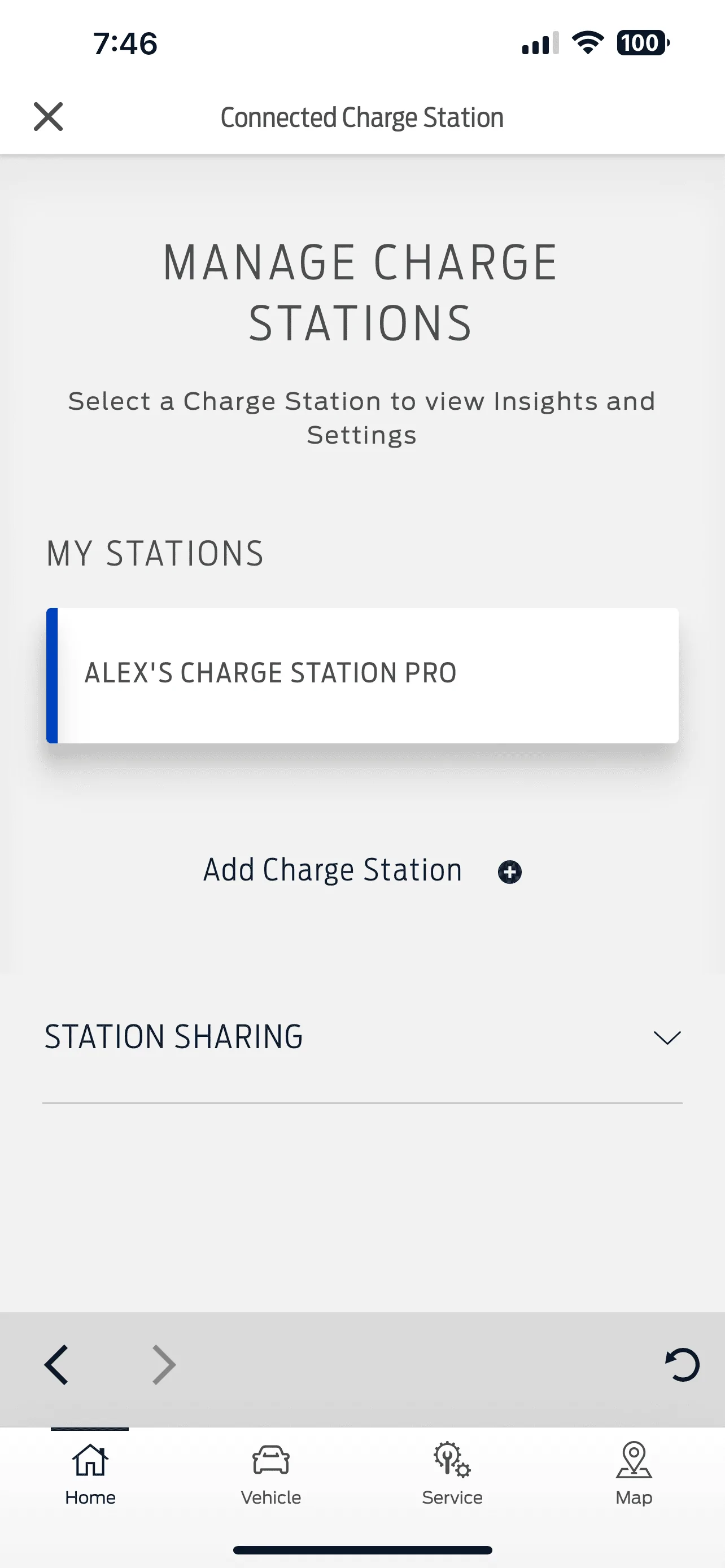

Yes I have redone the setup process through the FCSP setup app and linking it to ford pass. One thing I did find out was if you delete the FCSP app after setting everting up it will mess up the FordPass app. So don’t delete that app after you set up! I reset everything and started again. Still same problems with charging insights.

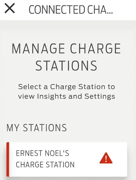

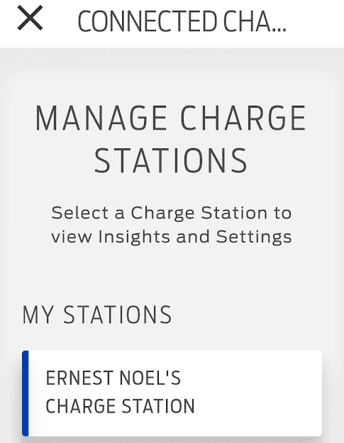

Look to see if you have a red bar and red caution symbol for your station, when I had problems with reporting, I also had this condition, is your similar or shown with a blue bar and no caution symbol?
Not getting charging data--------working after re-cycle of FCSP

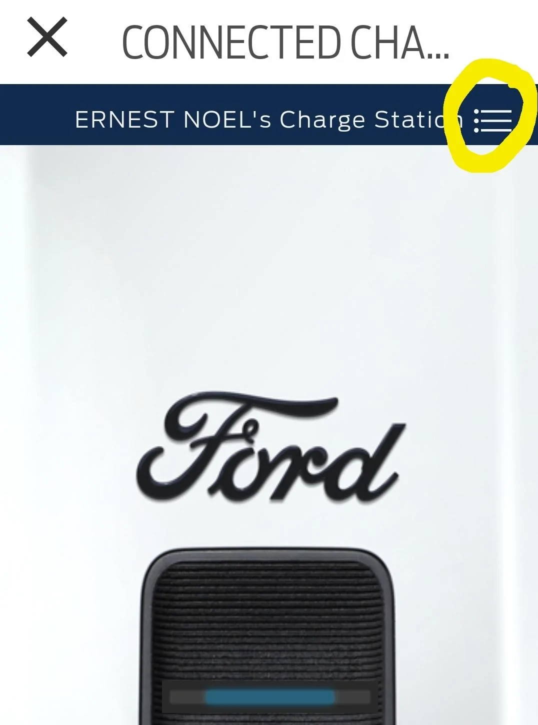

If you connection is correct, then I'm at a loss as to what is happening, make sure all approvals for data sharing are enabled in the truck & Ford pass.

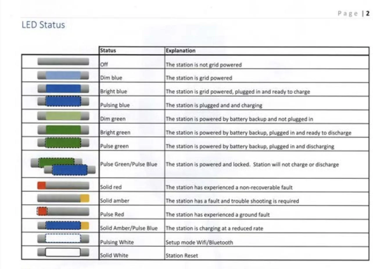

Thanks Taxman! Yea I noticed it did have the red caution symbol one time and so I power cycled it. But it has been blue for the past several weeks. I’ll double check that sharing is enabled on the truck just to make sure. I’ve noticed sometimes my Led on the FCSP is solid white for a minute or so upon unplugging in the morning. That supposedly means it’s resetting itself?? Anyone else have that? It’s only done that about two times.
Several of us including myself have seen it go white for a few minutes, but eventually it goes back to blue while idling waiting for next connection to the truck.
