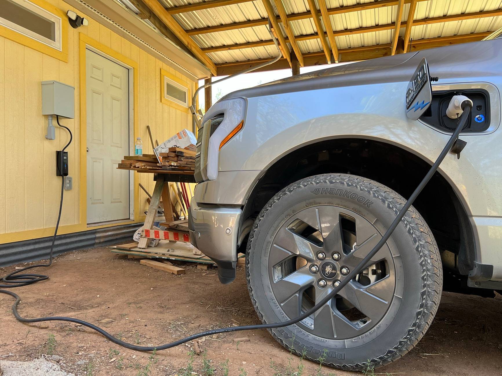

I imagine you have worked this out by now but I'm just now seeing the post. I have an off grid cabin in the middle of nowhere, Texas which has 14.4 K of lithium batteries behind a Magnum inverter (24 volt system). I did set up a 240 v box in my pole barn and bought an aftermarket charger that just plugs into my 2023 Lightning. Doesn't matter how big your array is as much as how big your inverter is. I can only charge at fairly low amperage for that reason but if I'm on an extended stay at the cabin, it is a bonus. Of course, I can only charge during the day lest I drain the battery bank. Bigger battery bank and inverter would certainly help but the system I have was not at all cheap and I did my own construction and install.
Ford F-150 Lightning Using Off Grid Solar System to charge Lightning? Ranch Charger
