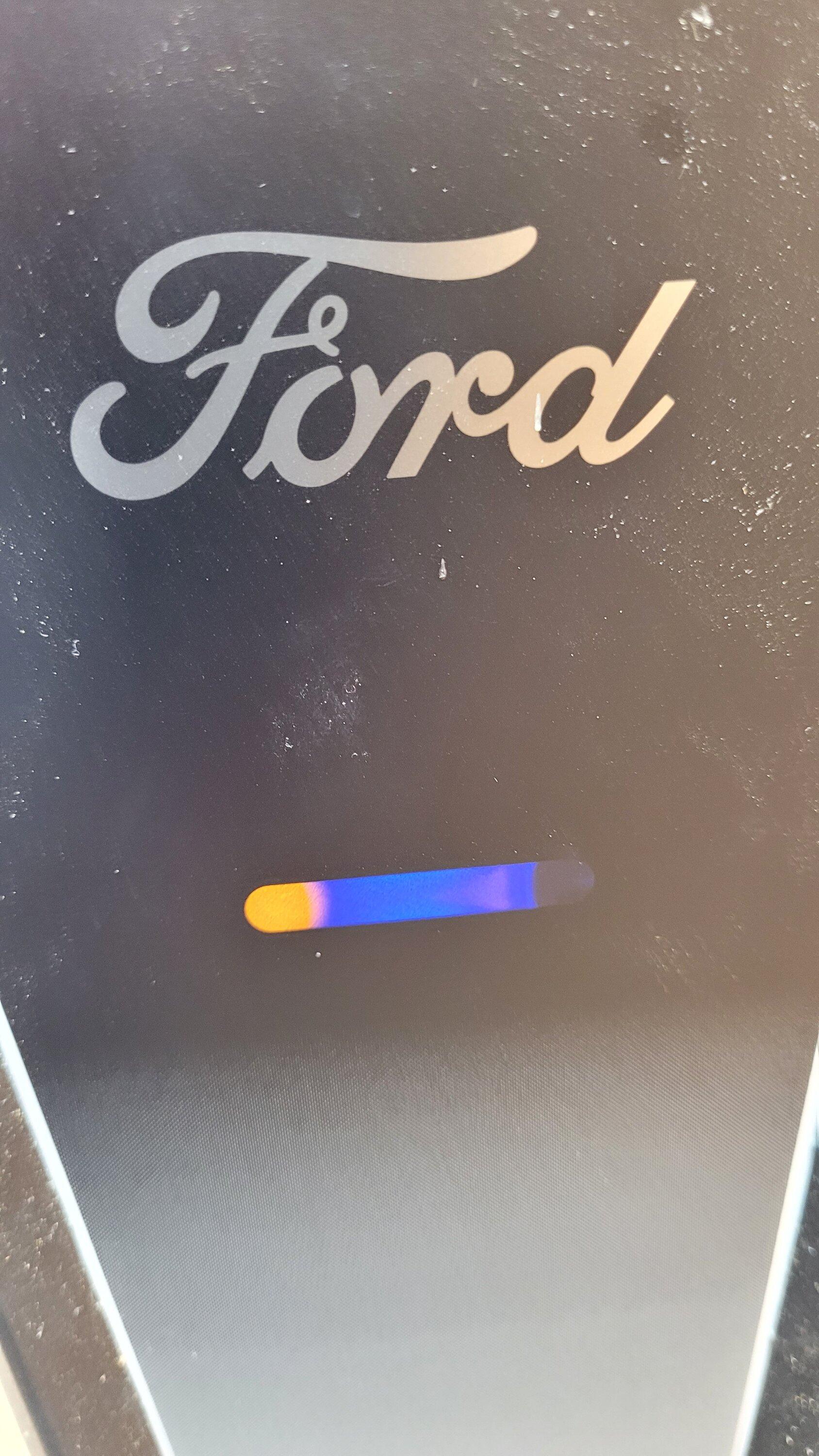

I have been using my Ford mobile charger as home charger for the past year. I always knew that is not what it is designed for but I have a better mobile charger and wanted to get as much use out of this as possible. It has been working fairly well and has been reliable. But lately, it does not hold power consistently (fluctuates between 3 kW and 6 kW). The blue light on the charger has an orange at the end of it now. Unplugging it will temporarily fix the issue but it will quickly go back to the problem state.

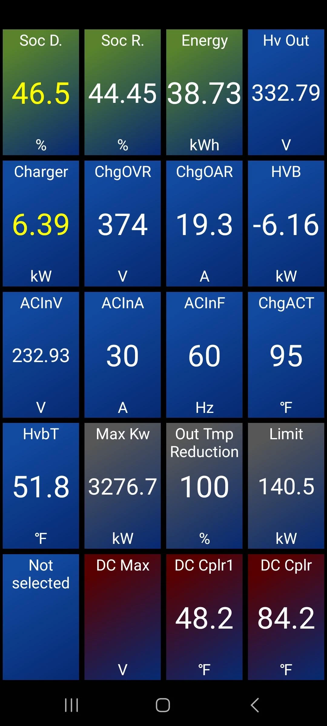

On the truck Charger coupler temp is at 84F. Charging at 60 Hz, 236V. High Voltage module SOC variation is highest I have seen 0.45% but voltage variation is at 0V.
It is still charging this way but much slower. I am not sure the sign wave may have changed and may damage the inverter in the truck. Is the charger dying and time to replace? or there are other things I have to worry about. Any insight is appreciated.
I think orange is suppose to be Voltage and Temp problems. Voltage is noted and nothing feels hot to the touch.

This is first when everything is fine and before HVB power drops.

MachE owner's manual. The link explains what the lights mean. If it's in a constant error state I'd suggest calling your dealer so they can test and replace it under warranty.
Thanks. It seems like it is this case:
Ford F-150 Lightning Last gasp for my Ford mobile charger ? 1706890938611
However it is 42F outside so I am guessing a component is going bad inside the charger that is causing overheating (not noticeable by touching the charger).
