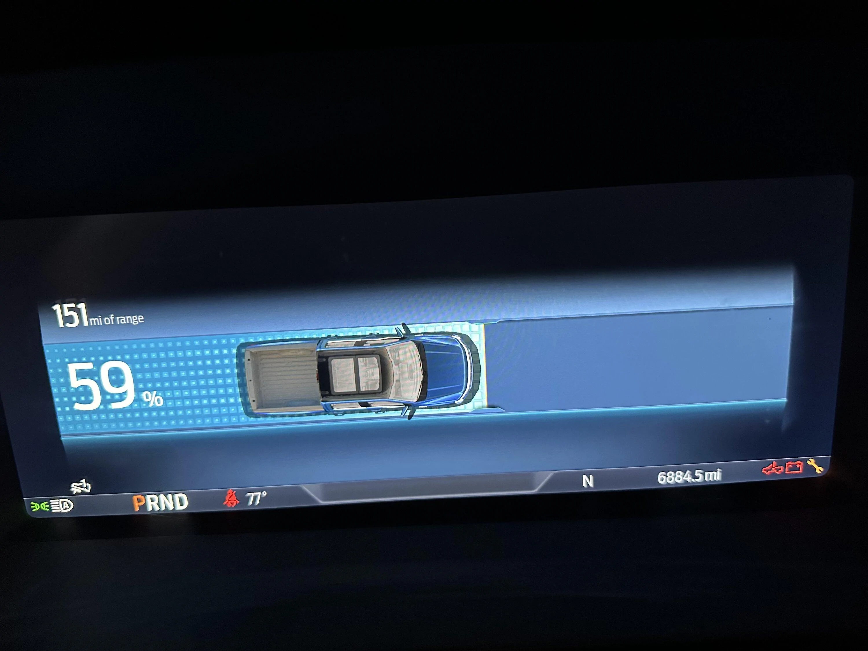

I picked it up a week ago from dealer after CAS battery module replacement. It was at dealer for 4 weeks. . Drove it 3 hours back from Paso Robles to NorCal. Parked it, plugged it in, made sure it was charging, and then went to London for a week. I came back put all of our food, chairs, and supplies for an all day kids swim meet into the bed (with tonneau cover). When I went to turn it on all mayhem broke out. Beeps, warnings, faults, screen wacky, speakers going bump bump bump. It said it was 59% charged. I plugged it back into the wall and even then it was clicking on and off and the ford wall charger was going blue/white. Worst thing was the tailgate wouldn’t open and there is no manual release. With the tonneau cover in place I couldn’t access anything. My wife was pissed. Daughter crying. They left in the Tesla with no supplies to go to the swim meet.

Enter truck, press start. Shows 59%
Faults go crazy. I can’t remember them all but kept clicking OK on them. Big screen says going to sleep to save battery.

Powers back on but fault a palooza again.
I try to initiate immediate charging but nothing happens.
It is odd that only 2 of 5 bars show light up on the charge port but screen says 59%. Last time there was a mismatch was when my HV modules were replaced for the CAS/recall.

It doesn’t seem to be the 12v …. I trickle charged it and it is reading full voltage. Everything is more or less operating with the 12v. I disconnected black for an hour and reconnected. However it still faults at start up with the red battery, wrench, etc. also the frunk and lift gate are acting weird. The lift gate keeps beeping and opening every time I close it. Grrr. It doesn’t fit into my garage with the lift gate open. What a pile of junk.
I am frankly scared to have this thing in my garage given it was made around the time of the factory fires and it is acting so damn weird. I am getting it towed tomorrow.
