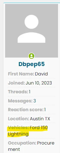

Later you noted that the truck is always plugged in, does you charging scheme have limits for SOC ie. 85, 90% and do you have limited times frames when charging is allowed? ie. overnight hours that stop prior to commencement of the departure time frames?
What is your most recent software update on the Sync screen?
What year is your Lightning?
Helps to update forum vehicle profile so we have a better understanding of age.
