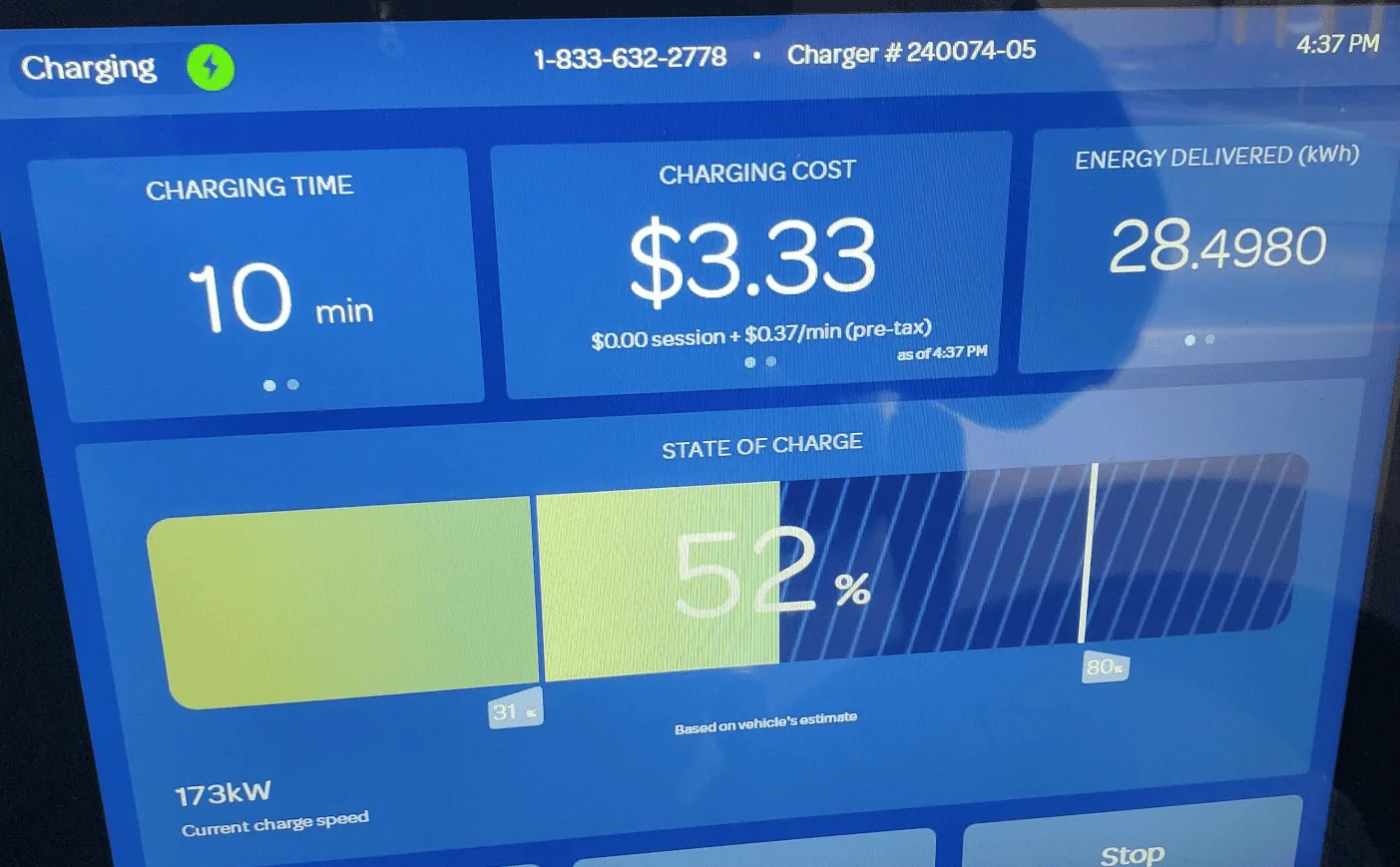

I got an impressive 173KW on the EA-350KW machine last Sunday, much better than I was getting on 150KW systems which were averaging 110-125KW

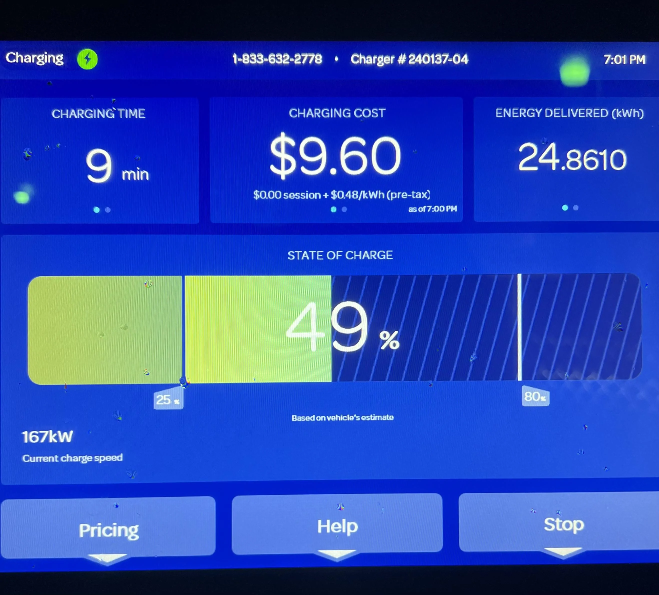

My 2023 SR, maintaining 167kW at EA 350kW charger (it takes the 500A capability of the 350s to maintain 167kW on our Lightnings).
I'm quoting Ford's average (not peak) from 15-85% (remember charge drops off significantly at 80%). But that's still impressive for a SR (or even an ER).

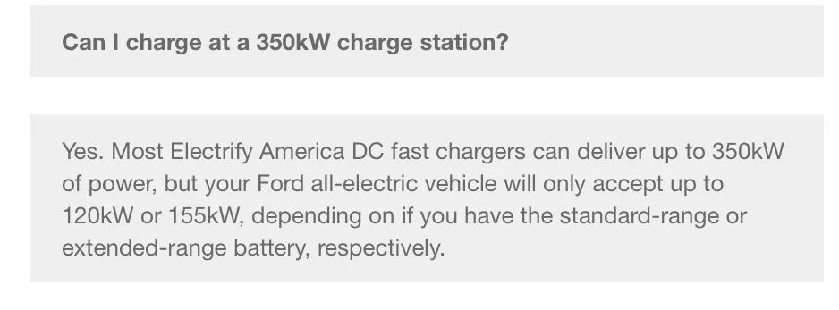

This does not look like a typo. I wonder if 24s have a different battery chemistry.
I also wonder why they only mention Electrify America specifically. Don't other providers also have 350 kW+ chargers?
See post #4.
IMO I think it’s just a holdover from the original FAQ (preserved here). EA was front and center early on with the free kWh. Maybe lazy FAQ’ing?

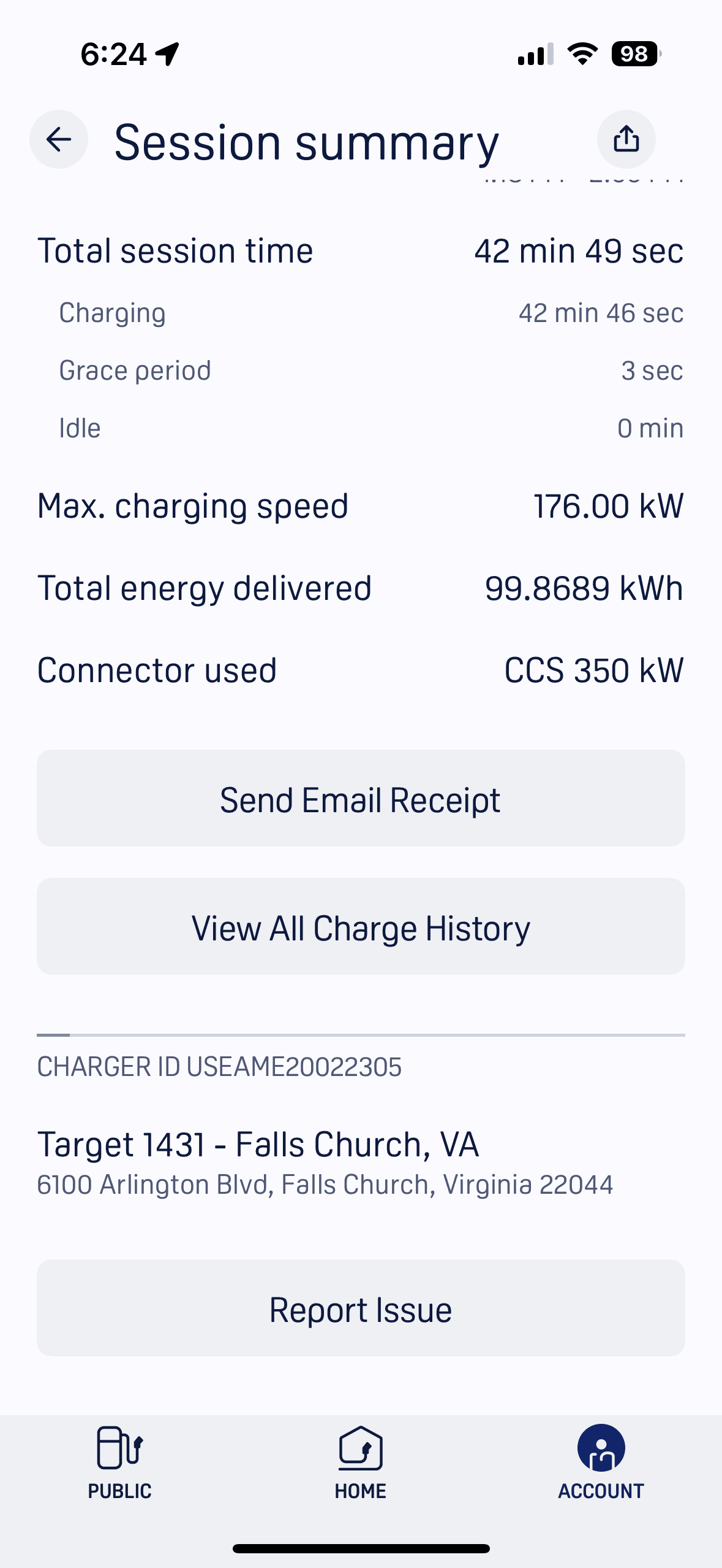

176kW peak for me.

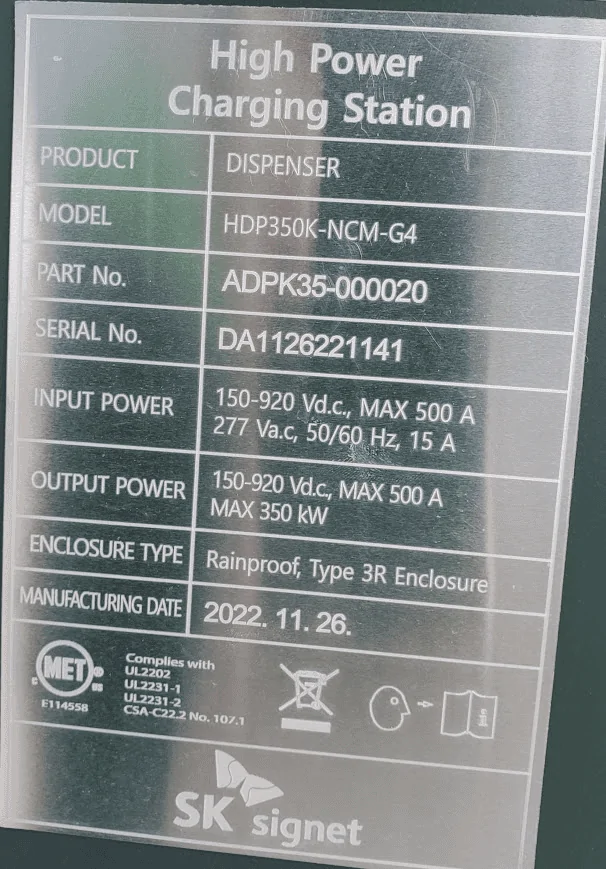

Our limits are from the amperage, which is why the peaks are much lower on the 150kW charger, my peak on a 150kW charger is around 127kW.
IIRC the 150kW outputs 350a max and the 350kW outputs 450A. So 350A*400V=140kW max vs 450A*400V=180kW max. (Assuming the onboard chargers support it)

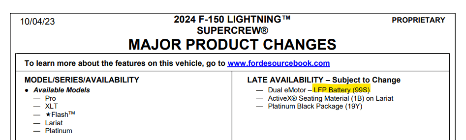

Didn't the 2024 SR Lightnings switch to LFP batteries? If so, I suspect that is the reason, those tend to charge slower.
I may be wrong, but I think it's later in this year for the LFP?
