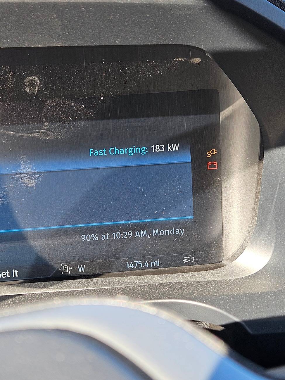

2024 Lariat ER. Confirmed 183kW peak at Tesla charger with A2Z adapter. Stayed above 175kW for at least 8min. Was mid 50s temp outside.
35% to 77% in 23min. 58kWh added. Average 151kW charge rate. Pretty good for a 400V battery!
I have not been able to get above 120kW at any other chargers. Blink, EA, EV Connect, etc.

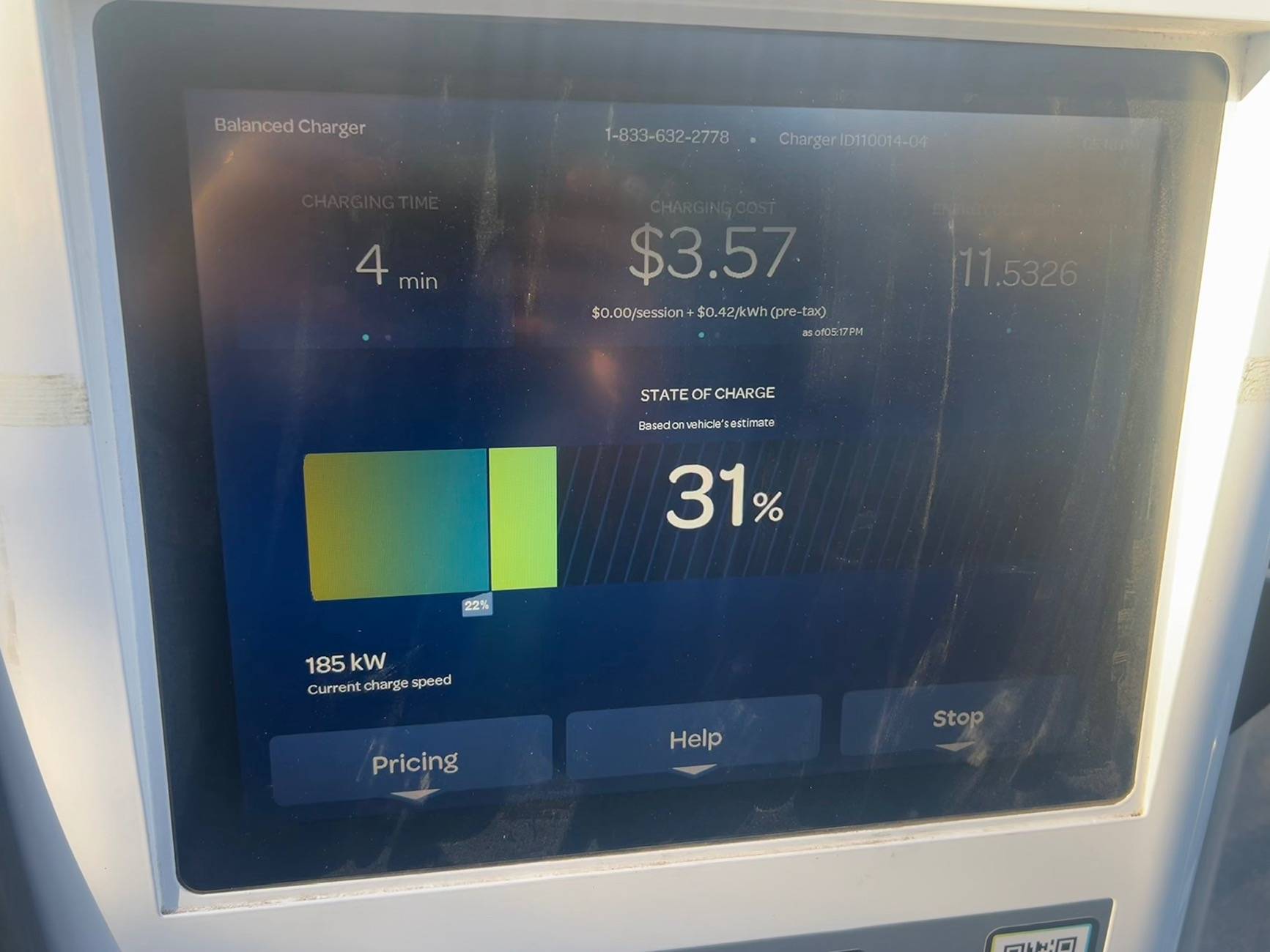

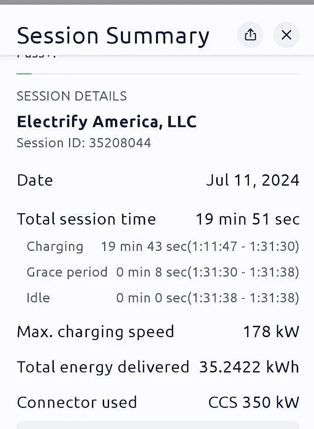

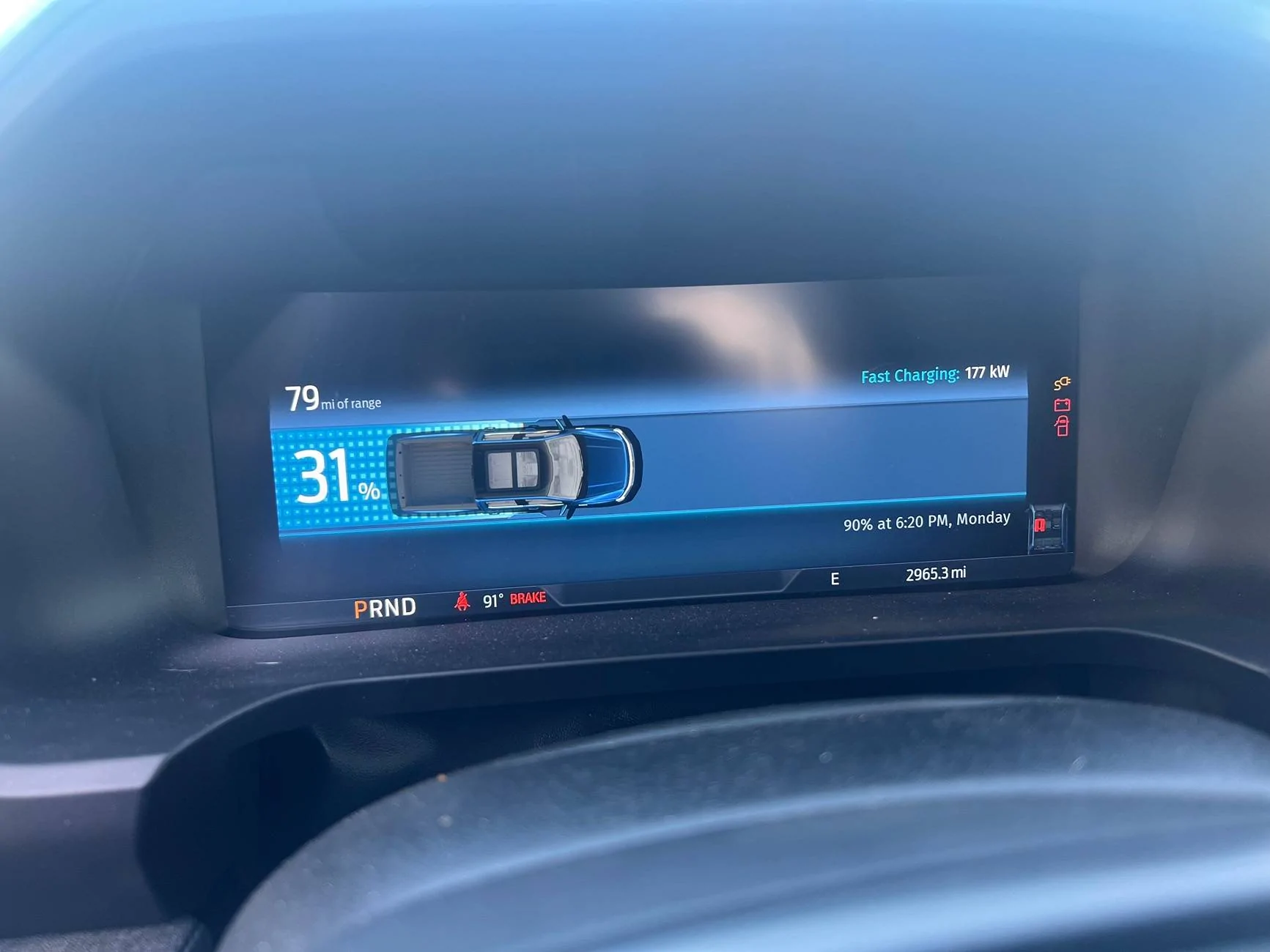

Not sure who where why people think 2024 cant charge over 120 KW
2024 lariat EA charger since I go out of my way to not use trashla chargers. 185 KW at dispenser for 9 mins and 177KW at truck in 105 weather then Dropped to 130-140 for 20 min charge and got 50 KW on 20 mins quick charge.

Based on some of the posts here I was slightly worried they changed something in the 2024s. Doesn't appear to be the case for DCFC.
Of course the onboard level 2 is now capped at 48A, but that's plenty. Saves some money on the install and no 80A FOMO.

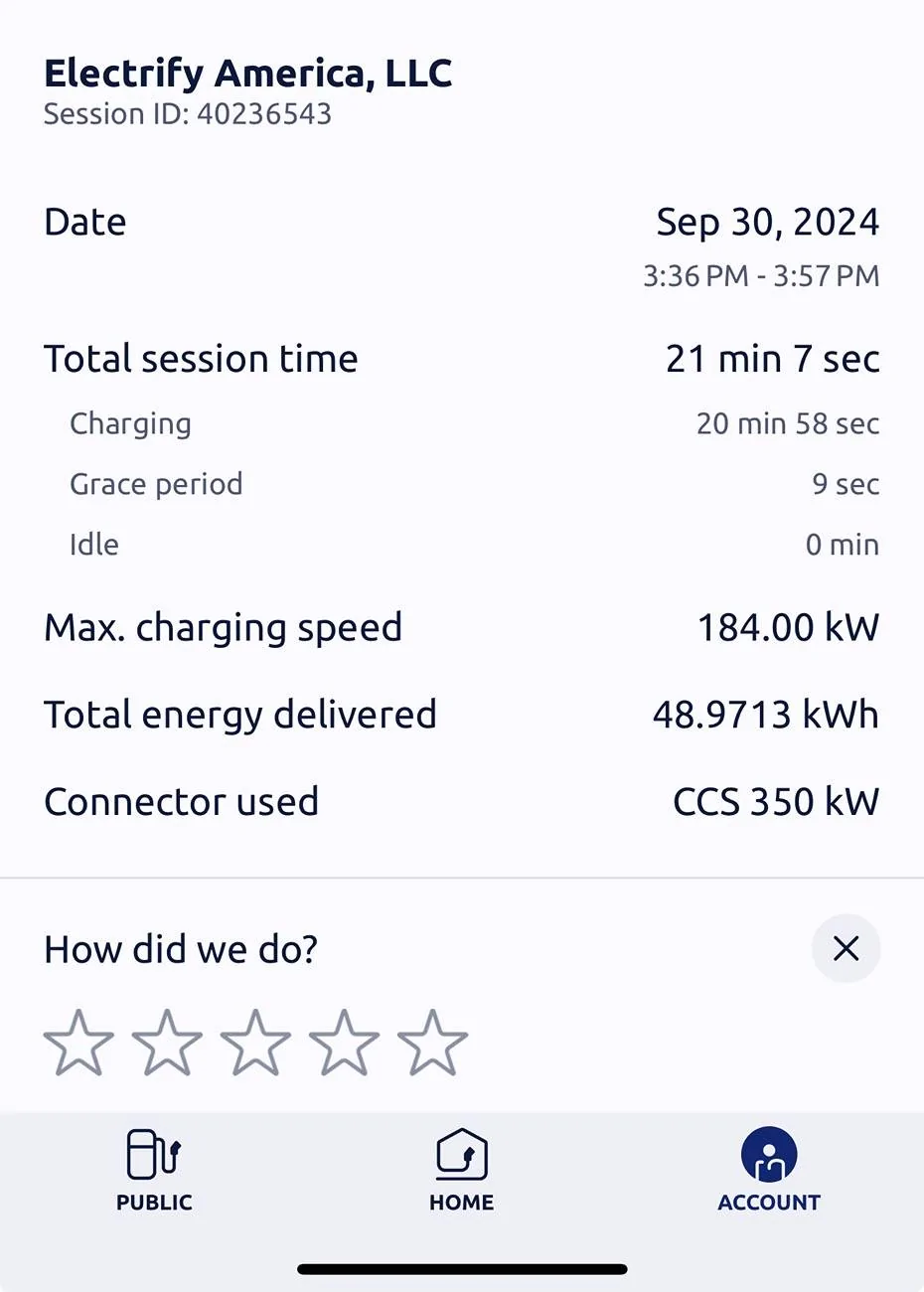

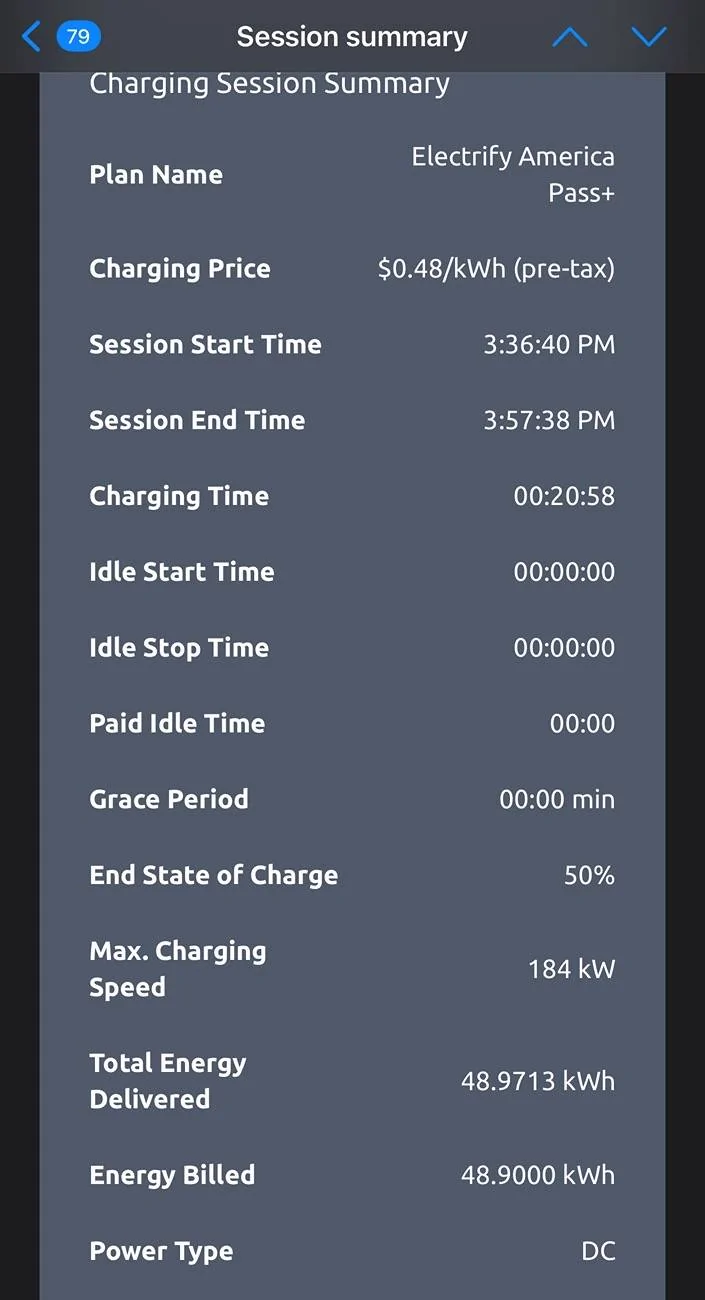

Electrify America 350KW cabinets are the target of this Ford restriction, I don't have one of those nearby to confirm, and couldn't anyway since I'm driving a 2022.
Were you at a 350KW site???
Yes, 350 kW dispenser work just fine in California in Lemoore

I think back when I started this thread, Ford incorrectly updated the website, then later caught the issue (perhaps because of this thread), and removed the erroneous information.
