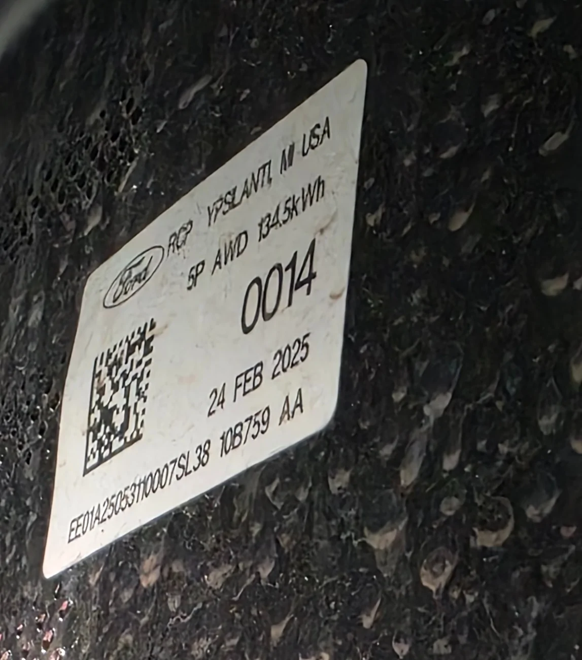

There's been reports from users that regularly charge to 100% on these trucks for hundreds of thousands of miles with no ill effects. Since Ford precalculated usable battery size and SOC, there's less on the table for what's known in the industry as "CYA"
Example using my own truck specs, it's listed as having a 123kWh battery yet the sticker clearly shows it to be quite a bit higher at 134.5kWh. My bet is they balanced this out beforehand to as mentioned, CYA, so that when we charge to 100%, we're actually only charging it to 90-95% (cya buffer).
It's easier to understand in terms of hp for an ice vehicle, every gear head knows Ford leaves a lot of power off the table to (CYA) their engines from rapid unscheduled disassembly. Introduce custom tuning.
I don't know of any way to get more power from these ev platforms however, charging to 100% daily should not be an issue.

A small correction. Your 2025 Flash has usable capacity of 123 kWh and nameplate capacity of about 134.4 (not 142.1). The Owners manual reference is to the original 131 kWh battery. Notice it also states 480 cells. That is the 131 kWh ER battery. Your battery has only 450 cells. Thus your nameplate is around 134.4. I explained it here. And a few posts down, a user shows how you can see your battery nameplate.
You still have roughly the same percentage buffer (~9%) as the ER and SR packs so those points are valid. FYI, no one has posted the nameplate of the 123 kWh battery so it would be cool if you could. We have nameplate pics of the other two battery capacities.

Kewl beans, I guess Ford hasn't made the revision to the online manual yet (Fordposs), updated other post to show this factoid. Grabbed my creeper and snagged a pic.
