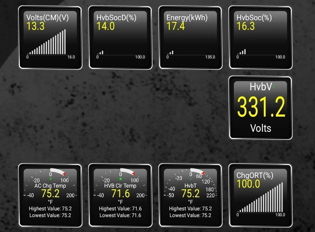

after a 35mph white knuckle drive 20 miles down the freeway this is my situation when I got the Tesla SC . (white knuckle because I was so close to not making it.)
Ford F-150 Lightning 5% battery, 10kwh Athens tx 14%

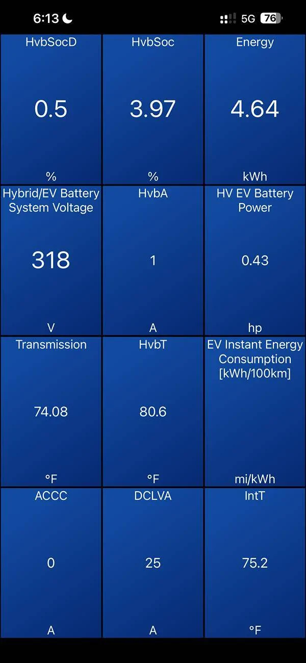

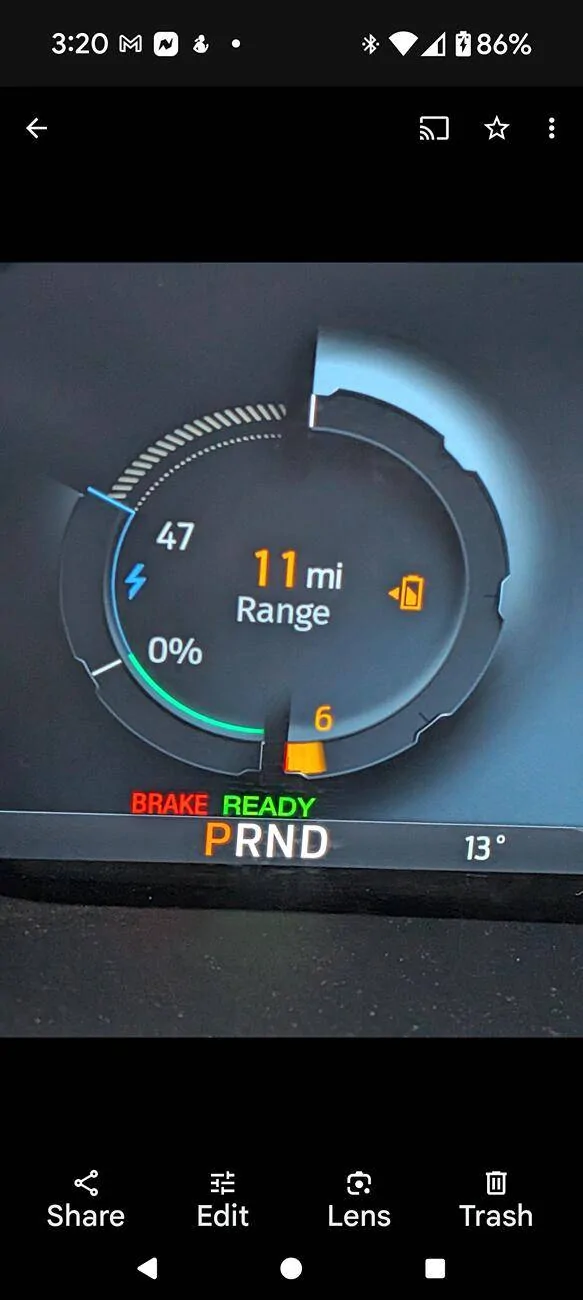

Ford F-150 Lightning 5% battery, 10kwh IMG_9911
Ford F-150 Lightning 5% battery, 10kwh IMG_9904
My 24 Flash ran perfectly over the entire battery range from 100% - 0% indicated.
At 0% on the dash Car Scanner shows 0.5% displayed and 3.97% actual with 4.64 kWh remaining in the pack. This was after letting it sit for a few hours (intentionally let it rest before recharging for BECM calibration).

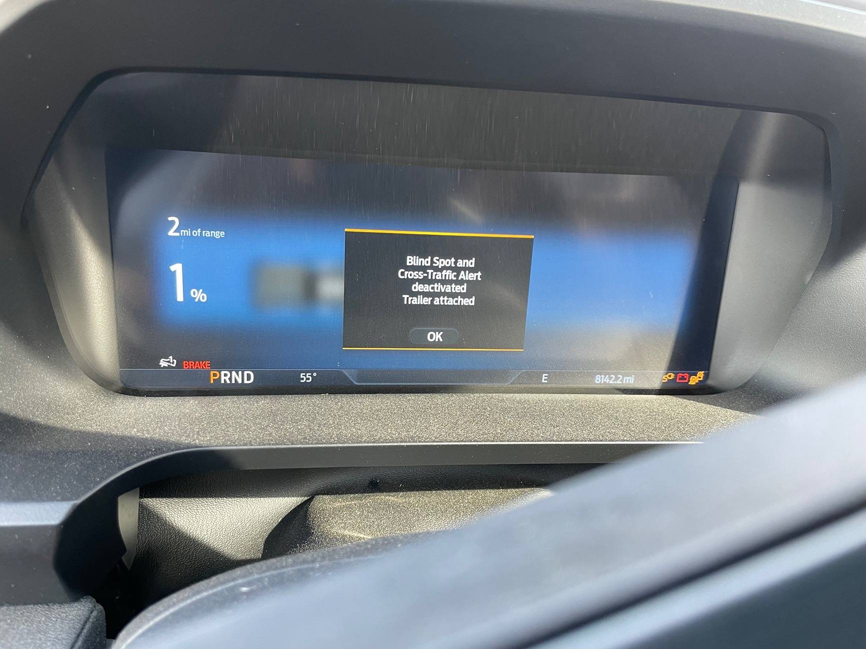

Comes out to around 1.24kWh per 1%.
When I charged back to 100%, I think it was around 128kWh.
Close enough that I'll call it good for 40k miles.
Ford F-150 Lightning 5% battery, 10kwh 1750648568126-q7

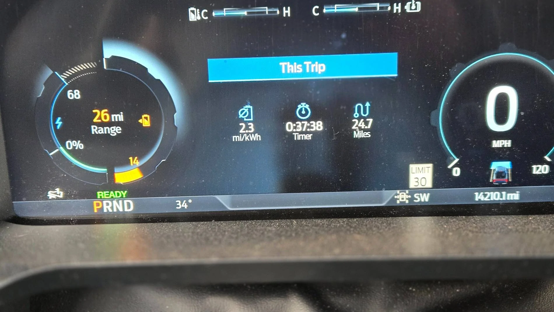

Not by choice. Charger was out out of service 20 miles before destination. It was about 10 degrees out ..pucker Factor the balance of the way.
Ford F-150 Lightning 5% battery, 10kwh Screenshot_20250623-152013
