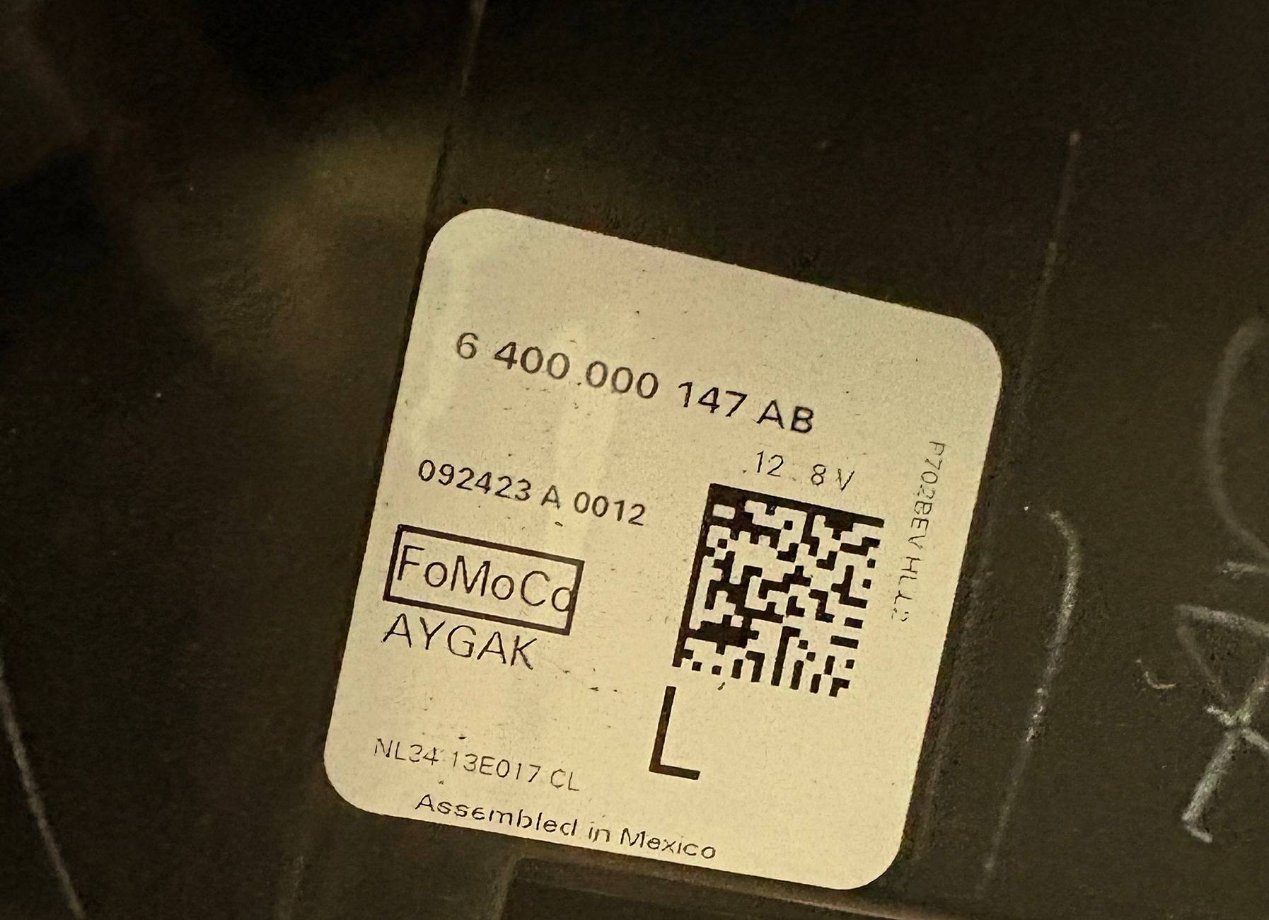

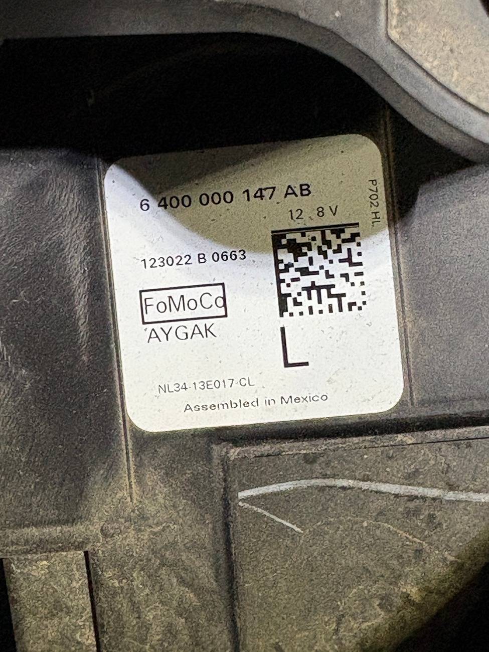

Can you see any part number tags on both old and new light modules that we can cross patch at tascaparts.com?
