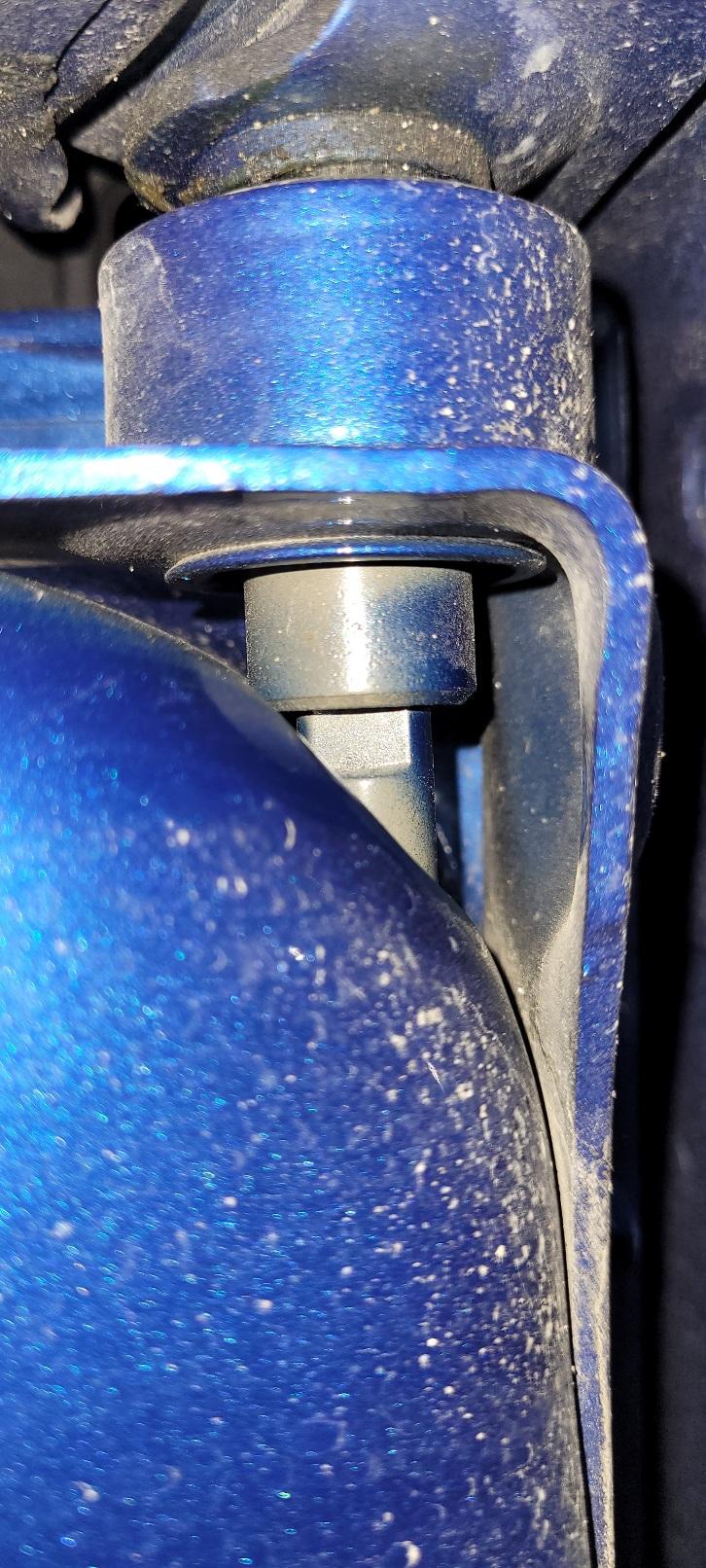

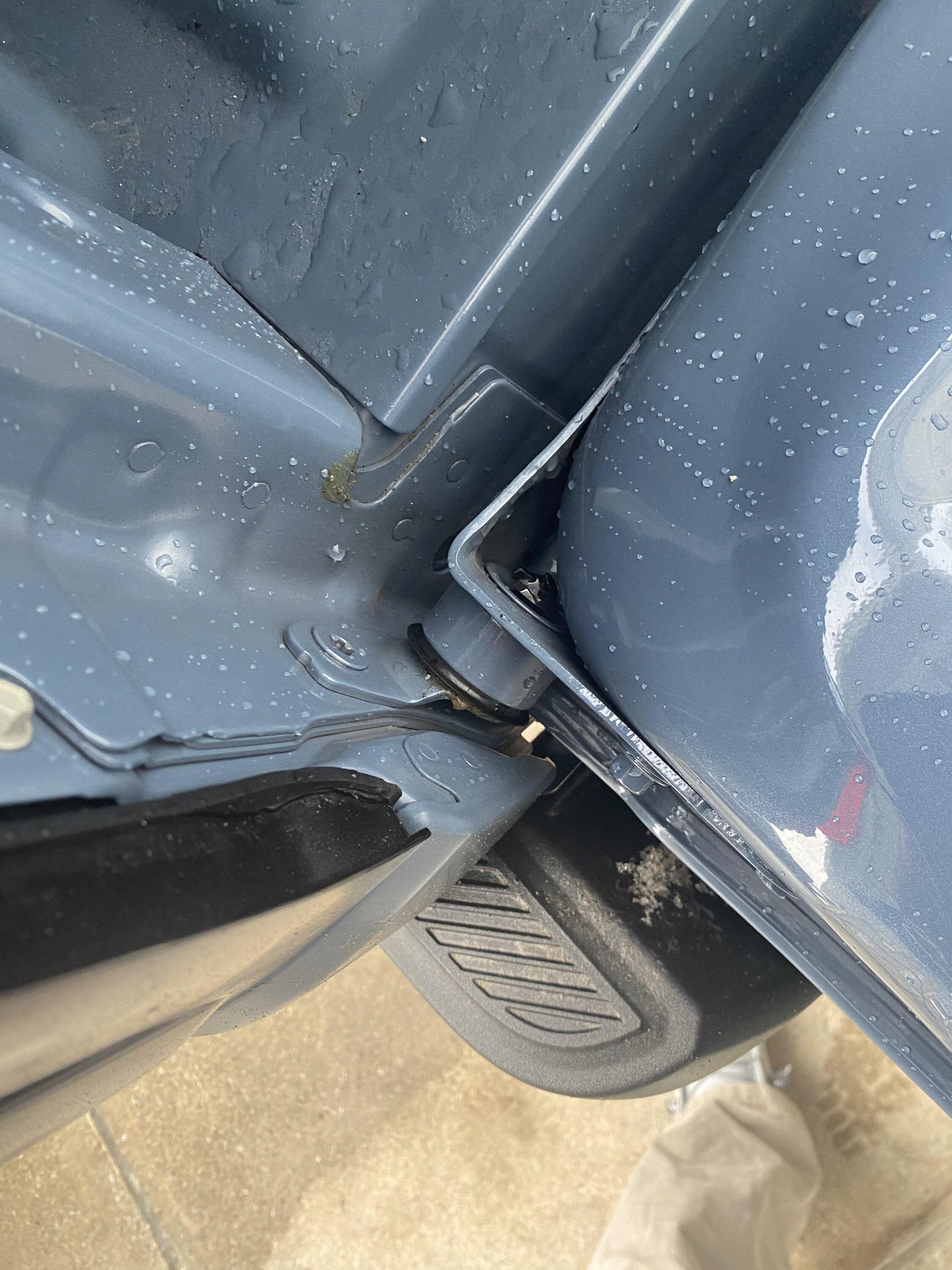

I do not have the built in step. I had it listed on my build and it seems like the tailgate is lighter then normal. Here is a few pictures of my hinges
If you had a torsion bar, you would see it in this picture. Your tailgate is light because it doesn't have all the internal bracing for the step mechanism.
I have the motorized tailgate, but this picture should give you an idea of what to look for if you had a torsion rod. This is the driver's side hinge.

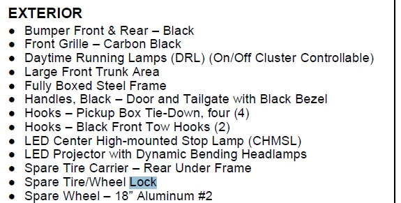

I, too, don't have a key lock on my spare.
Not sure if it was a change between 2022 and 2023, but this is in the 2023 order guide as Standard Equipment for the Pro, which is also supposed to be included on all higher trim levels.

It’s definitely missing. There are no torsion bars on any of our trucks as @Pioneer74 has mentioned/shown. Also when I lift my tailgate I can tell there there is nothing that’s helping in anyway.
Yep. Put my Lightning side by side with my buddy’s 2020 with tailgate assist. It is not on the truck. No torsion rod present. Tailgates weight the exact same except his gently glides down and mine goes boom…bump..bump. Something is not right, they left it off the build. I am sure of it.
Up is "assist". That is the torsion rod. This is impossible to add to base tailgates.
Down is "dampening". That is the cylinder in the passenger side "D" pillar. This can be added after the fact.

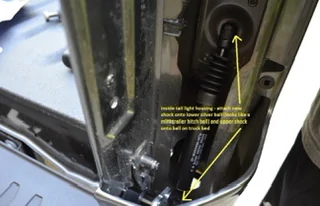

This is what should be there….Tailgate assist dampener. OEM Ford part. Listed on window. It ain’t on my truck

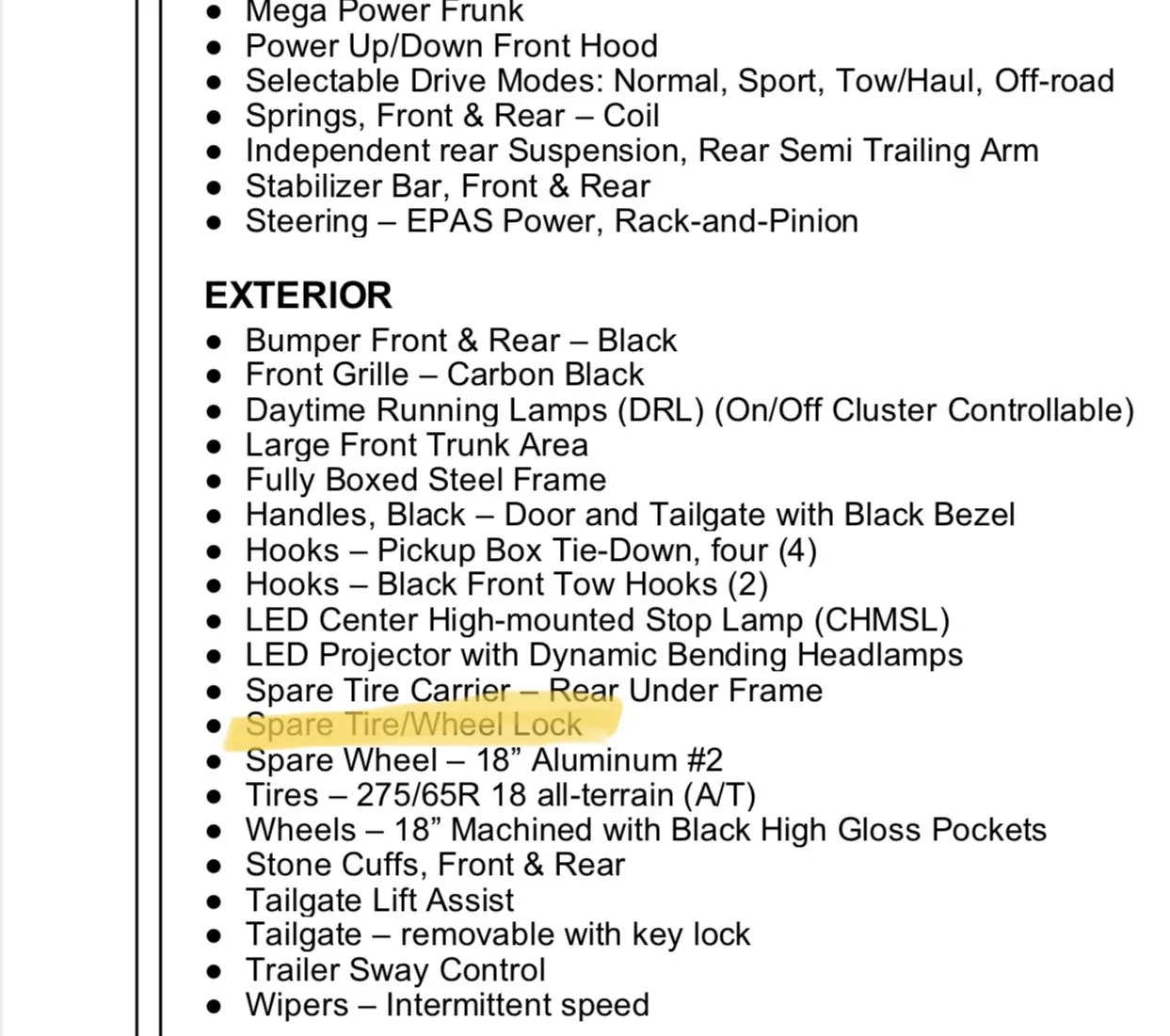

Tailgate assist is not missing. As described here by others, it is just a super vague crappy description of a device that assists in lifting the tailgate and making it easier to close. Having accidentally dropped the unhinged tailgate on my finger I can assure you it works.
I, too, don't have a key lock on my spare. However, I didn't see anywhere that said it would be included...just the assumption it should be there because it was included (and not listed) on past Model Years.
It’s actually called out on the order guide under standard equipment at the Pro level. It should be on every Lightning. I didn’t fight the cargo net but this is a feature that should definitely be there.
That's a different option. Tailgate assist is just that, a tailgate assist to make it lighter when lifting. The tailgate dampener pictured here is a different option/feature. I installed the dampener after picking up my truck and it makes it lower slowly, but does not assist in making it lighter when lifting.
