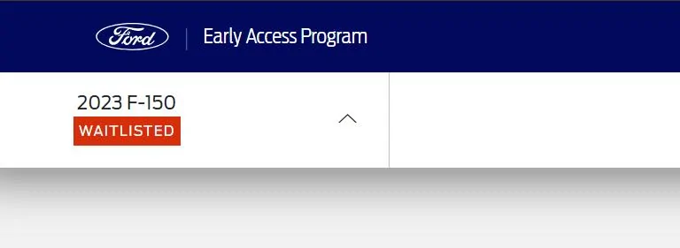

I applied for it but haven’t been notified I’m accepted.
233
16,536
18,654
I looked at your recent posts, you mentioned a stalled / incomplete download of this in the main thread, sounds like you might be in the EAP and not know it, spam folders?????

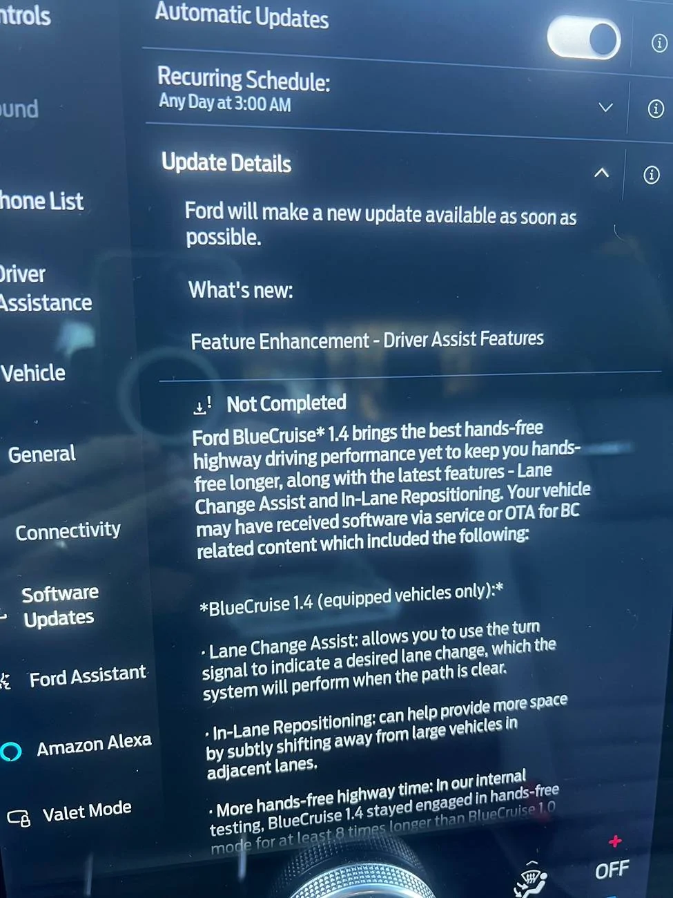

Ford F-150 Lightning Anyone else still w/o BC 1.4? IMG_2519

TIPS to get past failed installs:
Make sure your 12v battery is fully charged.
Truck is far enough away from Fordpass and key fobs so the truck isn't interrupted.

Battery was low. Stupid me I left it in accessory mode with power down timer disabled. Correct move would have been to leave car running as that should charge battery. I’m recharging the 12V battery with external charger for now.
I don't think that is what happened in your case. When an OTA trigger is activated for an update that requires the vehicle to be inhibited, it has a 30 day timer to install before the update times out on the server. We assume this is done to allow the update plenty of chances to install in case the parameters for the 12v battery are not being met. Unless this update has been trying to install for a month and now it says "not complete", then it failed due to something else. Message me the VIN and I can check, but either way, "not complete" means there is nothing you can do it about it now regardless of the reason it failed.
