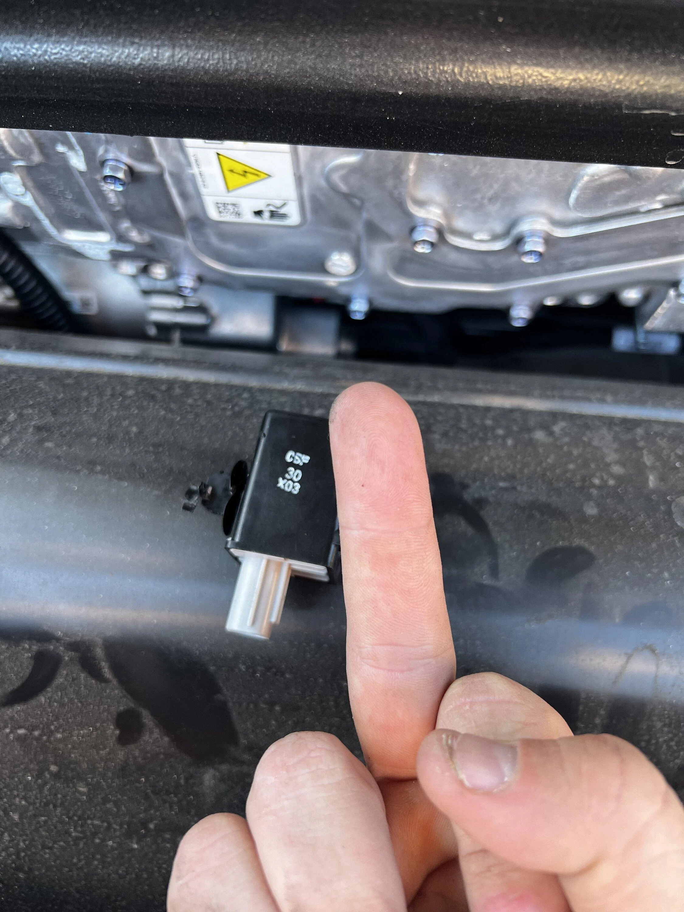

Anyone figured out how to turn off the frunk beeping yet?
2,886
4,099
Has anybody that removed it checked for a new DTC using an OBDII reader or Forscan? While it may not throw a dash code, might still set a DTC (not that is necessarily an issue).
Looks like a variation of this part (Densco MX068900) has been used in Honda and Subaru keyless entry alerts for many years.

I don’t have a picture of mine. It is zip stripped to the wiring harness and labeled. Thank you for the tutorial @WillB17 . It took me about an hour, but I think I could do it in 20 minutes the second time. That’s the way these things go. Ordering your backup silencer.

In case anyone else is running into this issue. My frunk wouldn’t close after the install, but figures out I had to manually close the frunk and then it would latch when it’s closed. The frunk worked perfectly after that.
The only thing I can imagine is that when harness was disconnected on frunk tub the frunk module resets and defaults to think it’s closed position when you reconnect power. But just manually close it and it will work fine afterwards.
