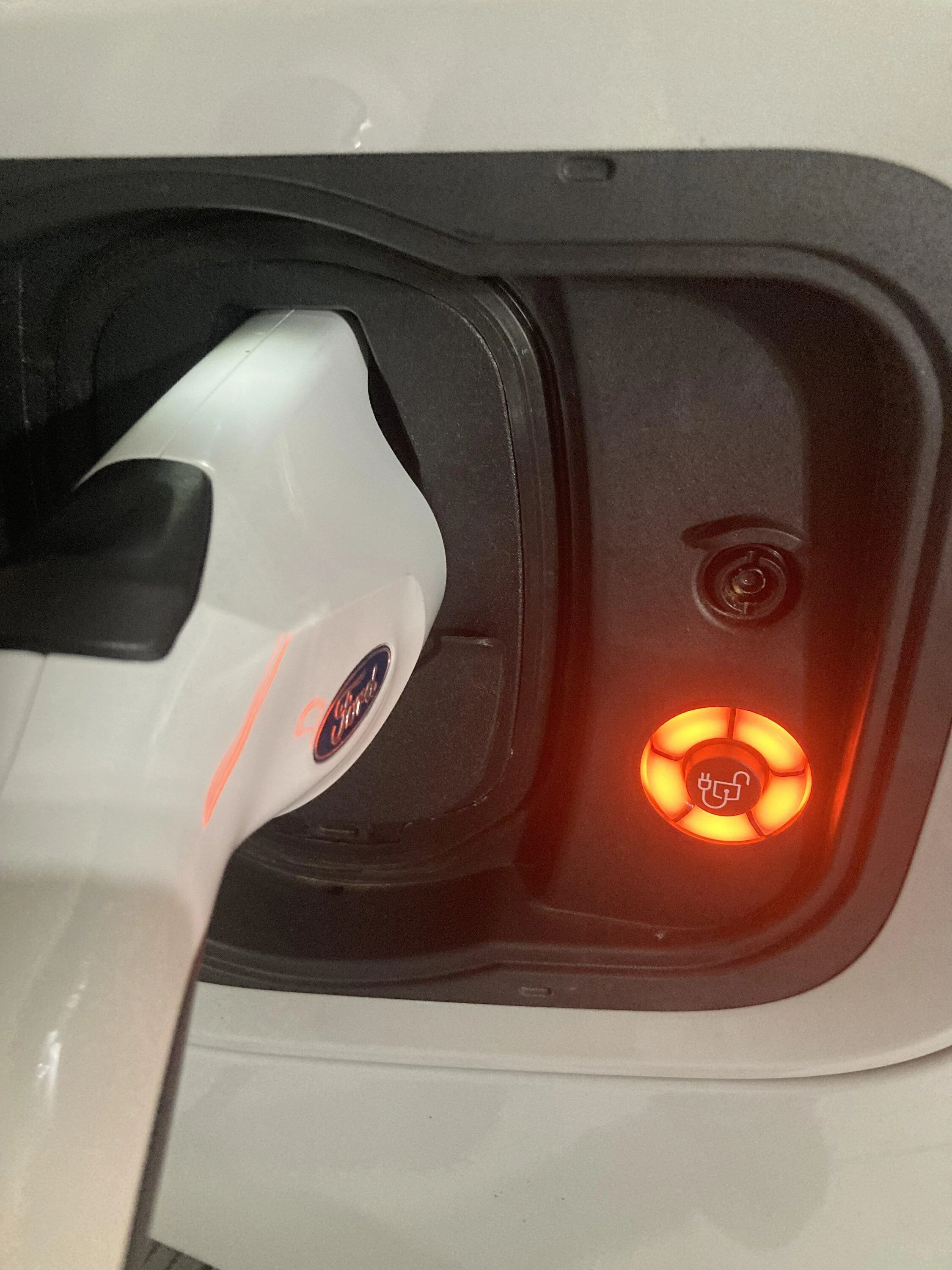

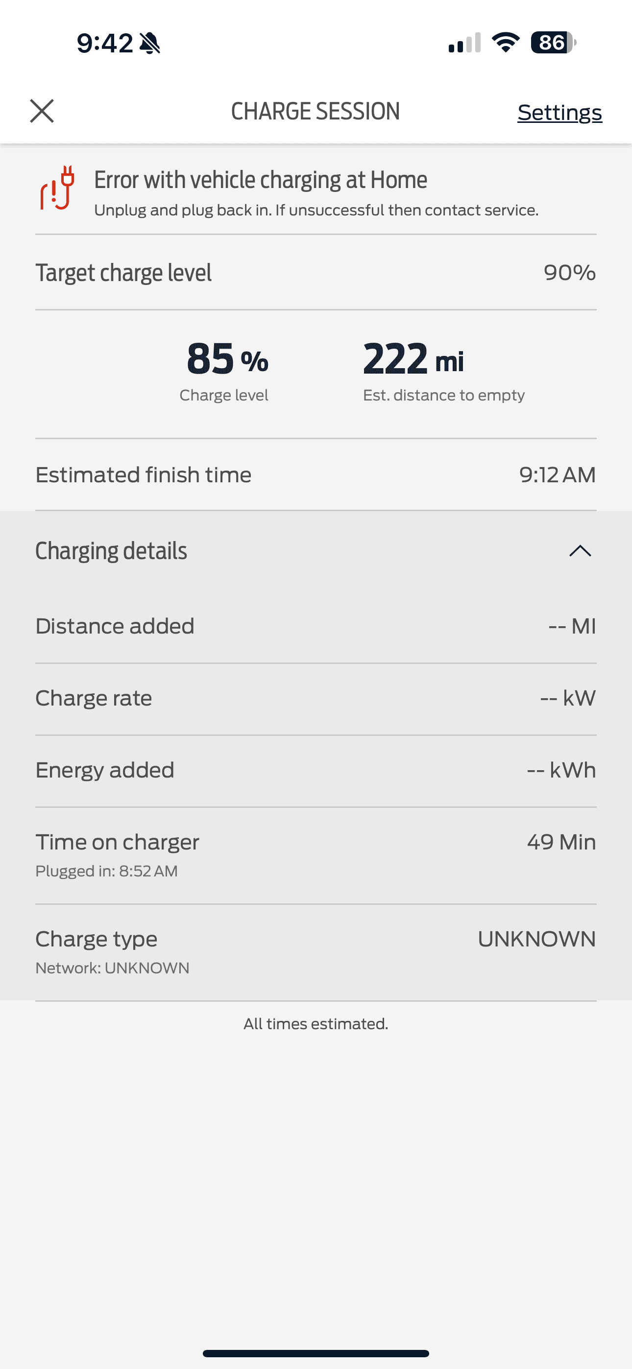

Just got my truck back after the 23B57 update and diagnostic. I’m at 57% reduced power and the yellow wrench icon. Dealership to get back to me in next day or two in parts timeline.
So now I’m home and plugged and unable to charge. Red charge light ring and message of Vehicle charging fault.
No idea on a quick fix but will be calling dealership tomorrow asap. beyond frustrated.
Thanks for nothing…We need your team to get this resolved ASAP #FordMotorCompany https://x.com/Ford?s=20 TIA

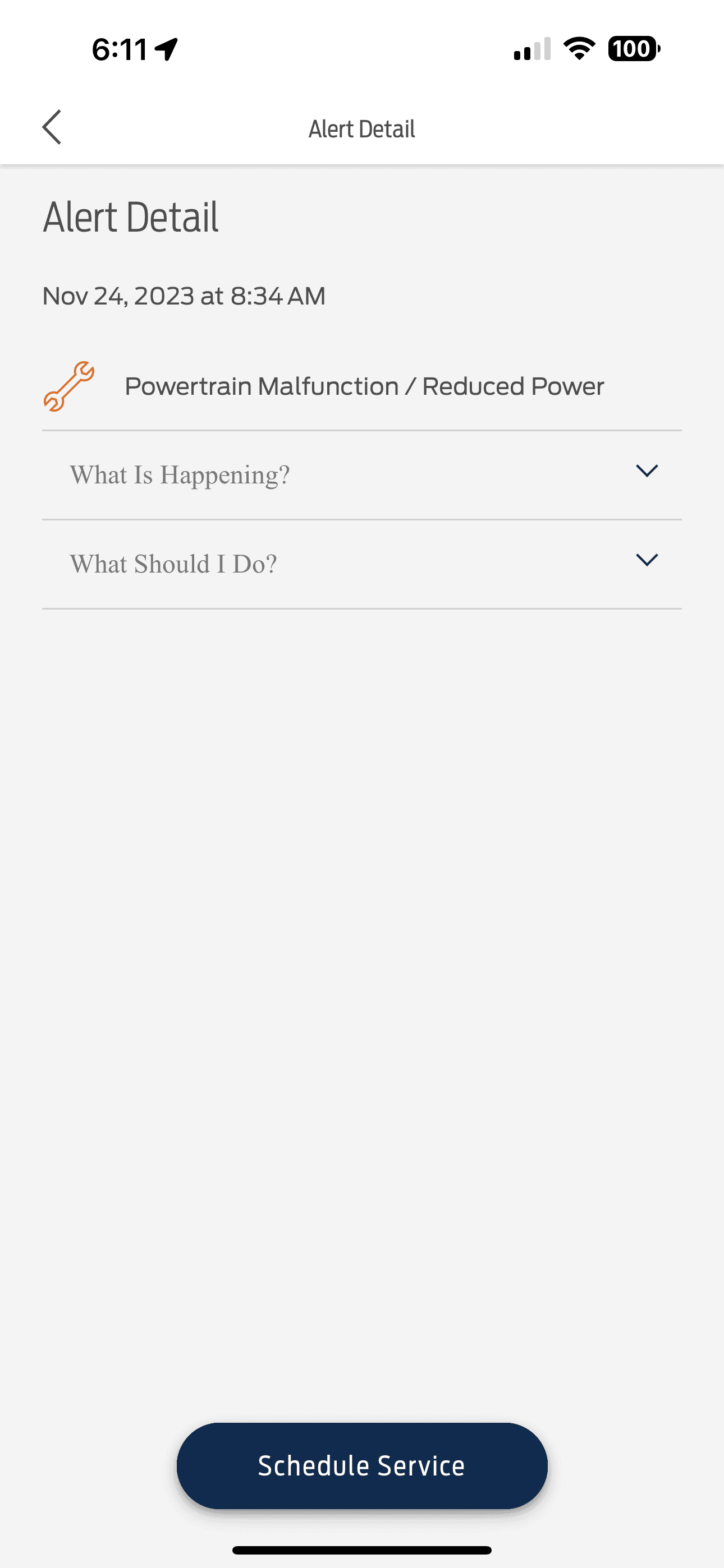

Much like @ScubaSteve_TheReal and @tkittlitz I received the 23b57 software update on Nov 6th. A few weeks of normal driving and then on 11/24 I got the orange ring of death, the truck would not longer charge, the service soon indicator was on and I had the powertrain malfunction/reduced power error. It took until 11/29 to get it into the dealer (already scheduled since they failed to order parts for the lightbar and dash mat recalls). They updated the BECM software again (same as action taken on 11/6/23) and sent it back to me only to have the error immediately repeat! It took until 12/4/23 to get the truck in again for service and on 12/6/23 I was told that module 7 needs replaced. There is no ETA for the parts and the dealer needs to get the tools it takes to perform the replacement.
@Ford Motor Company what is going on? Is the software update uncovering issues that already existed with batteries?

So I too went in for the laundry list of recalls last week, and sure enough this week I too got the orange wrench notifying me of a powertrain malfunction.
Hasn't stopped charging though (surprisingly), so I'm still able to drive around at reduced power (57%). From what I've read so far in this thread though, it seems like most lost the ability to charge.
